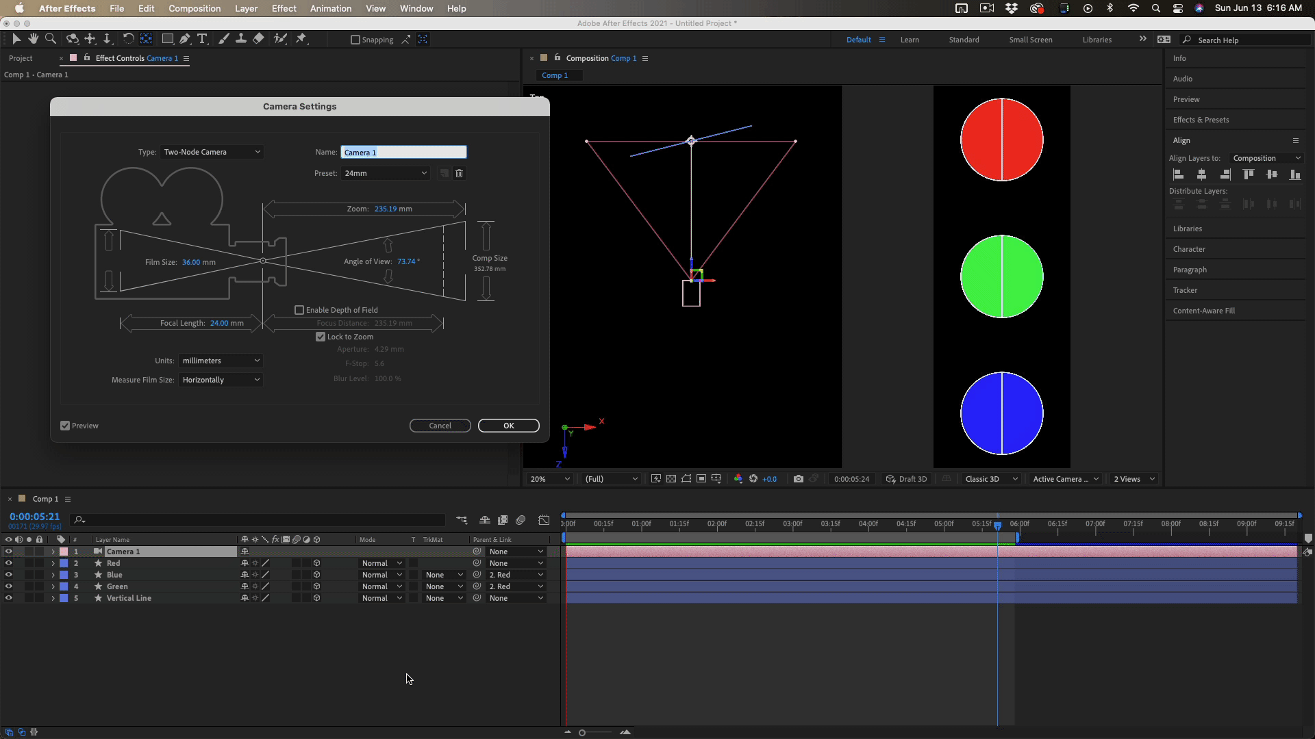

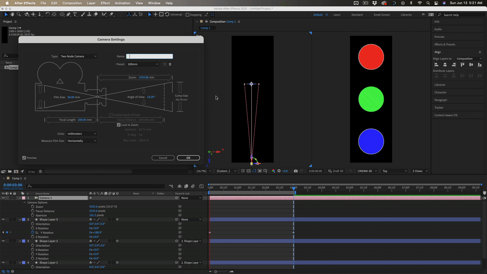

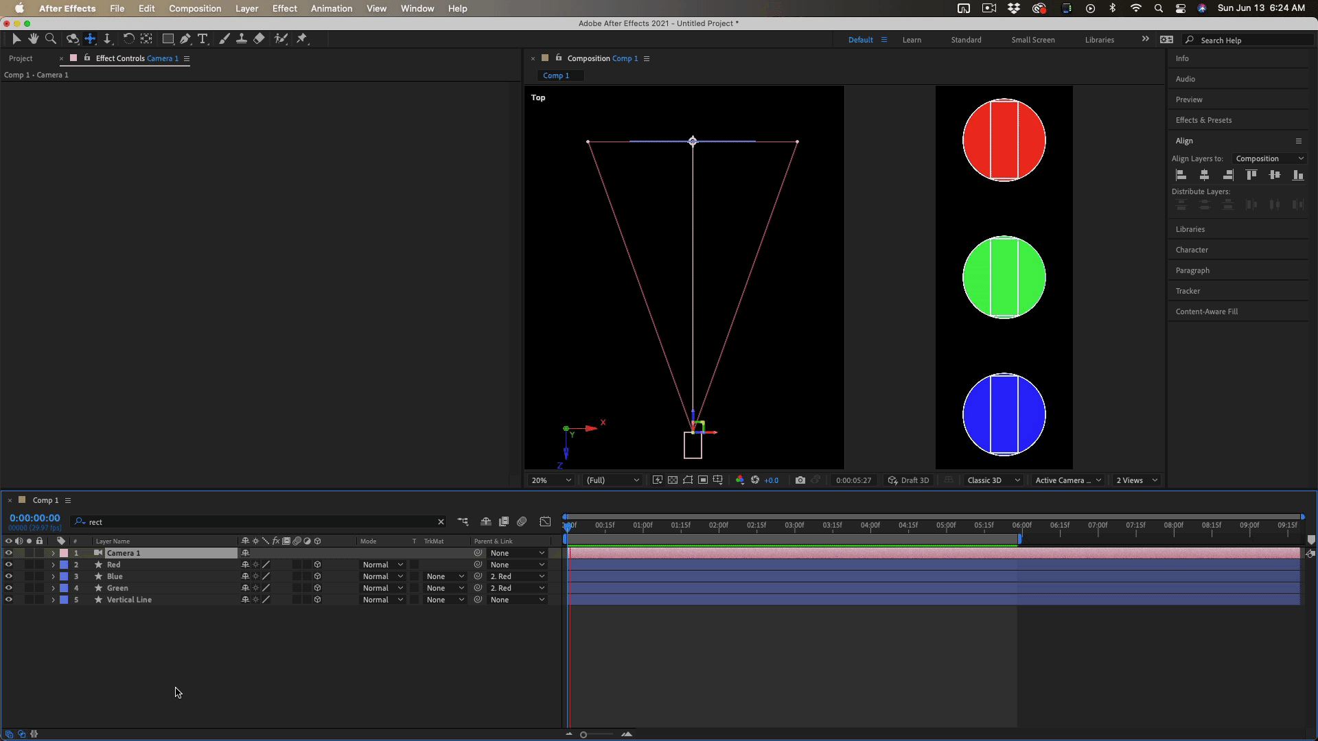

What you are seeing is parallax, not antialiasing limits. Perspective is controlled by the position of the camera. Framing is determined by focal length. Add a camera to the scene with a long lens (200mm) and the distortion of the circles is minimized.
Move the camera close to the 3 layers and adjust the focal length to frame up the same shot and you get a lot of distortion, but if you add a vertical line down the middle of each circle and you add a centered reference line you can see that the Y-axis is still lined up perfectly.
It is the change in perspective caused by the position of the camera that is making your circles look like they are tilting. Put a vertical pattern in the circle and a circle and use a normal lens (50mm) and the circles will not look like they are wobbling on the X-axis.

You are just seeing parallax. Add a camera with a 200MM lens or even longer to the comp and the parallax shift will be reduced. The shorter the closer the camera is to the subject the more distorted the close edge. Change the circle to a square, or better yet, put a square around the circle and you can more easily see that the rotation is exactly around the Y axis.
Mylenium
