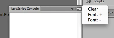

Is there a way to clear the Extendscript Toolkit console from the script running?
Thanks!
Correct answer David Torno
I'm wondering if there is some way to clear the console from within a running script.
Ah, that would be a no. ExtendScript Toolkit is not a scriptable app.

found few lines code about ame-scripting, in japanese
http://qiita.com/tags/extendscript
clearing console
var bt = new BridgeTalk();
bt.target = 'estoolkit-4.0';
bt.body = function(){
    app.clc();
    }.toSource()+"()";
bt.send(5);

That's very interesting. Definitely outside the box thinking.

Top right corner of the console window has a "Clear" option.
February 3, 2014
I'm aware of the clear button you mention. I'm wondering if there is some way to clear the console from within a running script.
Thanks anyway!

February 3, 2014
