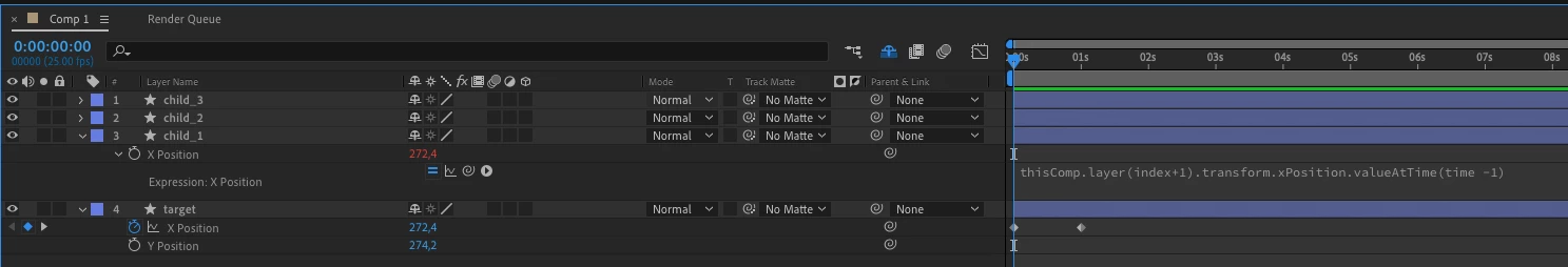

i want to make a really simple clone of a xPosition animation from one layer (Layer A) to another layer (Layer B). Layer B sits somewhere in the timeline, layer A starts at the beginning and has to keyframes starting at 0. I need to clone layer B several times, so it would be handy to change the keframes and timing in layer A and all layers are synced.

I'm not 100% sure what you're trying to achieve. I think you're trying to copy postition parameters to other layers but with a time offset, right?
If yes, you can use the expression
valueAtTime()
1. Create your animation on your target layer.
2. Create the child layer.
3. Create the following expression on the xPosition of the child layer:
thisComp.layer("target").transform.xPosition.valueAtTime(time - 1)
Now those layers take the xPosition of the layer "target" with a time offset of "time-1" = the actual time - 1 second = 1s offset.
If you have multiple layers that should all have a time offset of 1s of the layer below you can write the following expression:
thisComp.layer(index+1).transform.xPosition.valueAtTime(time - 1)
Now the child layer takes the layer below (index+1) and then you can create unfinite layers with the same expressions.
