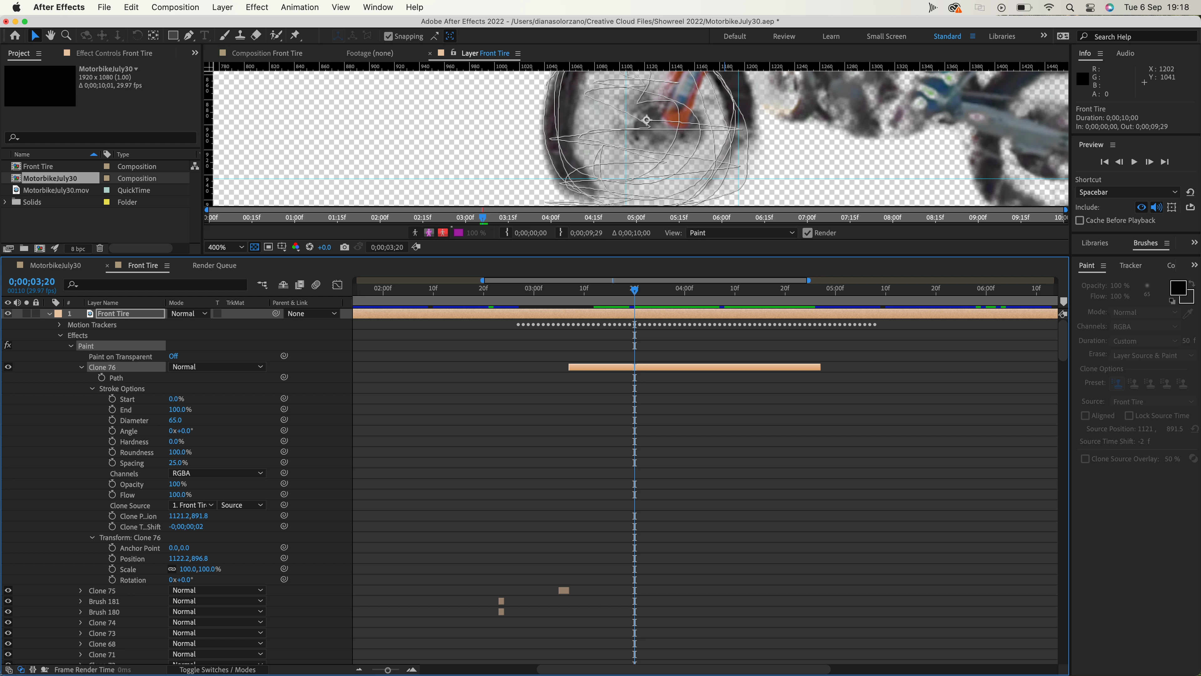

Hi guys, I'm desperatly looking for help!!

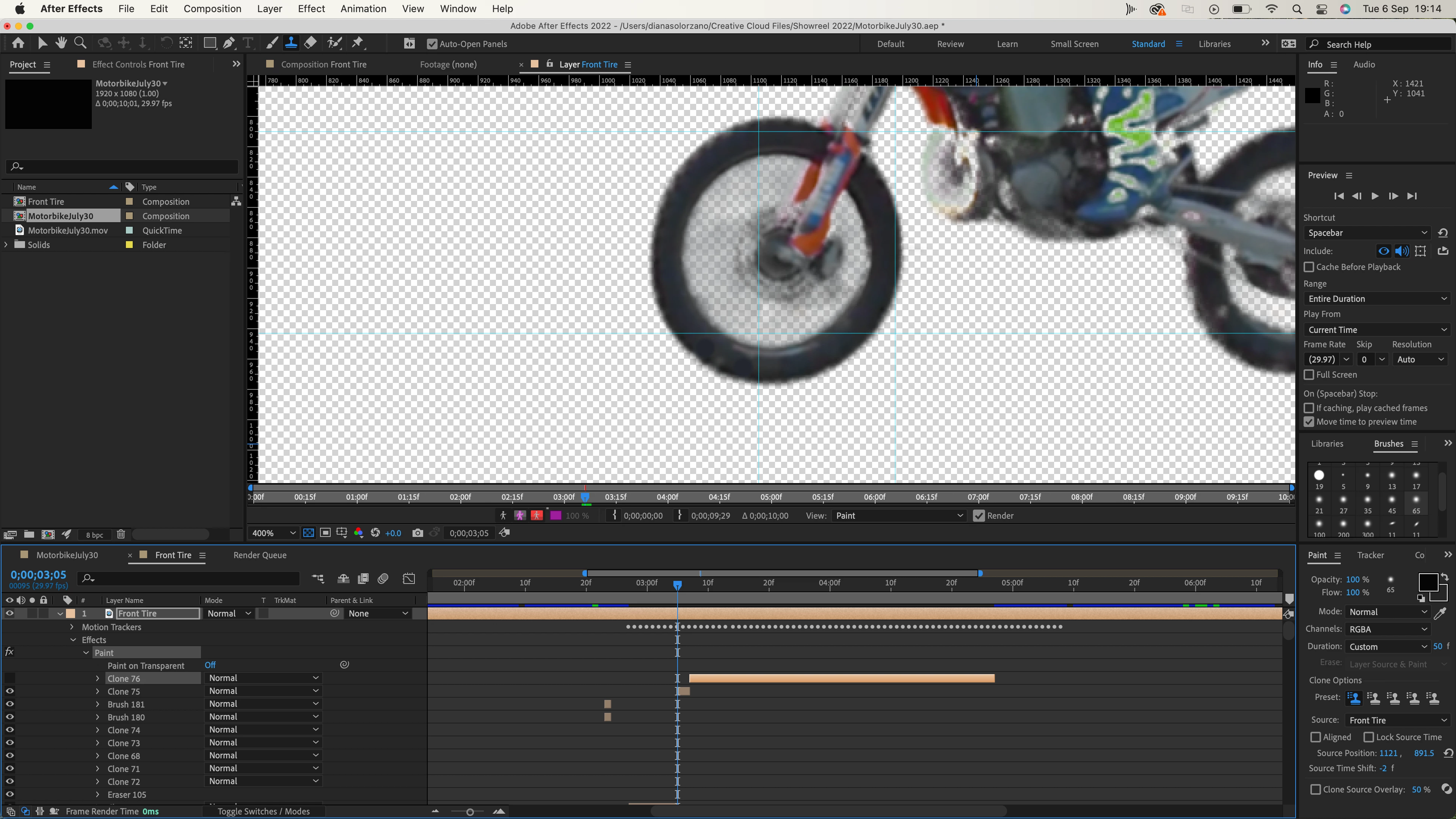

Here is how the original video looks like
This is how it looks when Clone Stamp Tool works

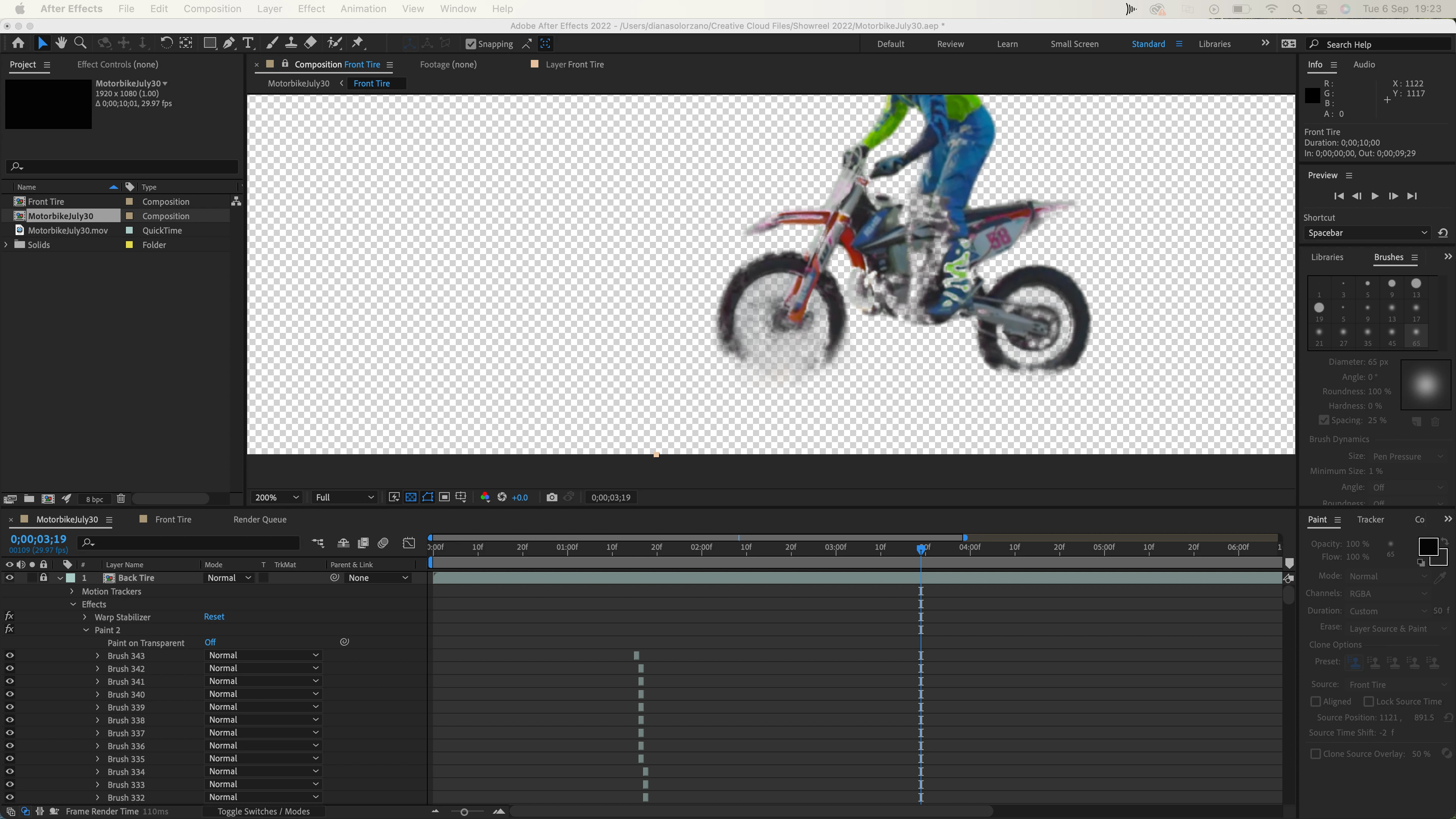

Here is the problem!! Clone Stamp shows the trace but nothing else
This is how it looks like in the main comp when Clone Stamp is showing just only the trace

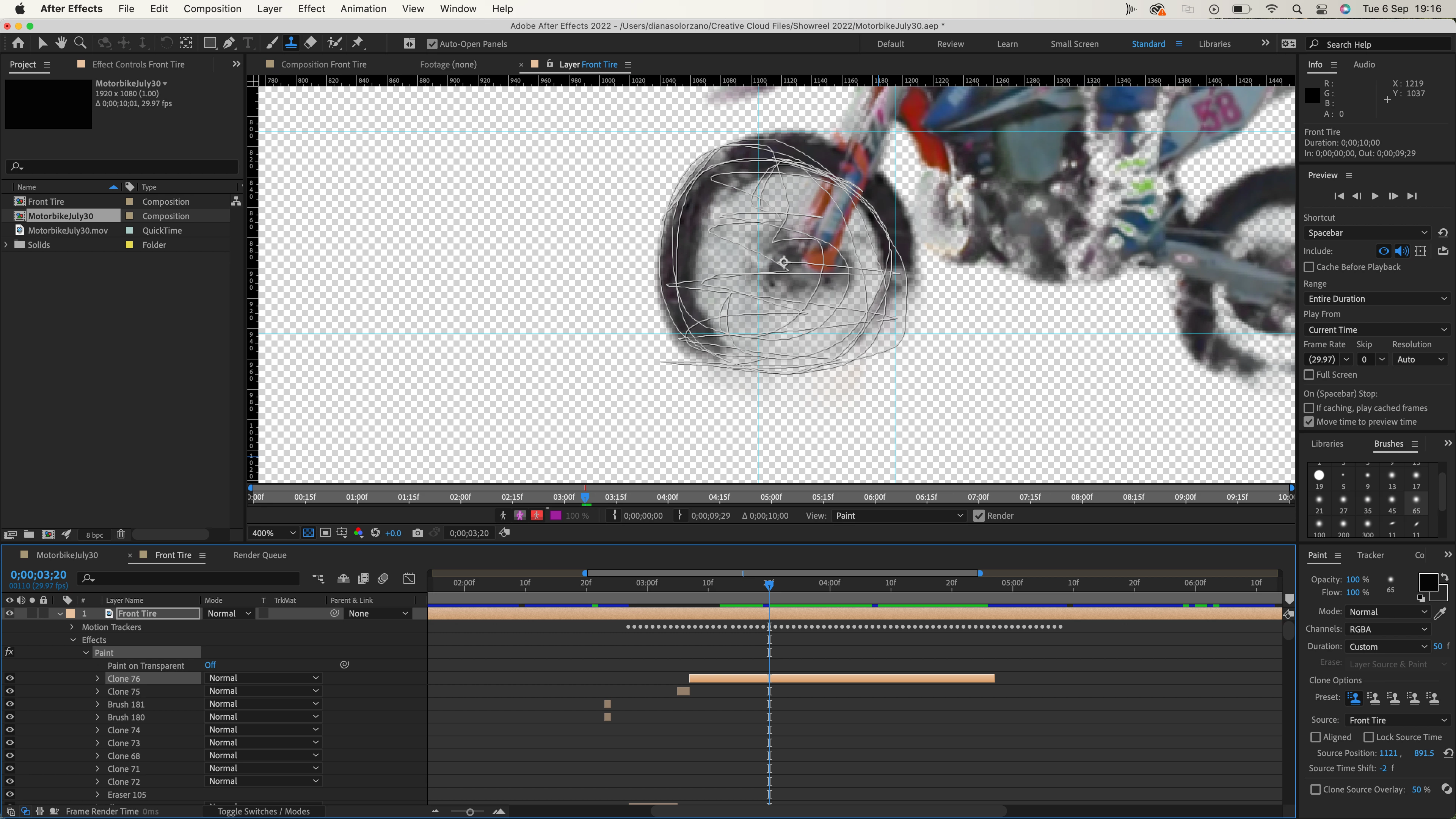

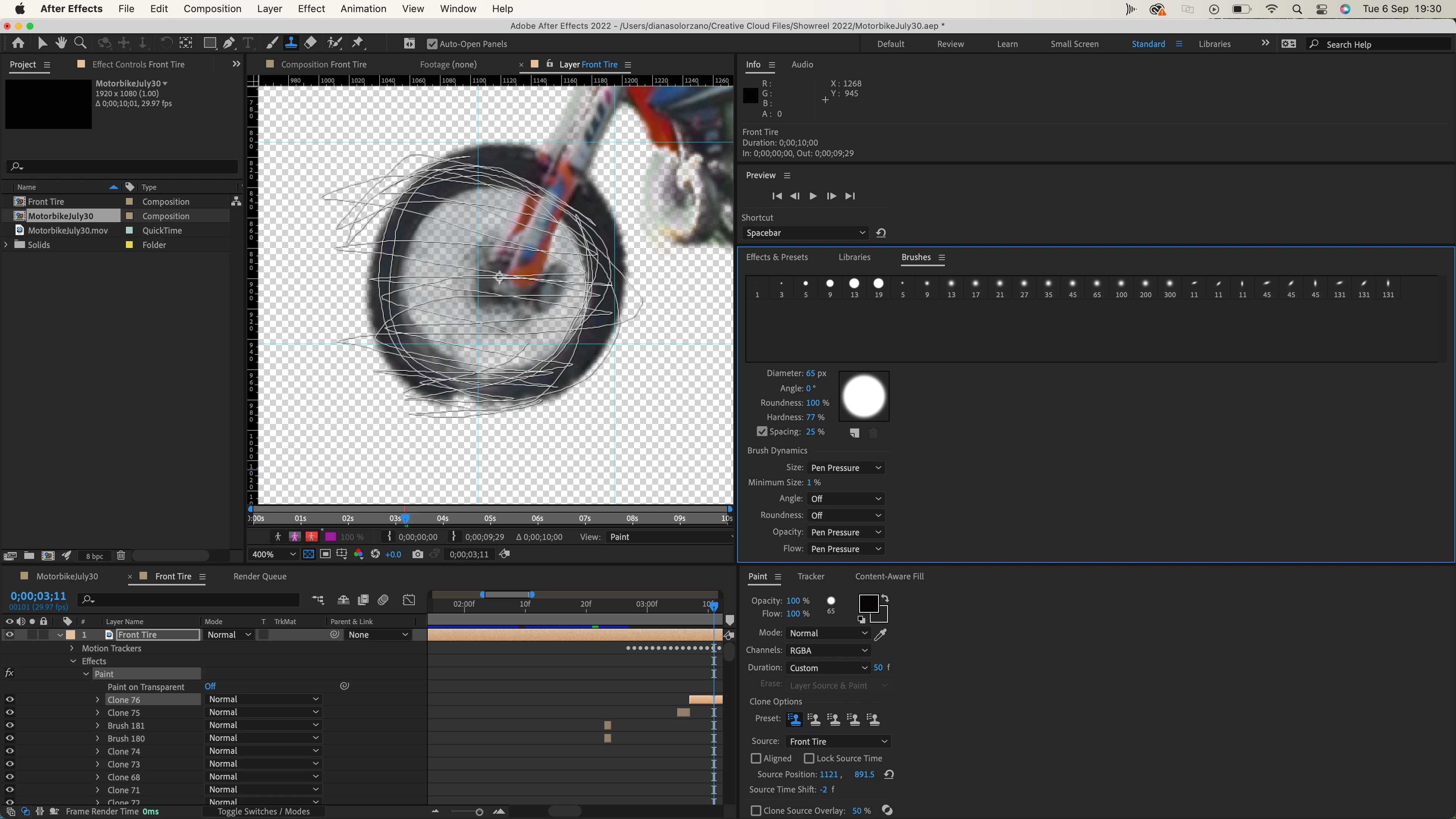

Here are my settings
I've tried things like duplicate clones that have worked previously, I have used different brush settings, played with opacity, updated the software, restarted the laptop, but I still can't figure out what I'm doing wrong? as to why sometimes it works and sometimes it doesn't????

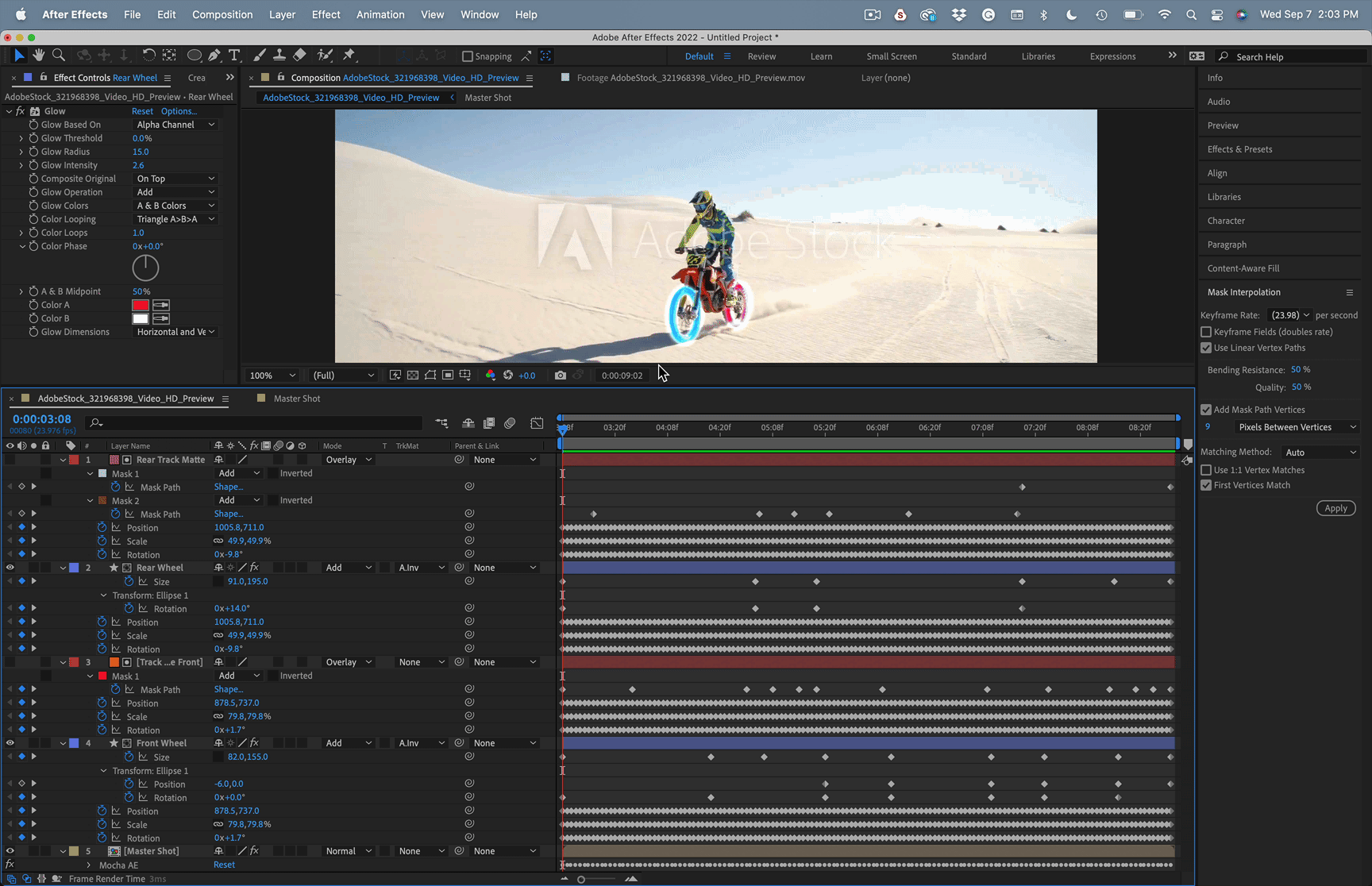

Just for fun, while some shots are rendering, I downloaded some stock footage from Adobe stock, tracked the footage, and replaced the tires with shape layers and a glow. Here is the result of about 20 minutes of work.
If you want to see what I did, I have uploaded the project file, and here's a link to the stock footage: Pro Rider
I only spent a few minutes finalizing the tracks for the Front and Rear wheel in After Effects, so the Perspective was not perfect, but a few keyframes fixed that and the track mattes for the motorcycle.

Your settings show an almost complete tire at 0:03:11 and a time offset of -2 frames for Clone 76. when you expanded the Clone 76 properties at 0:0320, the time offset had no keyframes, so the source is not moving. The clone source is 1122.2, 891.8, so I assume you are using the back wheel as the source. It makes sense because the comp is 1920 X 1080, so that would be about where the rear wheel is, and there appear to be no other pixels in the frame.
The bike's back wheel appears to be moving up and down because the distance between the horizontal guide and the top of the rear wheel changes from screenshot to screenshot.
The problem you are having is that the source location is not animated to follow the movement of the rear wheel.
I'm not sure where the transparency came from, but it looks like it is part of the footage.
