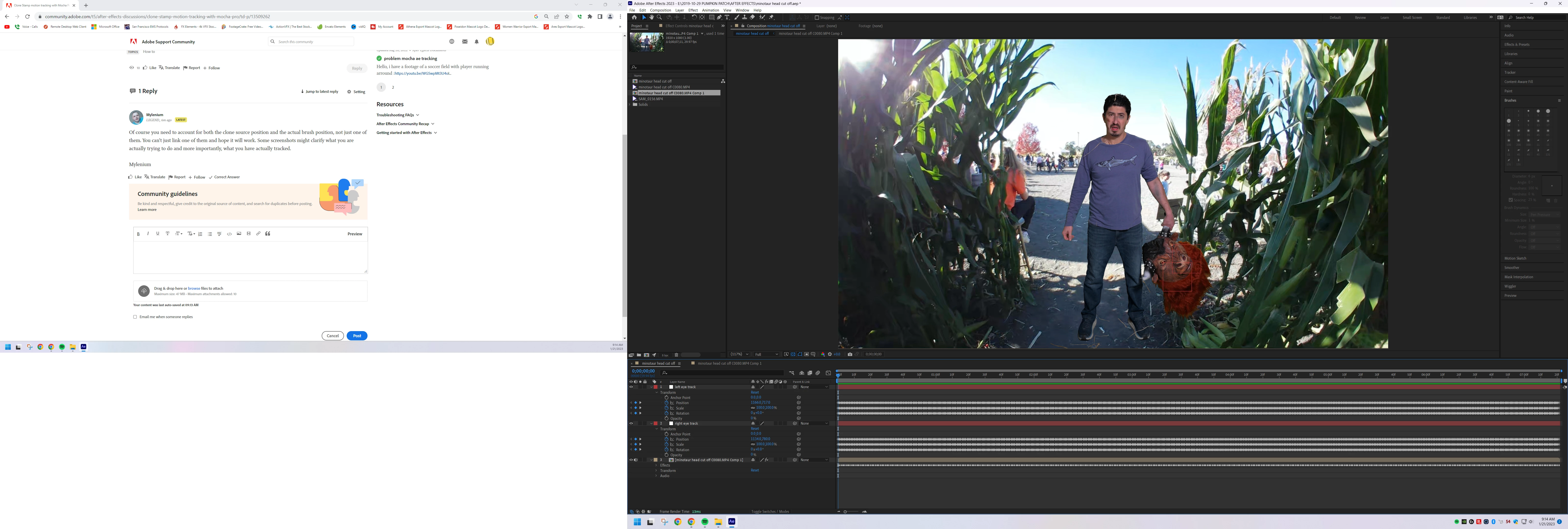

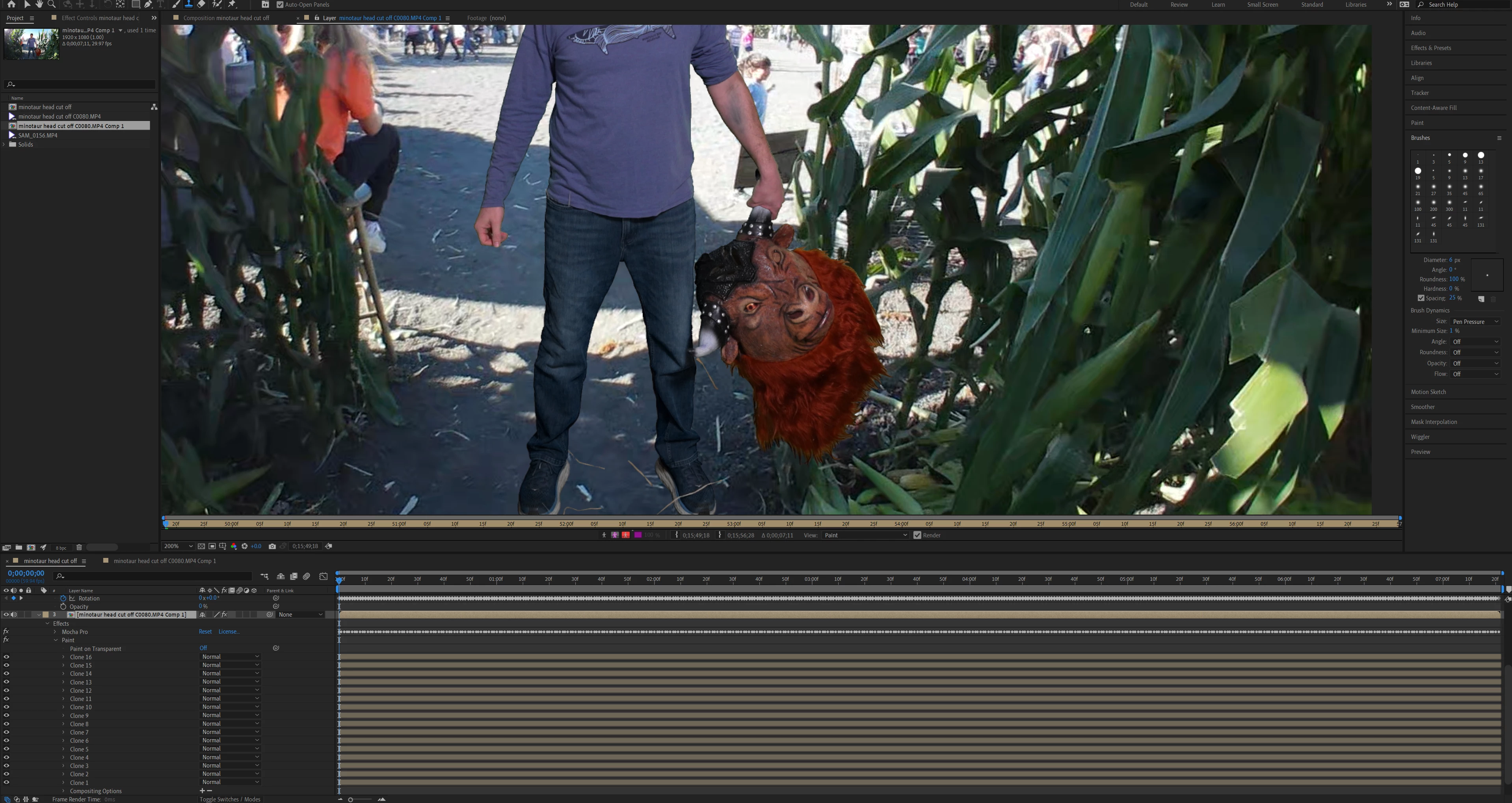

Thanks for responding Mylenium. The info you provided sounds a bit complex to me. I was hoping the clone stamp tool just provided a pixelated layer that I could then link to track data but source position and brush position sound like maybe its more complex. Here is a screen shot of my footage and track. The track data is correct and functioning perfectly.
I am clone stamping the eyes closed and then trying to attach those stamps to my tracking data, is that not the right way to think about it?

January 21, 2023
clone stamps
