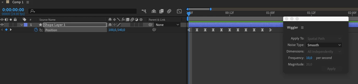

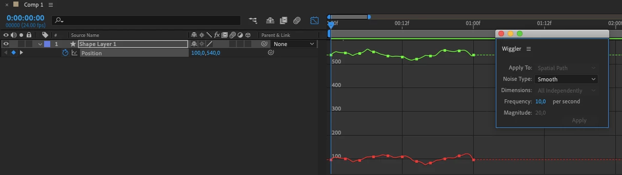

My final goal is to create a script that will have the same functions as the after effects’ builtin wiggler plugin (window - wiggler), but I want to add some more features to it, like storing wiggler’s settings to presets to quickly apply it later.
So to recreate it I am trying to understand the math behind the effect.  The plugin divides every second between 2 keyframes to N(Frequency parameter) time ranges and between each of the ranges the property’s value goes from 0 to up to Magnitude value following some type of sinusoidal path. For example between 2 position keyframes: first is at the 0 seconds and position 100, 540 and the second is at the 1st second and again at position 100, 540; I apply wiggler with freq = 10 and Mag = 20px every frame the values will go:

September 10, 2022
I forget to attach some screenshots to better understand the examples
