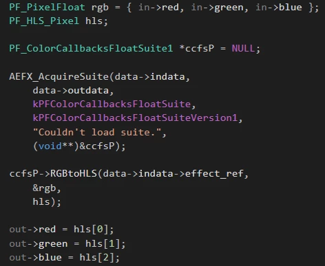

Hi. I'm using the CB suites to try and convert RGB to HLS but I'm sure I'm doing something wrong, as my result looks different to the channel combiner conversion. Here's my code inside an iterateFloat:
It seems wasteful to acquire the suite every pixel, but I tried passing it via the refcon and it had an exception error, probably my fault. Thanks in advance for any info.

You're right in that you shouldn't acquire the suite within an iterate function - this will slow your plugin down a lot! I'm not sure why you're getting an error when using it in the refcon though.
In your header:
// Define struct for refcon, including a pointer to callback suite
struct MyRefconStruct {
     PF_ColorCallbacksFloatSuite1 *ccfsP;
     // Other refcon stuff
In your render function:
MyRefconStruct my_refcon = {};
// Acquire pointer to suite
AEFX_AcquireSuite(..., (void**)&my_refcon.ccfsP)
// Do iterate
// Release suite
AEFX_ReleaseSuite(...);
You could just provide your own RGB to HLS function as a static function (so no suites to acquire). This example would do the trick:
CodeGuru Forums
But you'd need to omit the conversion to r_percent, etc., as it looks like you're already working in float (0-1).
The reason your results look different is that PF_HLS_Pixel is an array of Fixed Point numbers rather than floating point. You'll need to use the FIX_2_FLOAT(X) macro to convert them, so:
out->red = FIX_2_FLOAT(hls[0]);
//etc.

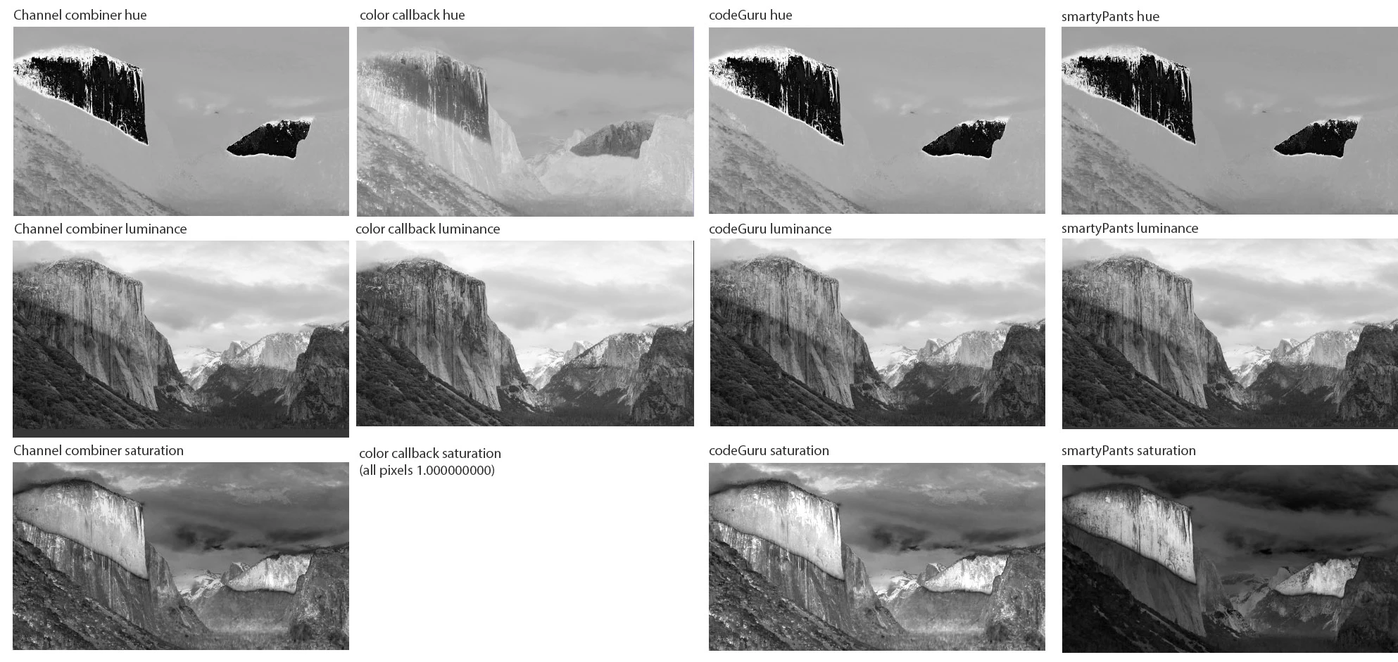

Even after running the HLS values through FIX_2_FLOAT I'm still receiving odd values. The hue channel ranges values from 0 to 100, so I assume that needs to be divided 100 fold but no idea why. The saturation values are all 1.000 so something went wrong there. I did a comparison between channel combiner, color callbacks, the codeguru code and smarty pants here:
I'll keep experimenting to try and get color callbacks to work for me!
January 21, 2017
Looks like the CodeGuru function gives the same results as the channel combiner - isn't that what you want?
Hue is a cyclic value that depending on the range should map 0-360 degrees. Maybe 0 = 0, 1 = 360, or in the case of the callback 0 = 0, 100 = 360.

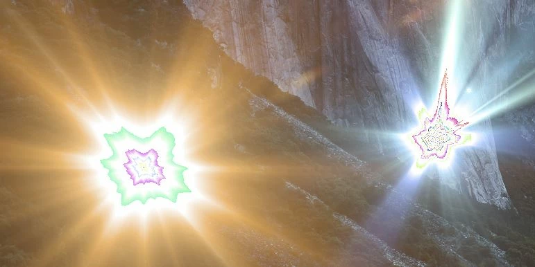

Yes, although I get very glitched results when the values are extremely bright. I'm guessing that most HSL conversion methods don't allow for saturation above 1.0? I tried the code guru and smarty pants methods and got these super psychedelic glitches:
Clamping all values above 2.0 then doing the conversions worked, though I was trying to preserve superbright values.
