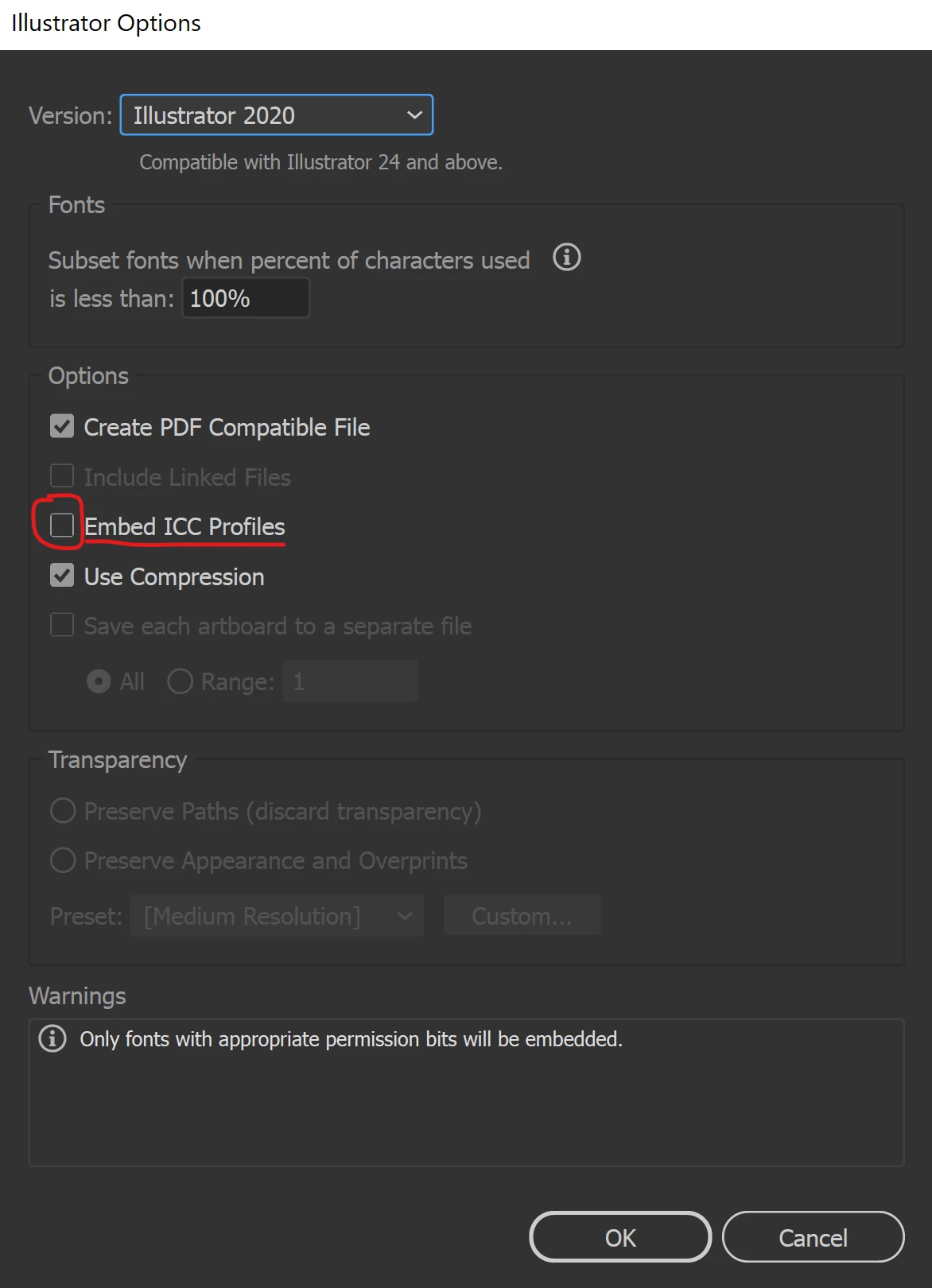

January 18, 2022
It worked for me when I unchecked "Embed ICC Profiles" when saving the AI file.
It seems that there's a bug, because the embedded profile I was using was actually the same one I was using in AE. (sRGB)
Hope this works for the ones out there that couldn't find a solution.

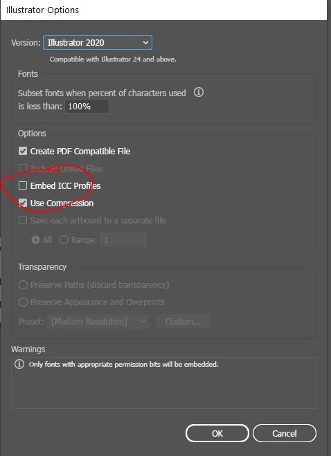

December 13, 2021
Same exact issue, it was driving me insane! I went in my save as option for illustrator and unchecked "Embed ICC Profiles." It finally worked for me! My blacks are true black and not showing as gray anymore. Hope this helps someone.

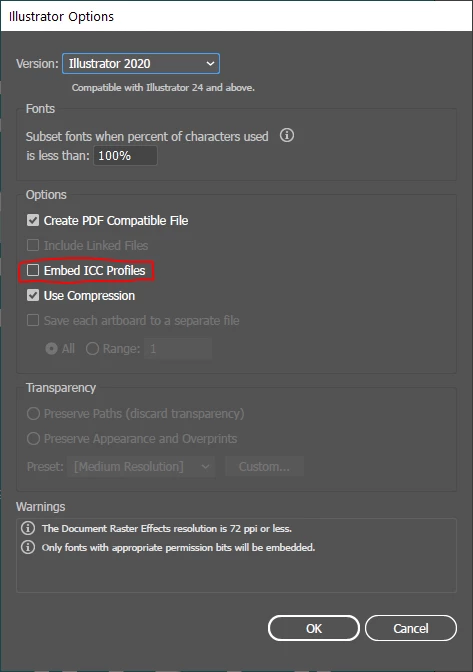

October 29, 2021
I finally found a solution! For me, when you get to the save dialog in your RGB file from Illustrator to .AI, uncheck the box "Embed ICC Profiles". That worked for me. No change in settings in the color management stuff in AE produced any desireable effects.

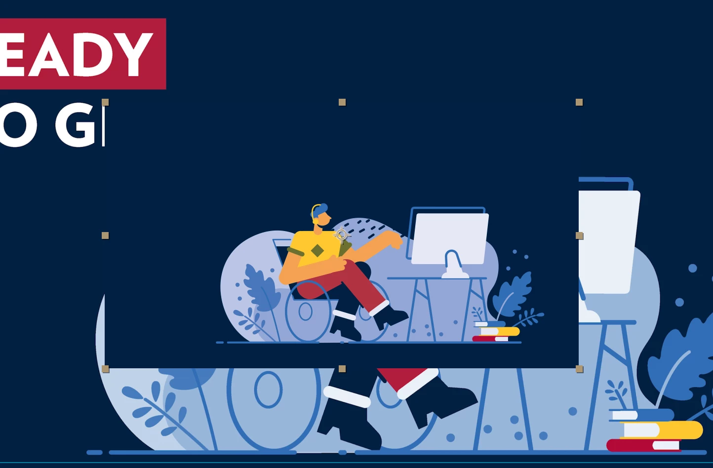

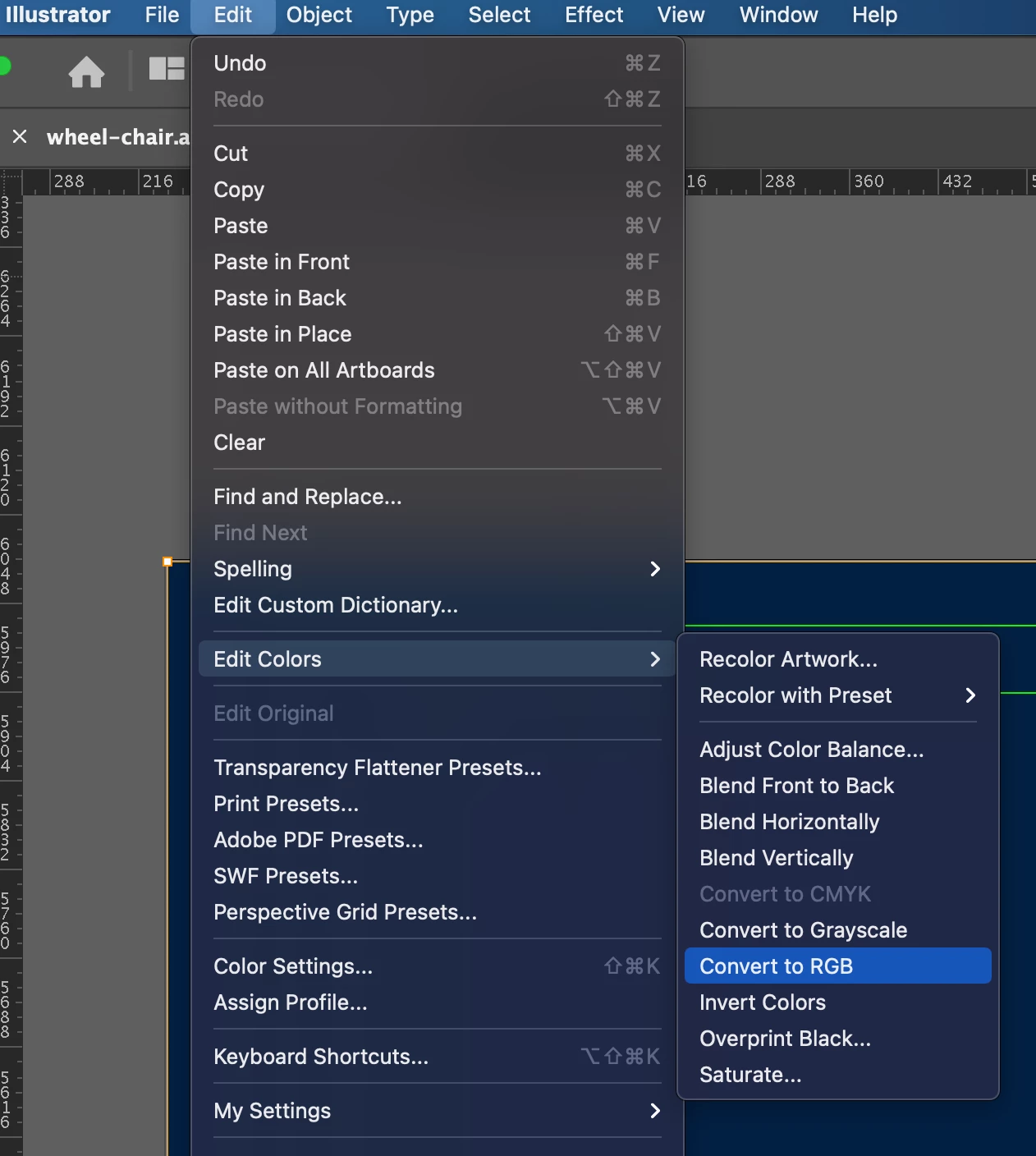

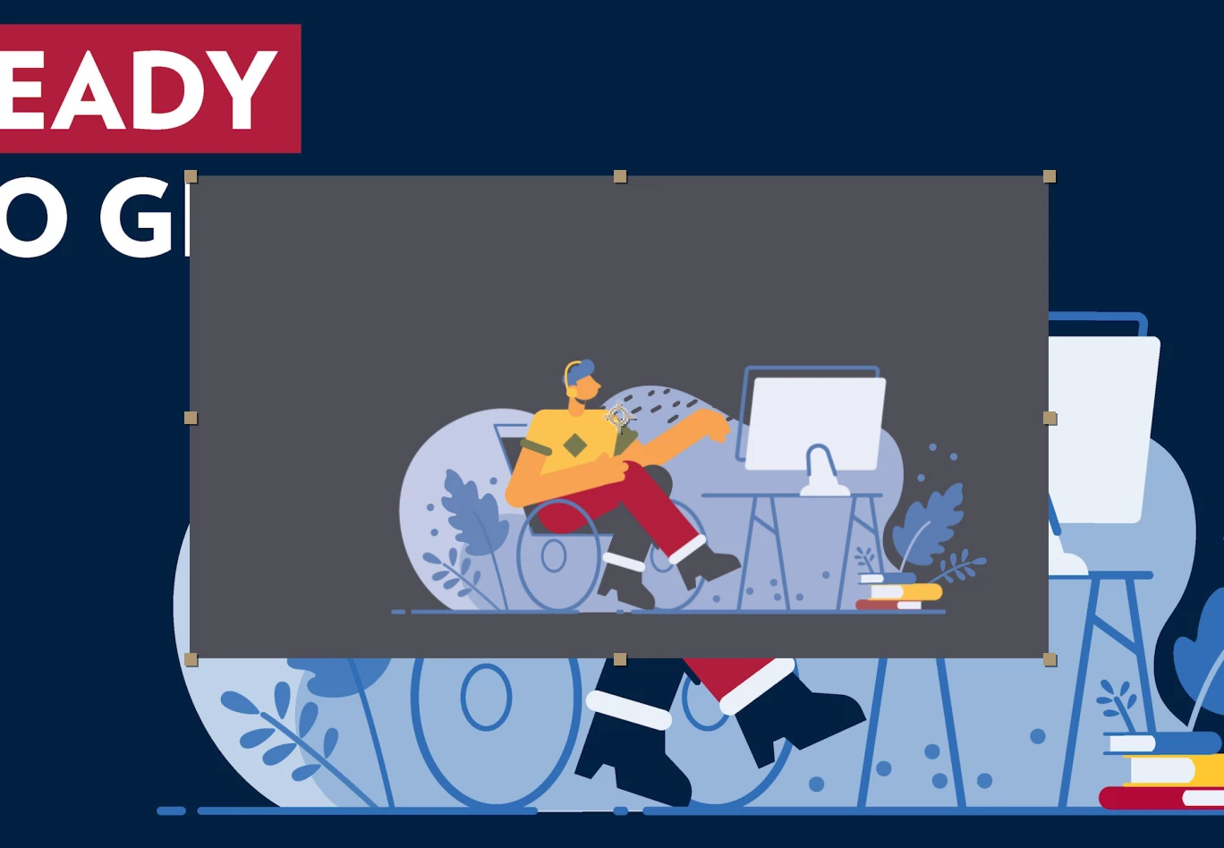

joshs
August 2, 2021
I had this same problem. The 'correct answer' did not fix the problem.
Illustraor/File/DocumentColorMode was already set to RGB.
As was Illustrator/Edit/ColorSettings, the CMYK was set to OFF. I was still importing files with MASSIVE color shift (you can see the blues are GREY.
What fixed this was Select All in Illustrator. Then going to Illustrator/Edit/EditColors/Convert To RGB
It didn't fix it entirely (you can still see slight color difference), but it's closer than it was--like 90%. If anyone has any idea how to get me the last 10%, i'd love to hear it.
