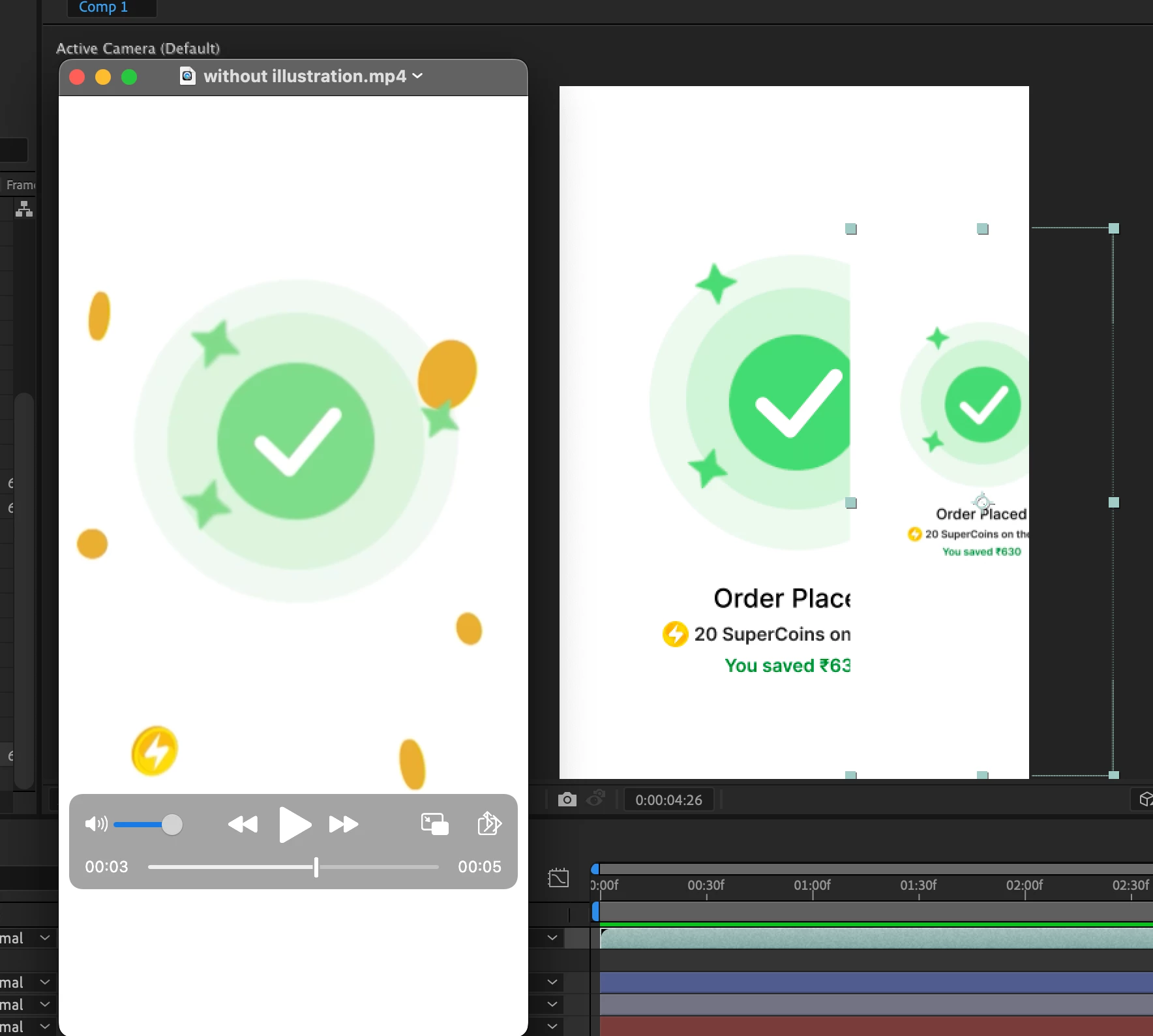

So i tried so many opton but the final out put was the same. Color contrast and hue is getting changed after rendering. The left side is the rndered video and the right side is the workspace of ae

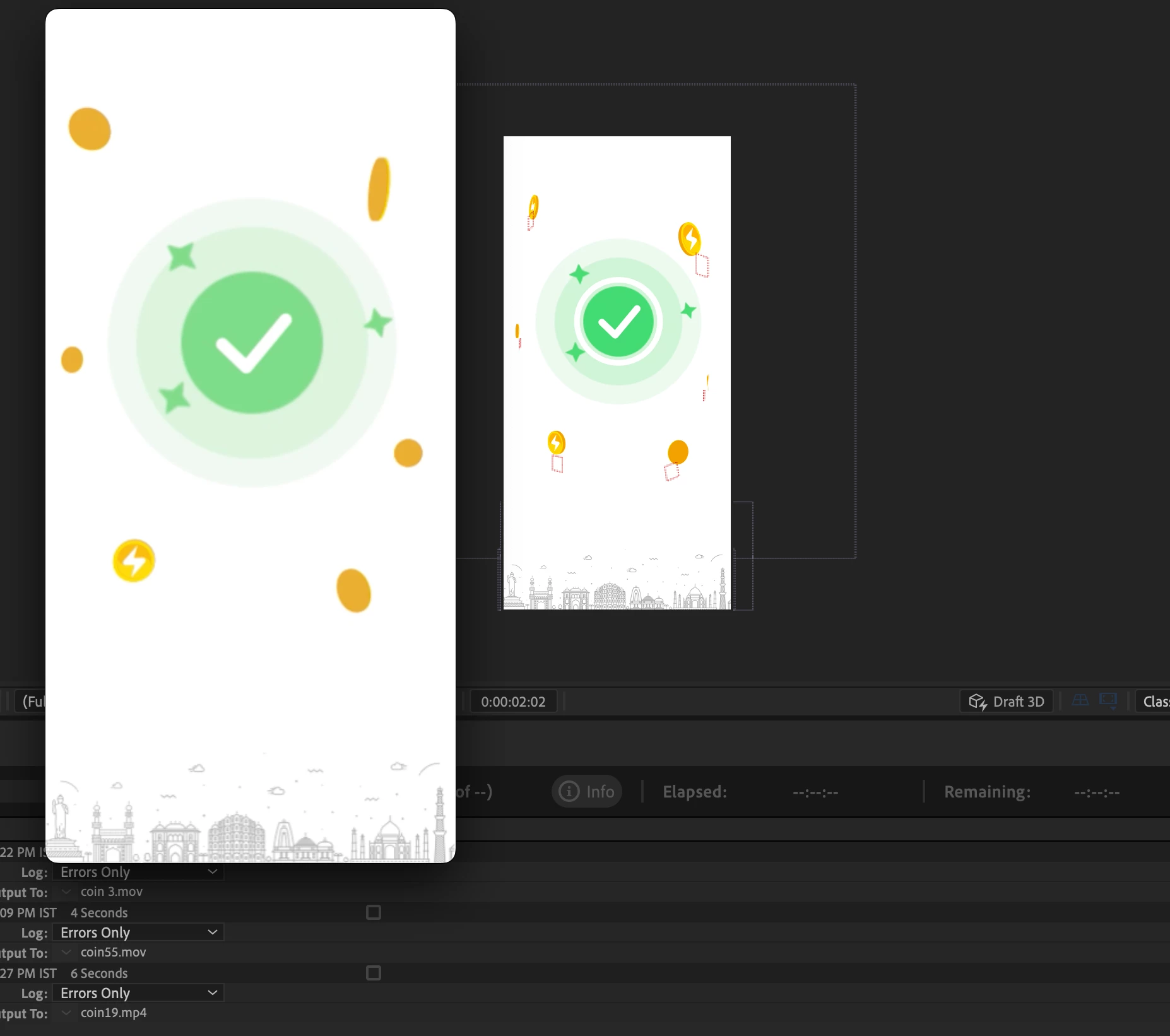

I am rendering the videos using media encoder and the output settings are h.264 , vbr pass 1, and the size i want, needs to be below 2 mb.  So here is the image , the 1st one is quicktime player , 2nd is the work space and 3rd is the rendered video in the workspace

thank you for the Screenshots. Looks like the colors just "seem to be wrong" in the output, because when you put it back to AE, it looks like the same colors, doesn't it? Colors in AE sometimes look very crispy and I'm also a bit coinfused sometimes that it looks washed out in the output format. Still, in my experience, the colors usually look ok again once the video is fed into another program.
What you show there looks like some kind of splash or achievement screen for an app or game. Is that right? For this, it would probably be advisable to output the animation as a Lottie or PNG sequence anyway. Have you tried that?
