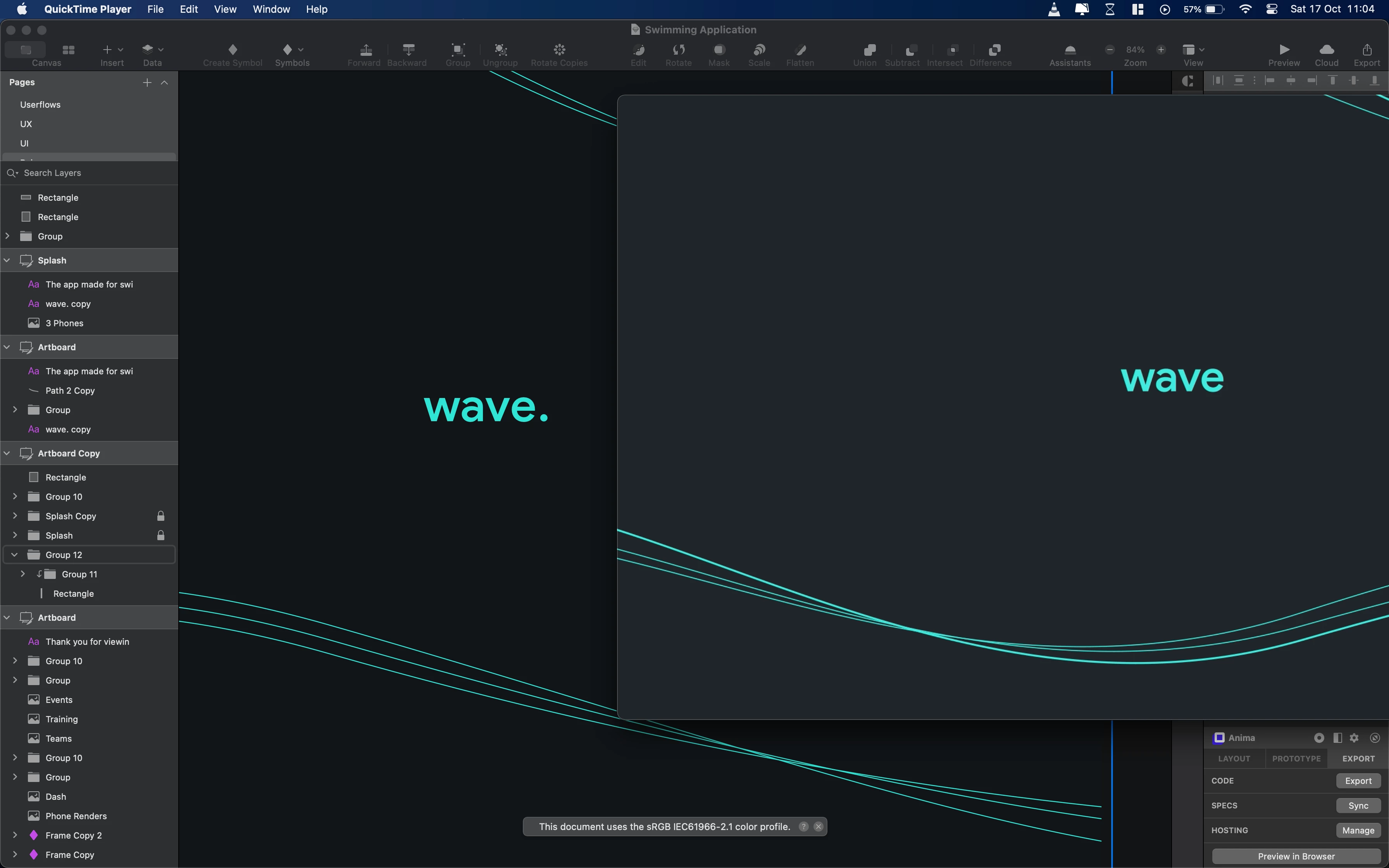

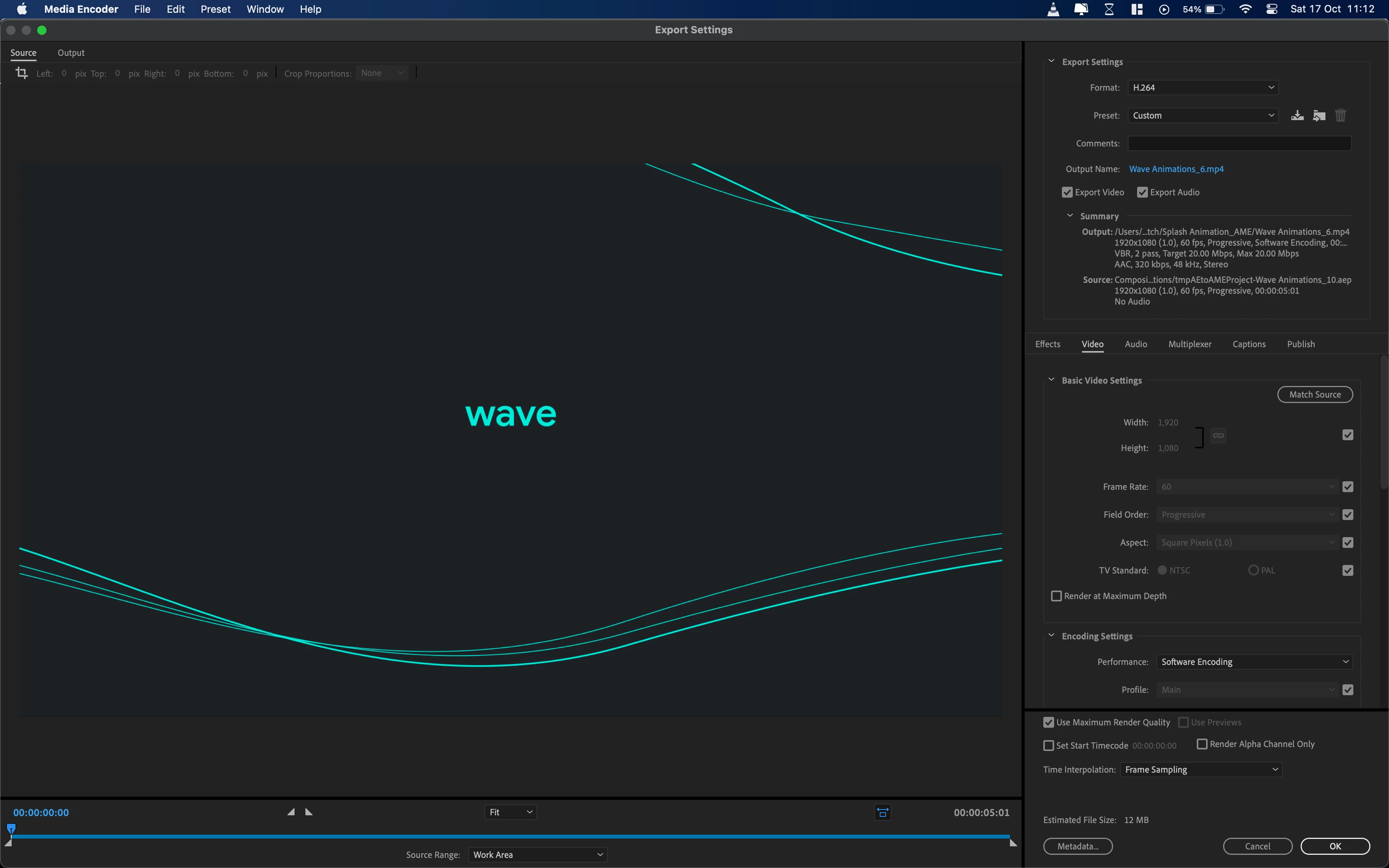

Hi! So I have been working on a very simple animation for a UI design project to post in Behance, happy with the animation but when I export this there is a color change. I am using Media Encoder to export the file and have attached the settings below. It is as if in the process of getting over the Media Encoder there is a colour change as even in the screenshot settings below the color is incorrect.
I use Sketch App to create my UI designs and I then used AEUX to get those elements into After Effects. The colors are correct in After Effects but it seems to just be the export. I have attached a comparison left being Sketch and the desired color / Right being the rendered out mp4 files.
Really hope someone can help has been giving me a real headache and I have exhausted all solutions I can think of!
