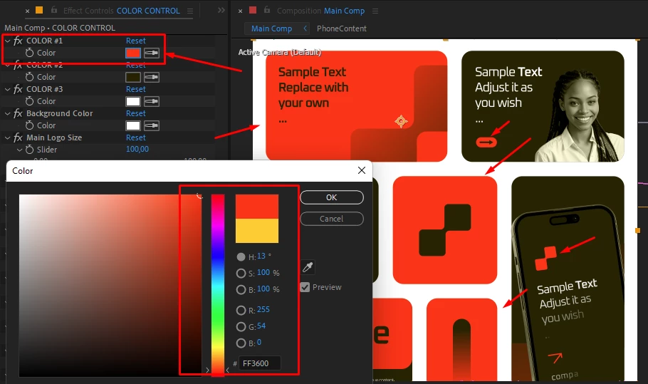

So I've made a template in After Effects for graphic designers like me where people can update the vector file in Illustrator which updates everything in Ae..
But I ran into a problem with compatibility, even tho' most people can open the template without any problems, there are few that have issues with changing the global colors which are controlled with main Adjustment layer.. Weird thing is that most other things are working just fine, but it seems that the expression that controls the colors is broken when the file is converted to their version of Ae.

Here is the template if you want to try it out.
https://wetransfer.com/downloads/da851cb348af7cf892705c3011627c2020240428131330/0174c8
But basically I've made an adjustment layer, added a color controller to it, and connected all the Fills with a 'whip'..
That should create an expression automatically and it's working for most people, but for others it's not.
I will attach the image to explain how it works
