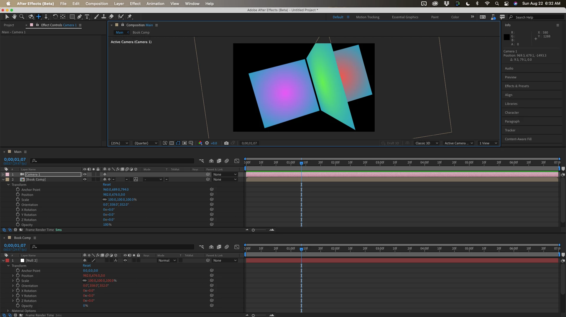

The fix is to add a null to the Book Comp, then tie the Position, Orientation, Rotation for X, Y, and Z, and the Scale of the null to the same properties on the book layer in your main comp. It's pretty easy to do if you separate the comp panels like this:
You don't even have to use the Pickwhip. Just drag a selection around the nested Book Comp's Position, Scale, Orientation, Rotation X, Y, and Z properties and press Alt/Option + Ctrl/Cmnd + C or use the Edit/Copy with Property Links menu and then select the Null and Paste.
The only problem you have with this workflow happens if you need to do some more animating on the 3D layers in the nested comp because they could end up way out of position and even out of the comp frame. The fix is to temporarily reset the position of the nested comp (the book) comp in the main comp to comp center. You can do that by leaving the Camera Track solid (I never use nulls because you can't see them so it is hard to check the accuracy of the track) as a guide layer, then temporarily Shift + Parenting the reset Book comp layer to the Camera Track solid to move the layer back into position.

I started tinkering with adding nulls just before you posted this, and I think I am getting some traction with my issue by using them. You confirming this suspicion helps me tremendously! I see what you are describing with the position being all over the place. I WAS still animating a 3D layer, so it definitely keeps throwing a wrench in the works. I will finish the animation, recenter the book in the main comp and keep at it. I appreciate you providing a screenshot of your panels, that will help me work between comps a LOT more effectively. Brain aneurism is subsiding.... Damn you Creepshow for giving me this idea in the first place!!!
