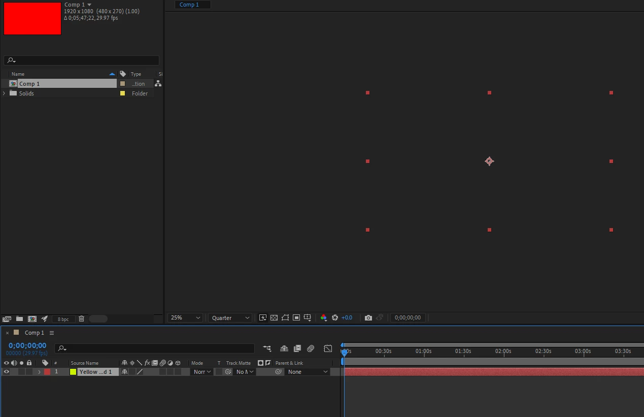

New comp 1920x1080, with a red solid, no FX it looks like this:

Same here:
Competition with red background and a yellow solid layer still shows a grey screen only. Tried adding text and it also shows same gray color with selection dots.
Working fine with old project,

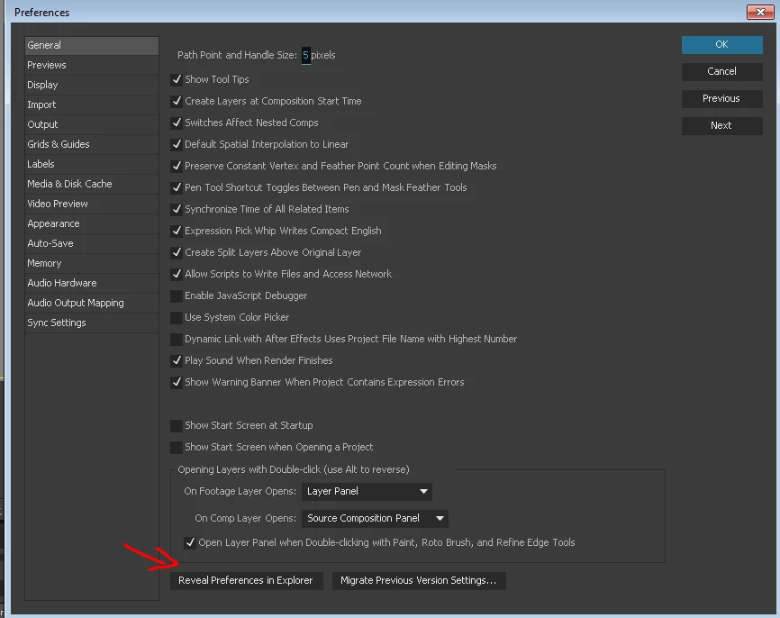

2. try resetting your Ae preferences upon launching:  http://blogs.adobe.com/kevinmonahan/2013/10/15/reset-after-effects-preferences/

about resetting your preferences, you could just renaming the file "Adobe After Effects 14 Prefs.txt"
to  "Adobe After Effects 14 Prefs.old". you can find it when you open the preferences folder

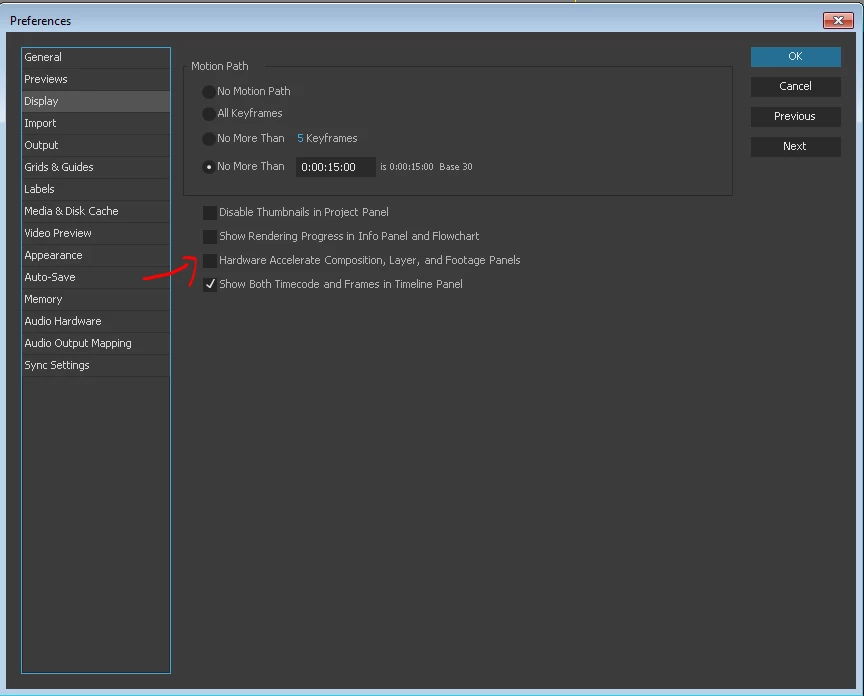

I suspect this is a GPU driver issue. try to check off the hardware acceleration under display
