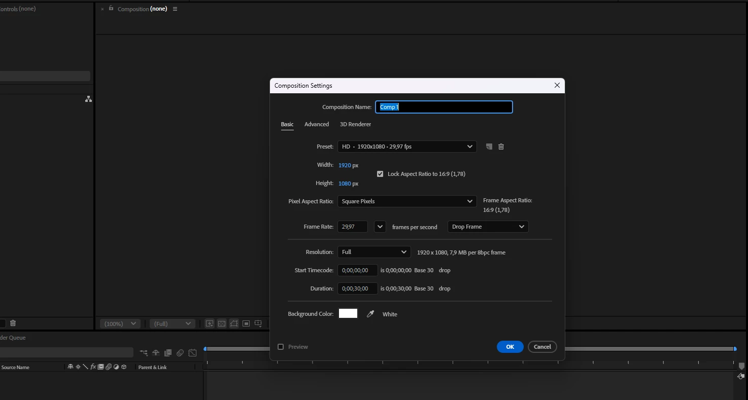

When I start After Effects with a new project and I create a new composition with a white background:

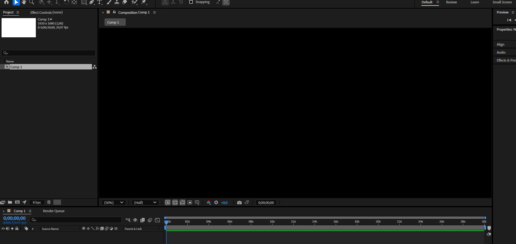

I get the following result:
Even with a white solid layer:

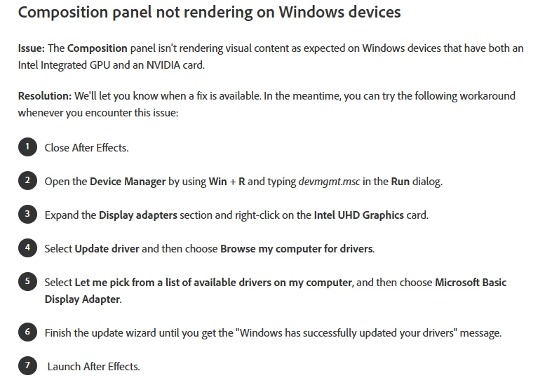

It looks to me that I encounter this known issue: Known issues in After Effects
The resolution do works for me but it feels like I'm not using the full potentiol of my system then.
Is there any update about this known issue? I see the last update time of the page is 14 nov. 2024.

You mentioned this is a new PC. Please ensure that the available Windows updates are installed. For testing, try installing an older version of the Nvidia GPU and disconnecting the secondary monitor. It looks like a driver issue to me.

Thanks for writing in, Dennis. Glad to hear that the workaround works for you. As far as I understand, your Nvidia GPU is more capable than the integrated GPU, so most programs would use your dedicated GPU.
This issue is related to the Intel GPU driver. The After Effects product team is actively working on fixing it.
Hope it helps. Feel free to reach out if there are any other questions.
Nishu

That changes the story. The bug is with the Intel GPU driver. If disabling the Nvidia GPU is solving the problem, then it's not the known issue you're hitting. Try installing the latest Nvidia GPU Studio Driver from their website. If you get the same issue, then try changing the driver of the Intel GPU as suggested in the known issues article.
Let me know the outcome.
