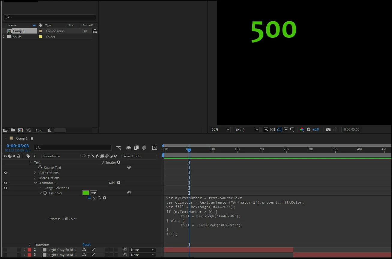

ShiveringCactus
Oct 19, 2022 11:00 AM UTC
I didn't bother creating a CSV to test this, but based on the value of the source text, I think this changes as you want:
var myTextNumber = text.sourceText
var ogcolour = text.animator("Animator 1").property.fillColor;
var fill = hexToRgb('#44C206');
if (myTextNumber > 0) {
} else {
	fill =  hexToRgb('#C20621');
fill;
 I used the Fill animator and added this expression to it.  It gives me an extra colour which I could have substituted for one of your hex codes.
I think I've spelled everything out, it probably could be written more efficiently, but basically:
  • Take the value of the text
  • create variables for the original colour and a fill value
  • If the text is more than 0, use the #44c206 colour value
  • else use the other colour #c20621
  • Tell After Effects which variable to use
the_starship
Oct 19, 2022 2:27 PM UTC
Thank you so much. I was able to add a Fill option on the essentail graphics and use that. It now works as intended. Thanks Again!
