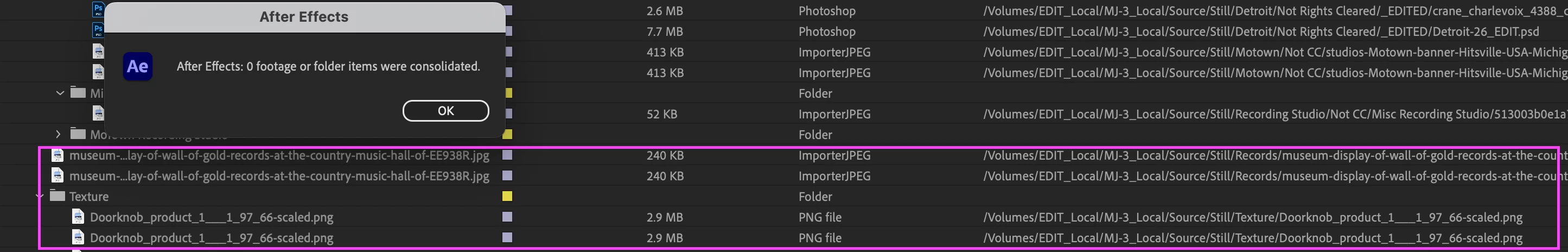

Consolidate all footage has stopped working for me; I noticed it wouldn't consolidate layers of photoshop files a year or so ago, but now doesn't seem to work at all. I'm on Mac OS 12.4, Ae 23.5.0
See this screen shot - I have several instance of the same png - same name, same file path, same everything. Ae will not consolidate them.
