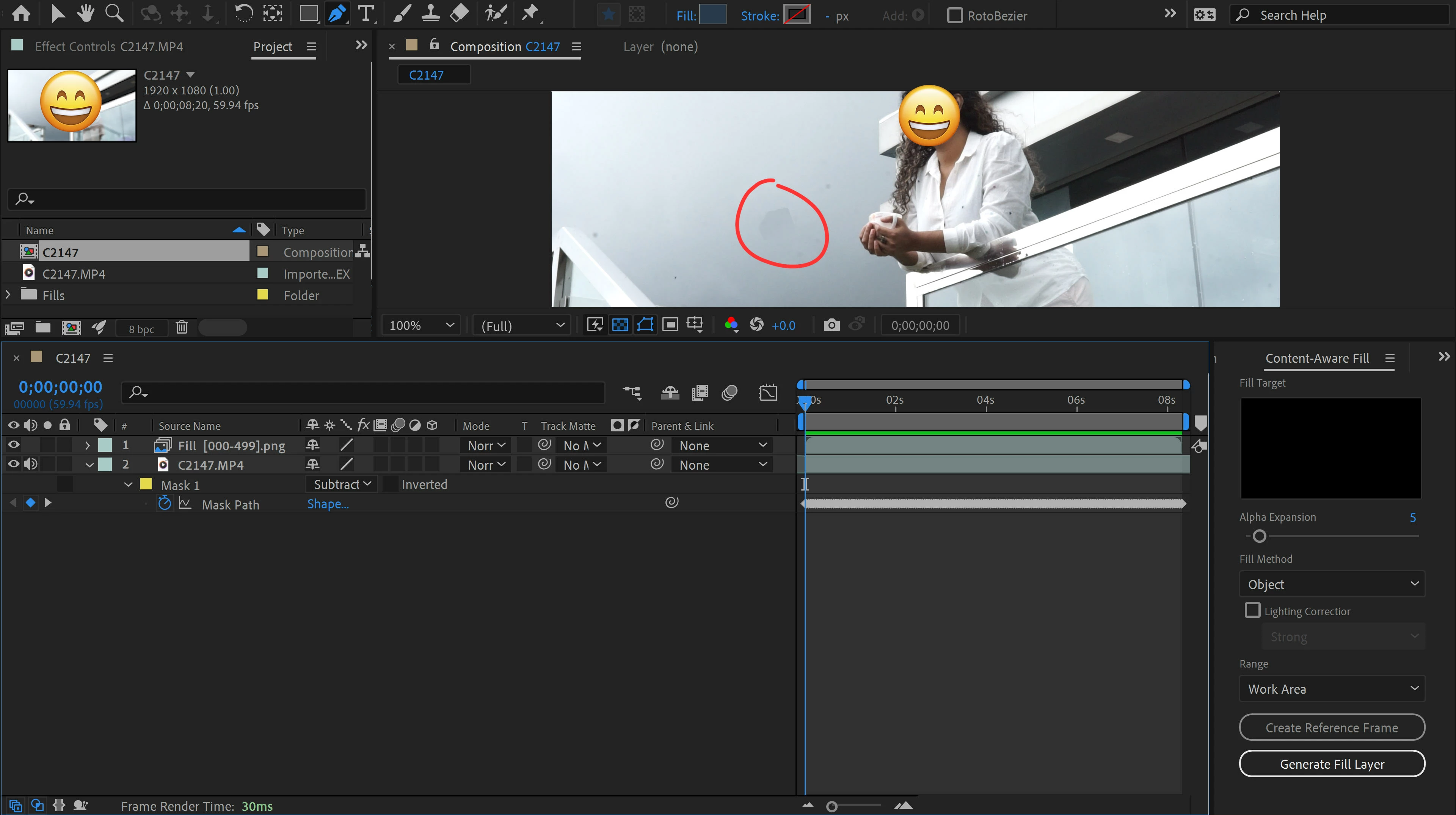

Hi there,
I have a footage with some spots on it (as you can clearly see around the red circle). There was a spot in the place of red circle as well. I needed to remove all the spots. I just tried one at a time. This is how I did it.
  • Created a mask around the spot.
  • Right click the mask and selected "track mask"
  • In the tracker panel, selected "track selected masks forward"
  • Then content-aware fill (you can see the settings in the attached screenshot).
The screenshot attached here displays the ending result (inside the marked red circle). It looks like a badly copy-pasted layer on top of the original frame. Can you guys please help me with this. I just need to get a smooth fill instead of these spots. Thanks bunch.

Hi, you could try masking out the spots so they become "holes" in the footage, feather the masks slightly, then add another layer of the footage underneath and reposition it a few pixels so that the spots disappear. Depending on the movement in the shot you may have to keyframe the position of the lower layer but only if neccessary.
Mylenium

Why wouldn't you just replace the entire background as a whole? Seems simple enough and since the colors are subtle, it doesn't even need to be super exact and just be blended in with rough feathered masks. the only real challenge is reasonably matching the gradient.
Mylenium
