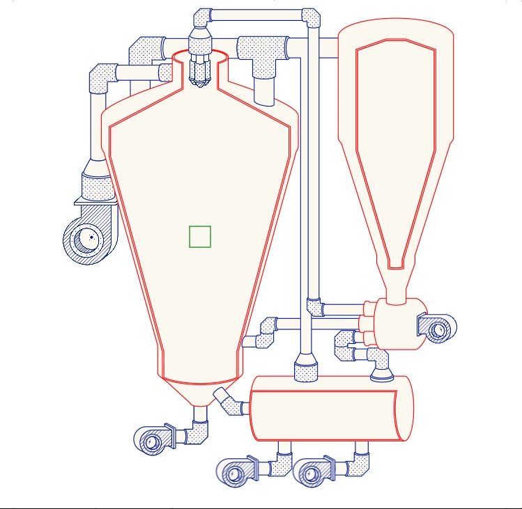

Each of the red outlined components of my design above are separate pre-comps which all have different parts of a technical process happening within them. So I guess that means I need control over the subcomps contained within that main composition I have screen shot?

I feel like it would be easy for me to follow a naming convention if that is the way to do it. I have attached a screen shot of my 'rig'. The red outlined parts are the elements which I have soloed to help my previews. How would I go about controlling those layers with a script?

There's a lot of ways you could go about this, with scripting something like checking if the layer is labeled red and soloing it would work:
