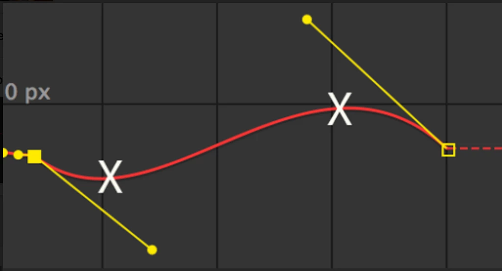

When val1==val2, the trick was to add temporary keyframes at the extreme points of the curves, such as this one:
Correct me if I wrong, but in css for instance, a cubic-bezier the value to be animated needs to be different from from start to end.
