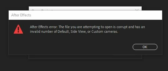

Corrupt file: invalid number of default, Side view or custom cameras.
  • April 18, 2022
  • 1126 views
after effects error: the file you are attempting to open is corrupt and has an invalid number of default, Side view or custom cameras.
Also appears in my autosaves.
Tried to import file into new project. Same issue.
The Main Comp is missing once project opens.

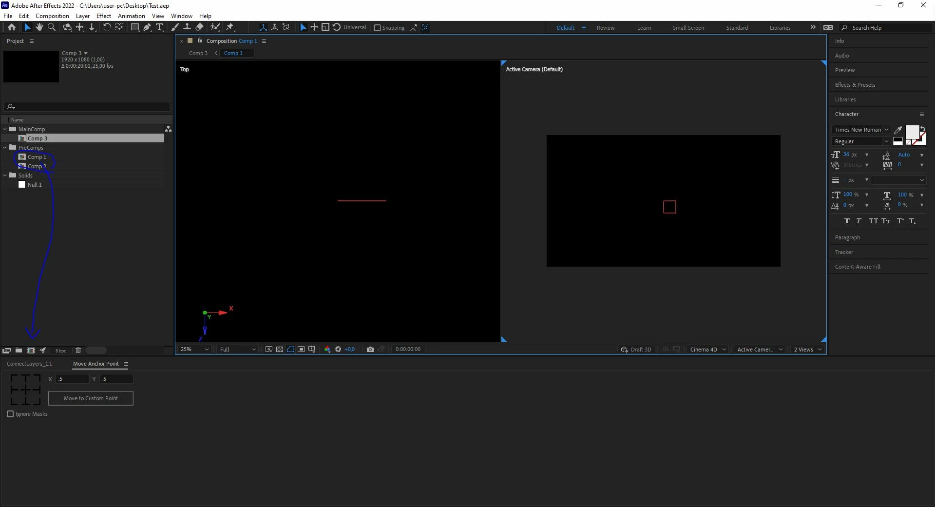

I have managed to recreate the error.
So if I create two comps (Comp1 & Comp2) with a simple null that is 3D to activate the abilty to have 2 view ports of different angles open (Top/Active Camera View), I drag those two comps over the Create New Composition icon to create Comp3 as a Single Composition with a Still Duration of 0:00:00:00. I save the project and close. Then when I try re-open the project I get the error.
I have done this countless times in the past with no issue, other than in the latest version of AE.
Opening old projects gives me the same error where I used this method.
I haven't tried downgrading versions yet to see if the error still appears.
However, if I manually first create Comp3, by not dragging Comp1 and 2 over the Create New Composition icon. Then I drag Comp1 and 2 into Comp3, there are no issues.
I have attached the Test project file and a screen grab to help explain the situation.
