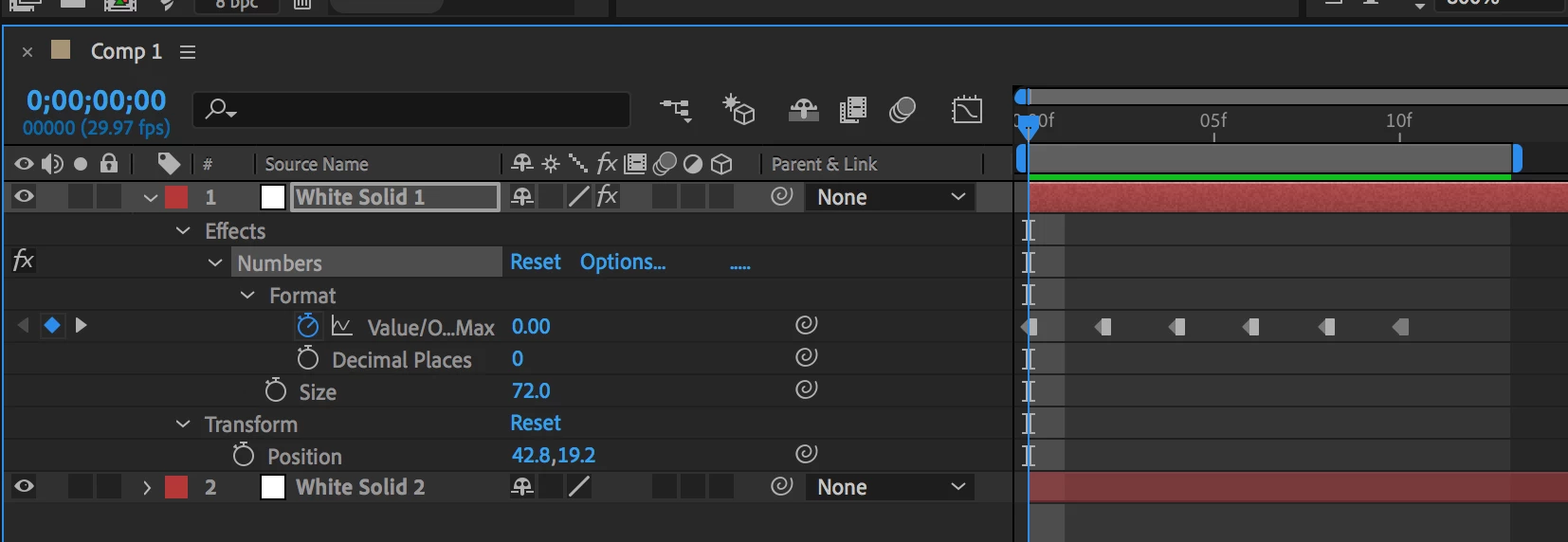

    Single Type Layer, keyframing the Source parameter.
    Or,
    Multiple Type Layers that are two frames long and sequenced without overlap or gaps.
    But probably,
    The Numbers Effect (Effect > Text > Numbers) with the Type set to Number, the Value keyframed with Hold Keyframes and the Decimal Places set to zero.

    Add a keyframe for each whole, even number and then toggle to Hold Keyframe.
    So, 1st keyframe at 0:00:00:00 is "0.00", 2nd keyframe at 0:00:00:02 is "2.00", 3rd keyframe at 0:00:00:04 is "4.00", etc.
