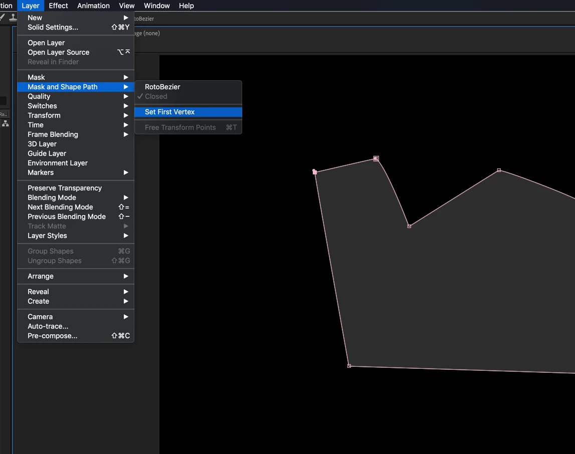

    March 23, 2019
    Set the first vertex using the Layer>Mask and Path>Set first vertex menu
    If you have the pen tool selected (g) and you hold down the Ctrl/Cmnd key you get a white selection arrow. You can drag a selection around the vertex you want to be the first vertex.
    When you animate a mask the vertices always move in a straight line. There is a Mask Interpolation tool that will help you fix some problems but when you closed your mask and added more animation the first vertex probably got changed and the flipping behavior you are experiencing is caused by the change in vertex order. As Mylenium said, don't add extra points, it just causes problems.
    Unfortunately, if setting the first vertex for your mask path to where you originally started drawing the mask does not fix the problem you will have to redo the entire path animation. I would go to the last part of the animation where the path seems to be behaving itself and then delete all previous keyframes and work backward. That might save you some time.
