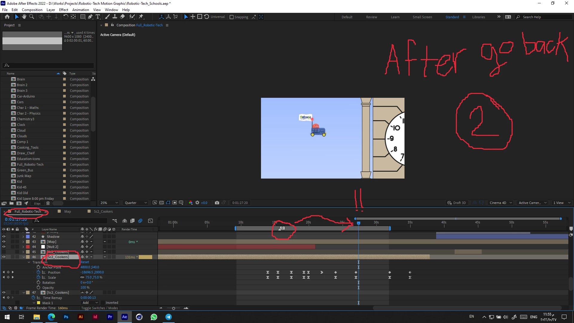

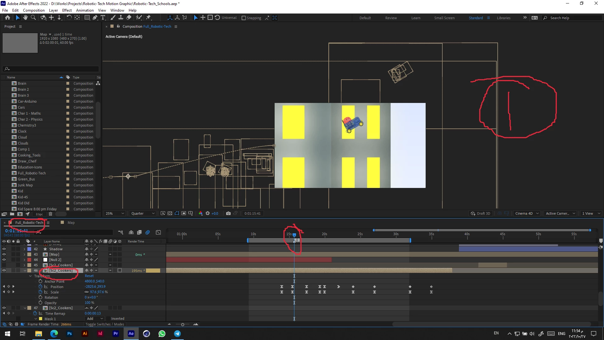

I Have a Main Composition called (Full-Comp) and Sub-Comp called (Scene1) in the main one (Full-comp).
When I double-click on (Scene1) to open it in Timeline, the comp (Scene1) opens originally, but when I Go back to the main Comp (Full-Comp), the problem is that [[(Timeline Cursor) moves many seconds forward (11 seconds and 35 Frames)]]!!!
[Look at 2 images I attach]
And again when I repeat double-click on the same comp and go back again, the timeline cursor goes forward 11 seconds and 35 frames !!! ... etc !!!

Mylenium
October 28, 2022
You surely did! It says so on your own screenshots for layer 47.

Mylenium
October 28, 2022
You have a duplicate time-remapped instance of the same pre-comp below and AE will reference the timing of that.

TimKurkoski
October 27, 2022
Hi @Ousama AlRefai,
This sounds like the result of the Synchornize Time of All Related Items preference, which is on by default. You can disable it in Preferences > General.
More detail on the preference can be found here: https://helpx.adobe.com/after-effects/using/precomposing-nesting-pre-rendering.html#WS725e431141e7ba651172e0812382a1c329-7fff
I have moved your post from the Bugs category to the Discussions category. If you think that this preference is not contributing to your issue, we can continue to investigate and move it back if necessary.
