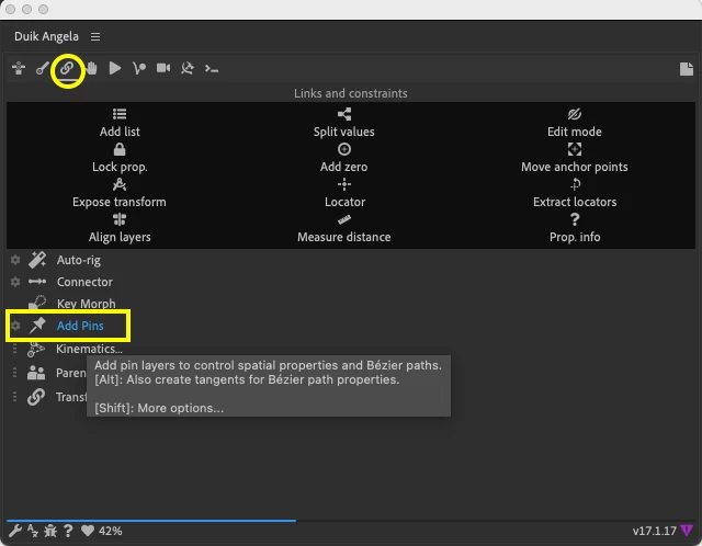

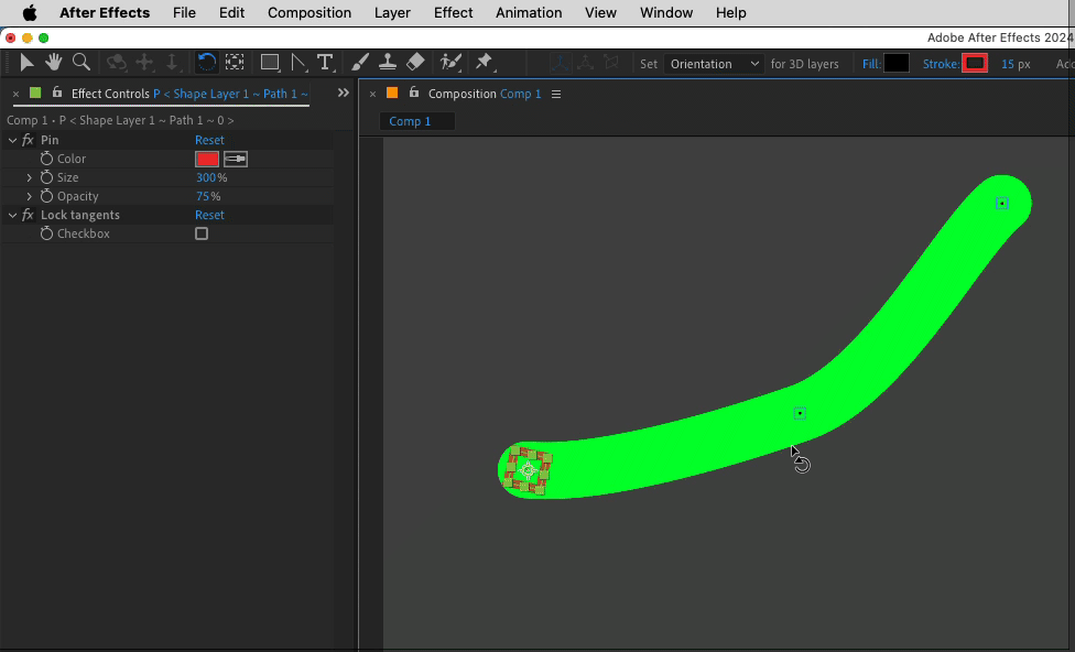

Have you tried working with DUIK pins? They are actually Shape Layer controllers for anchor points of paths. So your vector stays intact.
Once you have those pins in place you can rotate them and access the tangents of the path to make it loook the way you want.
