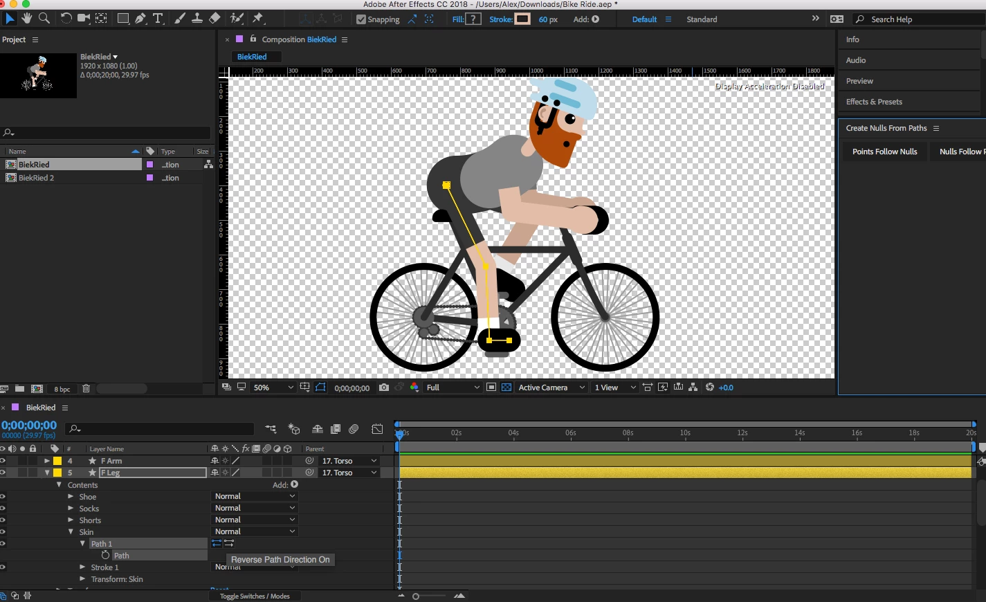

Create Nulls From Paths: Position is way off
Hi! I love the new built-in feature "create nulls from paths." However, sometimes I get an issue where the newly created nulls are not where they should be. Please see the examples below, where the front leg of the bicyclist kicks out four misplaced nulls. Anyone else having this issue? Any workarounds? Fixes? Advice?
Thanks!

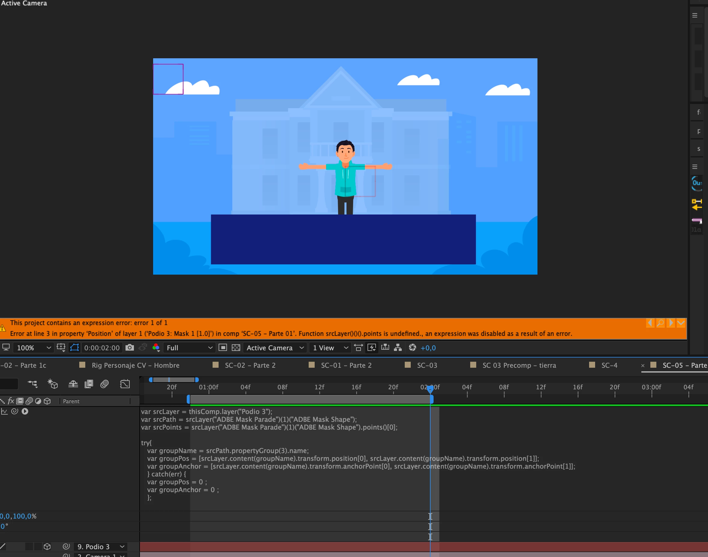

    Aug 6, 2020 6:21 PM UTC
    Good afternoon I need help I have the same problem when creating a null in a mask, the points do not come out where I need how can I solve this thank you very much
