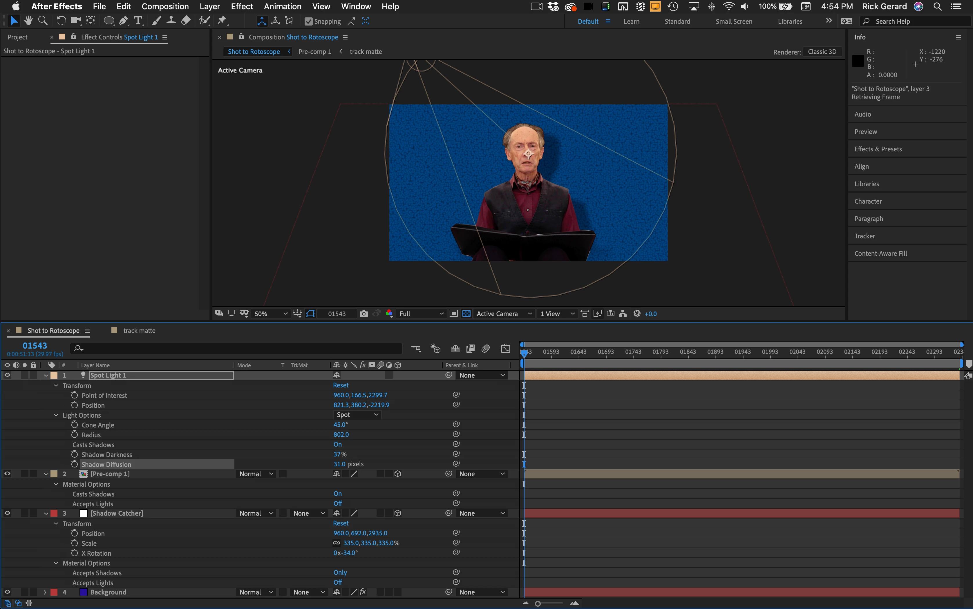

You can set a layer to cast a shadow only. That is probably the easiest solution if you have used a standard workflow.
Personally, I would make the layer with the actor 3D, set up a shadow catcher using a white solid, rotate the white solid -90º in X and position it so that it matches your virtual floor (or position it like it was a wall) then add a light to the scene that matches the direction of the lighting in the scene. Now all you have to do is select the shadow catcher and the keyed layer with the actor, press aa to reveal the properties, and set the keyed layer to cast shadows on and receive lights off, then set the shadow catcher to receive shadows only. If you have the Shadow Catcher in the right position it should take about 2 minutes and you don't have to monkey with anything else.

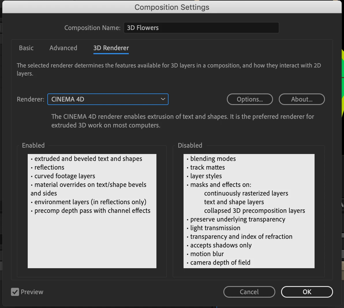

You are using the C4D rendering option. You need to be using Classic 3D. Check the options that are disabled when using the C4D rendering engine. The warning is not read or understood by most users.
