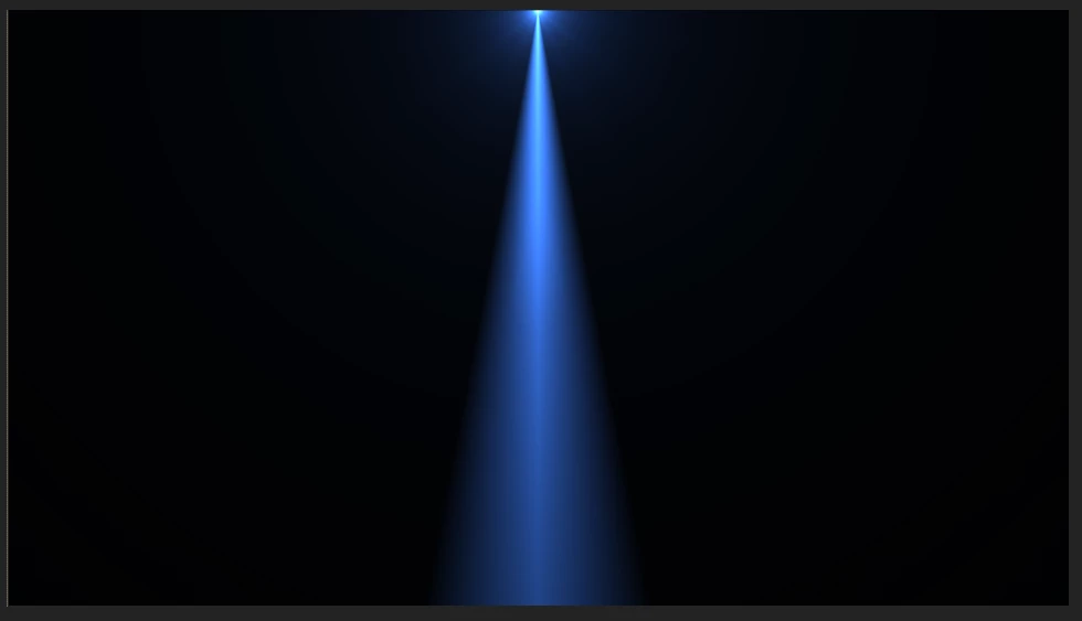

I'm not too sure how to make an elipse path that I can connect my Centre Position to my Optical Flares Light and keep my light in 1 position at all times.
The image above shows a 1920x1080p Screen where the Light is positioned at XY: 960,00 and Centre Position is set to 960,1080.
What I'm interested in doing is figuring out how I can take the Optical Flares Setting when I put it to "Track Lights" and position the Lights withing a 3D Scene for extra Depth.
When I move do Track Lights though. It fixes the Centr Positioning and I end up moving the lights out of position.
What I wanna do is be able to move the Centre Position on a Fixed path and have the Light be Position so It will look like moving light fixtures for a Concert.

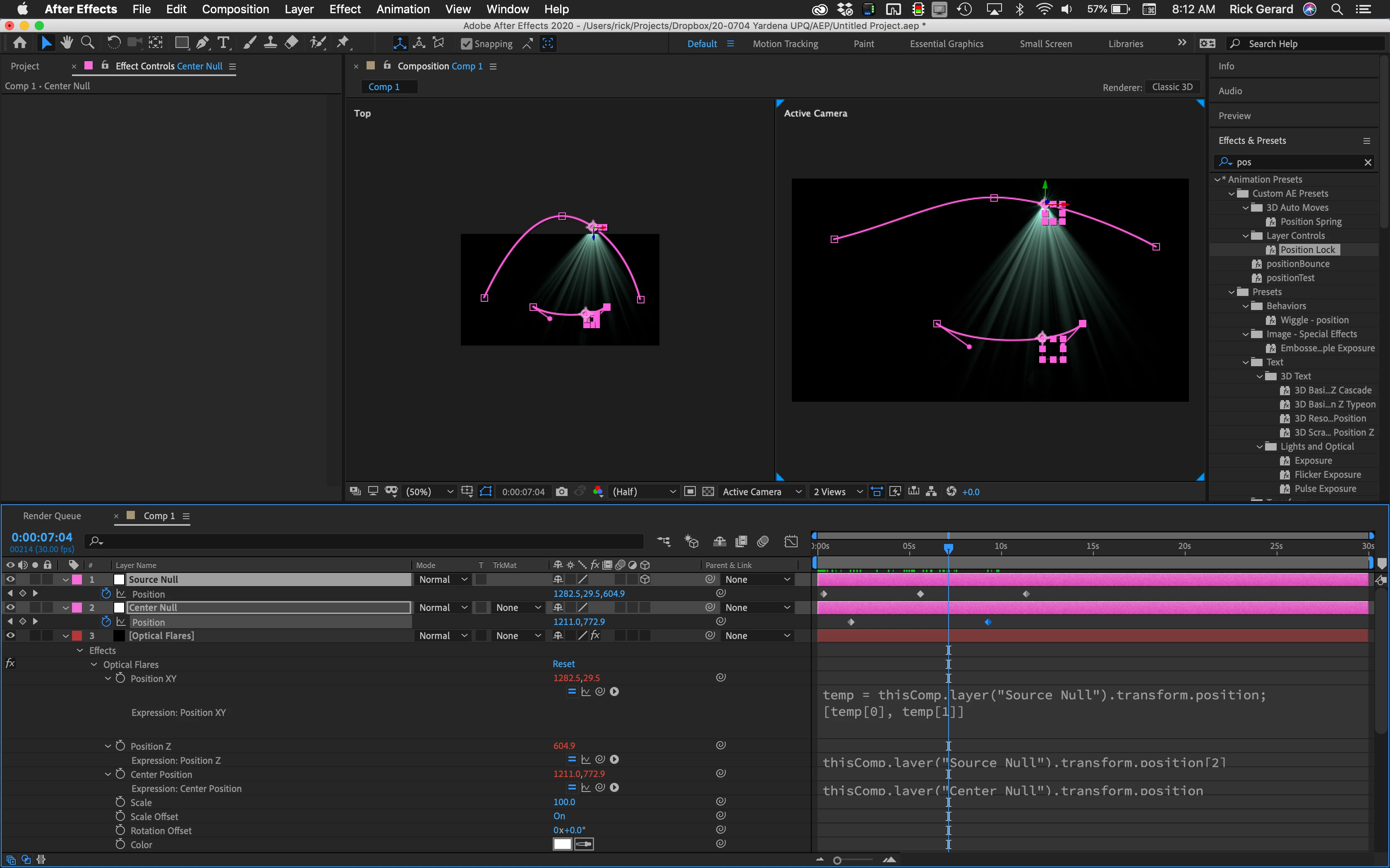

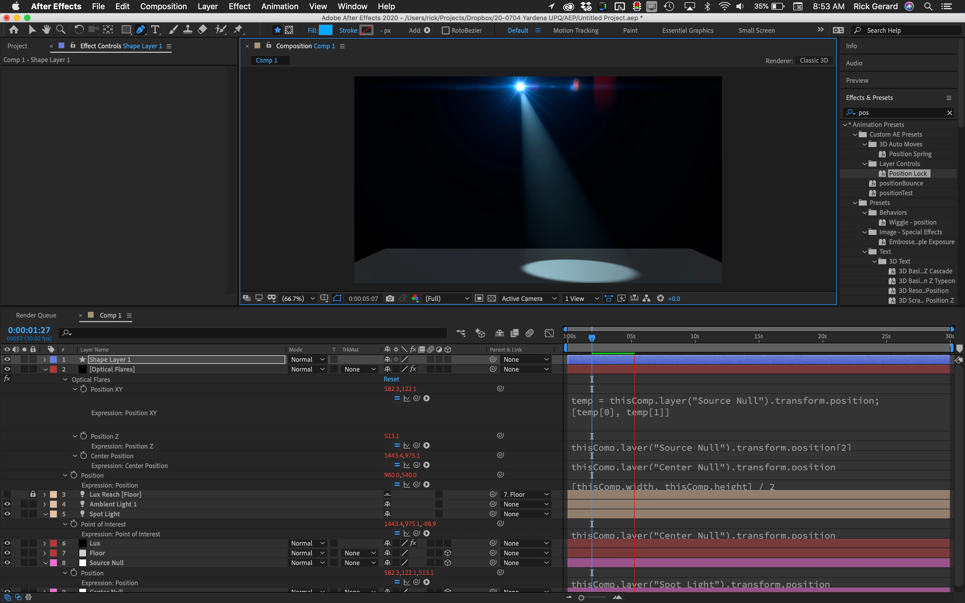

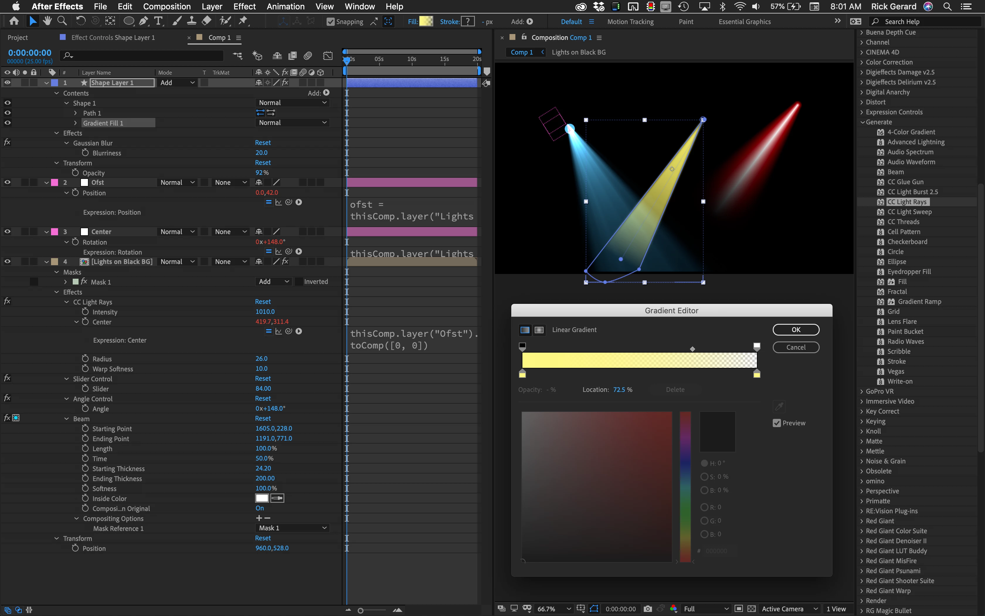

Red Giant sells Trapcode Lux for $199. There are lots of tutorials on their site. Video Copilot has tutorials on Saber.
There are lots of ways to simulate a spotlight. Here's a project file for you to play with.
July 21, 2020
What Mylenium said.  You can activate 3D for the source and you can tie the origin and center to a null that you can animate just using the pickwhip in the Parent/Link column, but the Center is 2D so the illusion of a flare can be maintained the illusion of volumetric light is not really possible.
Add Lux to the mix and you've really got something.

Flares are flares, not volume lighting. Flares happen inside the lense and messing with the lens center is actually physically incorrect. that's why it may work for a single light or a handful of them with identical flare settings, but the illusion will break down once you start using 3D lights. Therefore the only sensible answer can be to invest those 50 bucks or whatever it currently costs in Trapcode Lux, which is actualyl meant to simulate light cones and works correctly with 3D right off the bat.
