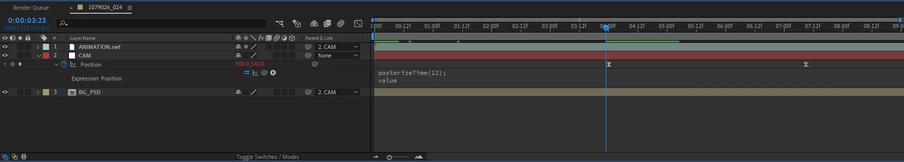

I'm working on a cartoon compositing job where i'm given a bunch of SWF files to composite on top of a PSD BG and then add camera moves using a Null object.
The camera move request is for moves to be on 2's, or, 12fps in a 24fps comp. The problem i'm experiencing is that the posterize time effect / expression sets the cam to move on even frames, when my animated SWF files are animated on odds. This causes strobing when my CAM and animation layers are not moving on the same frames as each other.
Are there any methods for customizing a posterize time effect to achieve what I need?

    I have uploaded a screen capture to my original post 'TL.jpg'. Essentially what I want to control is for the posterize time to begin either one frame earlier or later, so the movement happens on 'odd' frames instead of 'even' frames. The only way I know to get around this is to manually keyframe my camera moves, frame by frame. An automated solution would be a huge timesaver as I have around 150 of these style shots to do per week.
