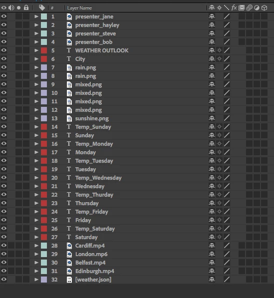

    My AEP looks like this:
    My script for the text fields looks like this (for example, the City title):
    myData = footage(“weather.json").sourceData[0];
    data = myData.City
    SO… what i’m looking to achieve is a solution where the 4 respective City video backgrounds, and 4 presenters are made visible or not depending on the infographic data - which city the bulletin is for, and who the presenter is.

    Nov 21, 2017 10:02 AM UTC
    The simplist methodology in my head is that the 4 background video laters and 4 presenter PNG sequences are all present in the comp, and each has a script attached to the opacity that says something like -
    IF myData.BG = “LONDON” then opacity = 100, otherwise opacity = 0 (for the LONDON.mp4 layer)
    IF myData.BG = “EDINBURGH” then opacity = 100, otherwise opacity = 0 (for the EDINBURGH.mp4 layer)
    IF myData.BG = “CARDIFF” then opacity = 100, otherwise opacity = 0 (for the CARDIFF.mp4 layer)
    IF myData.BG = “BELFAST” then opacity = 100, otherwise opacity = 0 (for the BELFAST.mp4 layer)
    As I say, I'm a novice to scripting, so this may not be the best solution, but seemed the most logical to me!
