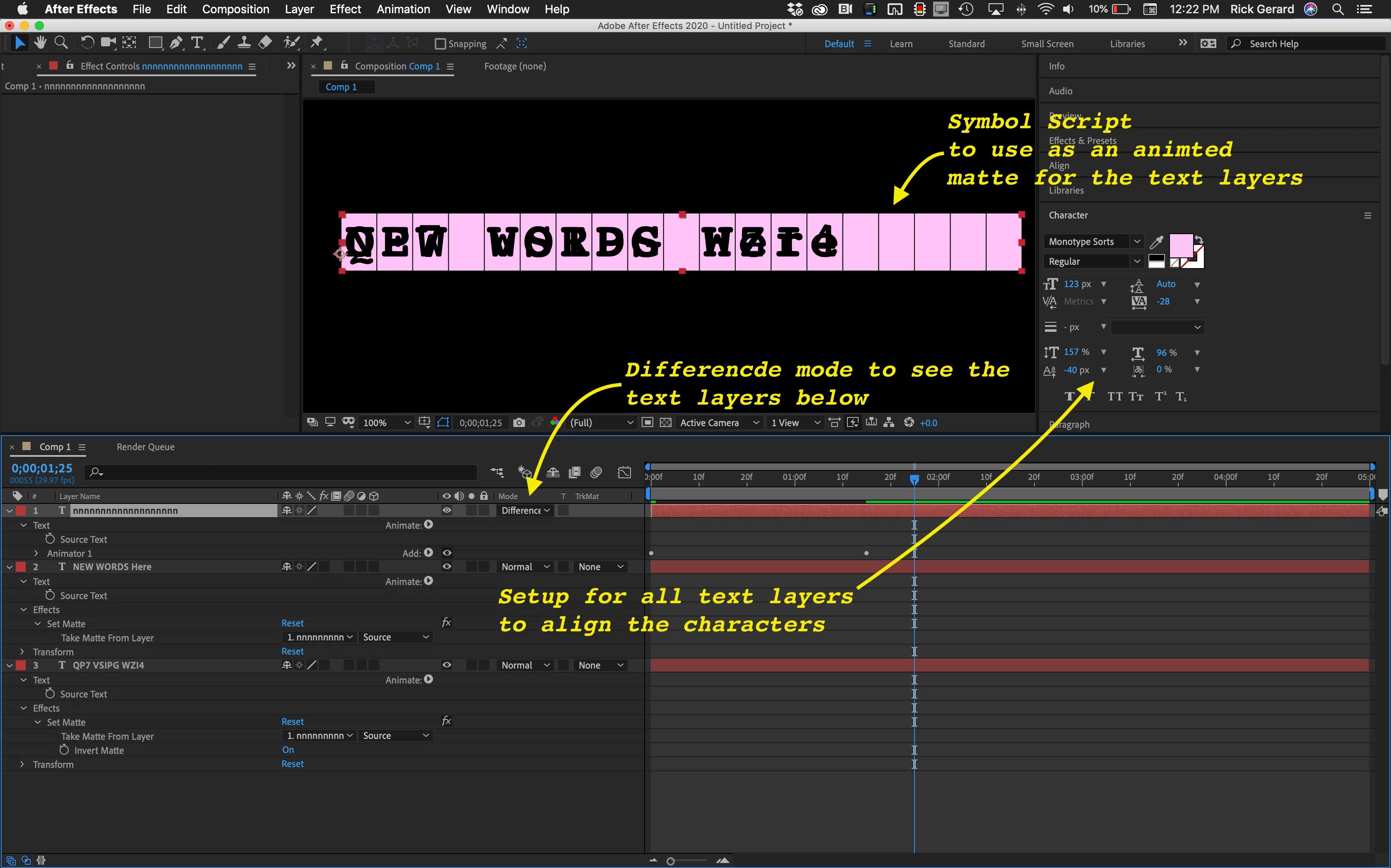

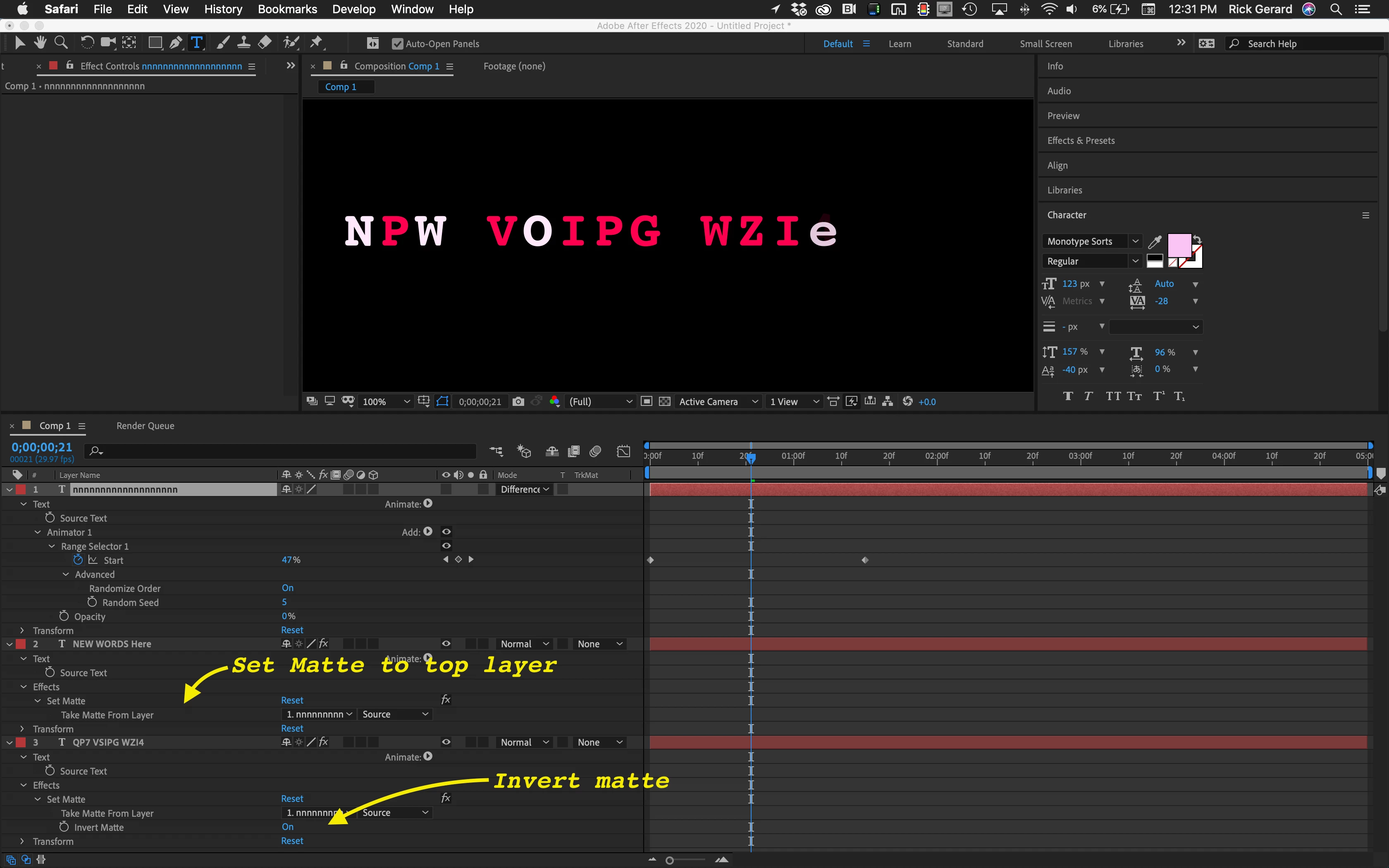

Most of the time trying to do everything on one layer over complicates a project. Here's a solution a little outside the box:
1.  Create a new text layer with your random characters
2.  Create a new text layer with your final text
3.  Create a new text layer with a symbol font to create a box for each letter
4.  Adjust the scale and tracking of all text layers to line up the boxes with the other two text layers (easiest to do using the difference blend mode
5.  Add Set Matte to the second and third text layer and set the top symbol font text the source and invert one of the copies.
6.  Add the Random Fade In-text preset to the top layer
Here's what that looks like:
If you use Monospaced fonts this is incredibly easy and quick to set up. Much faster than monkeying with expressions.
It took me about 10 minutes to do this. Here's the project file: https://www.dropbox.com/s/dchswxxyt8xsedh/Random%20Txt%20using%20mattes.aep?dl=0
