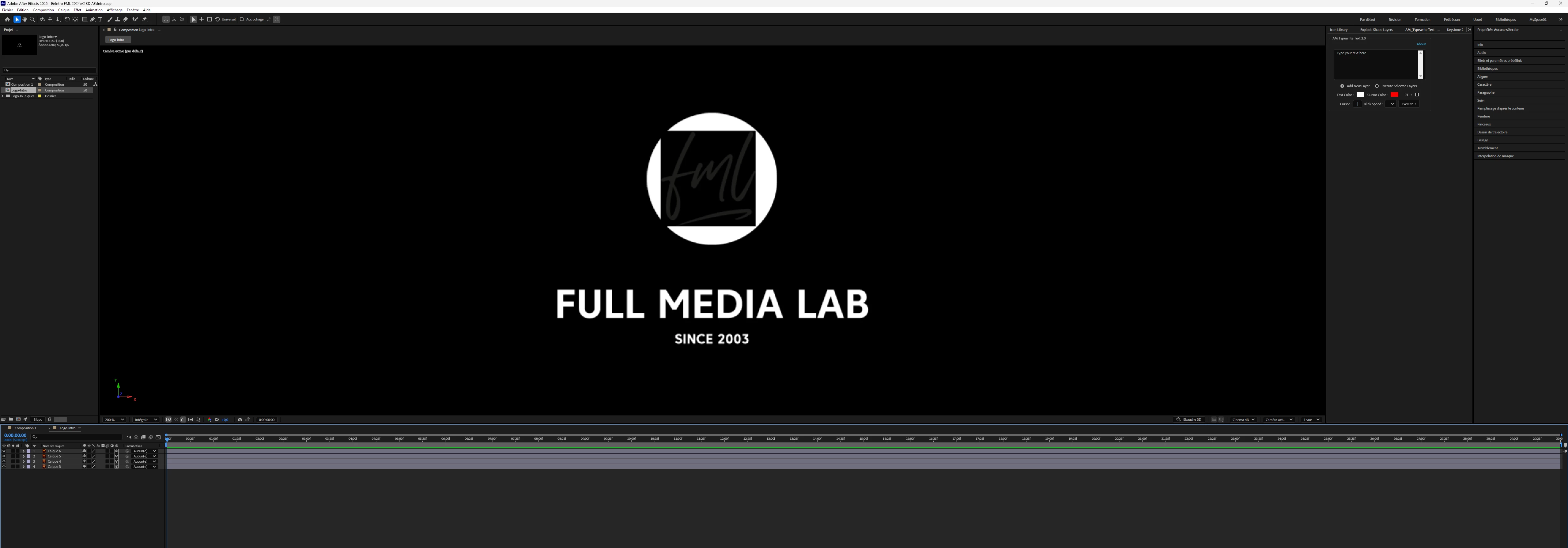

I was trying to animate my logo in After Effect. When I turned on 3D on the layers, I got a display error on one of the layers. I'm not sure why, but a black frame appears around the image on one of the layers. I think black represents transparency. Take a look at the attached screenshot. This isn't the first time this has happened. The last time it happened was in the previous version of After Effect.

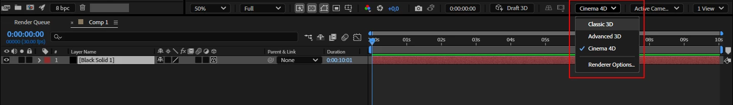

Nov 2, 2024 11:27 AM UTC
Oui, j'active toujours le moteur de rendu Cinema 4D !
Nov 2, 2024 10:46 AM UTC
Même chose si tu utilises un autre moteur de rendu que Cinema 4D?
Ou modifier les position Z, c'est pas bon d'avoir des calques qui se chevauchent en 3D

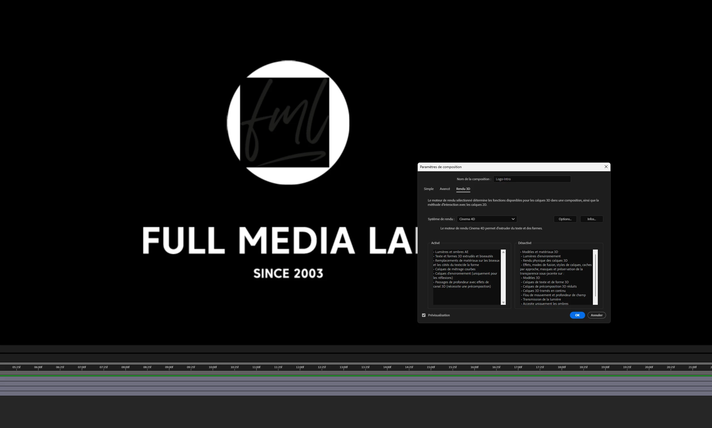

There are no error messages.
There is only this display bug.
Check this image below for more details.
I think the black frame is the transparency ....
