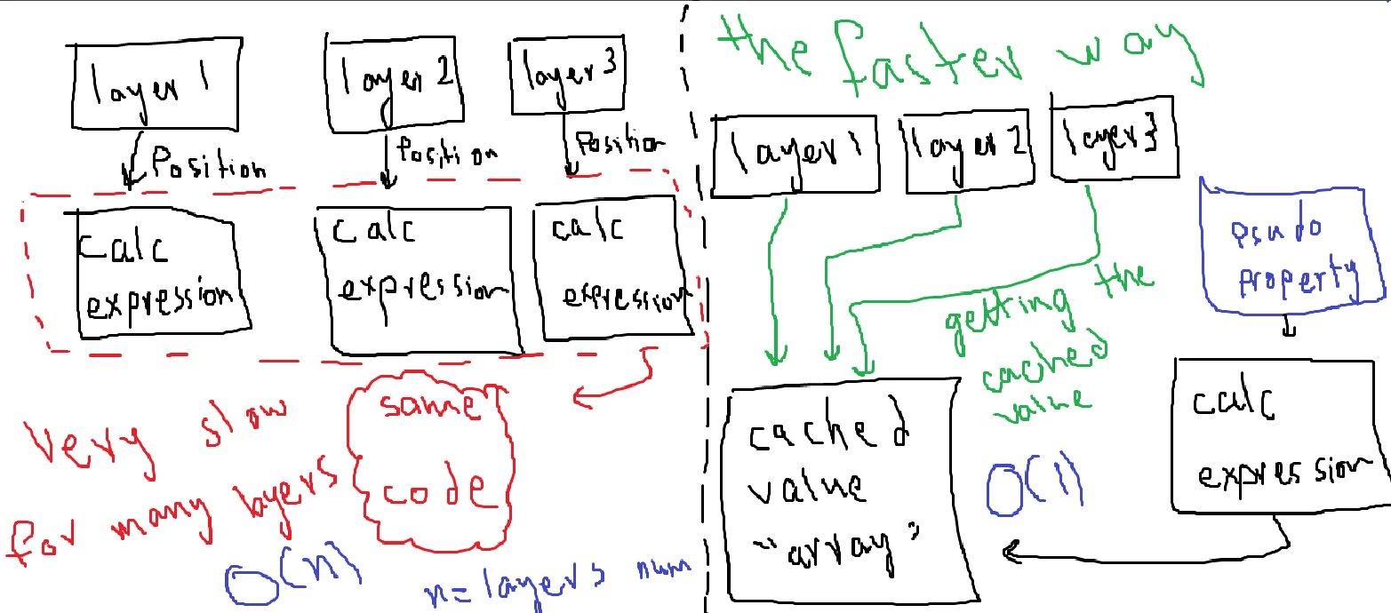

Here is more information about my use case!
I am working on a tool to create grids and add items (layers) inside the grids' cells.
You can see some results in these videos:
video 1 video2
So, how this thing work exactly?
There is an expression on each layer's position and scale property that calculates the right place for the item each frame.
This expression actually the same code for all these layers.
The expression calculates all the positions for all the layer's and then picks the position of the current layers that is on.
The expression is not very fast, and calculating it for each item('layer) makes it even slower, it will be a major optimization if I could calculate this expression on a psudo effect, and we make the layers get the result array and get its position and scale values!
This picture here can impove the understanding of my case:
