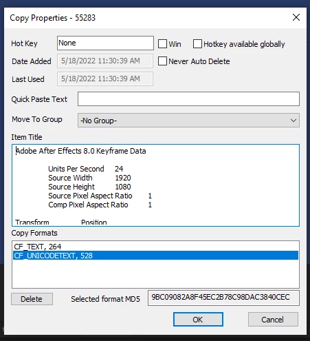

Probably not just the text but also the CF_ type of data needs to be correct.
Quick inspection with Ditto shows this formatting
Justin Taylor-Hyper Brew
May 18, 2022
