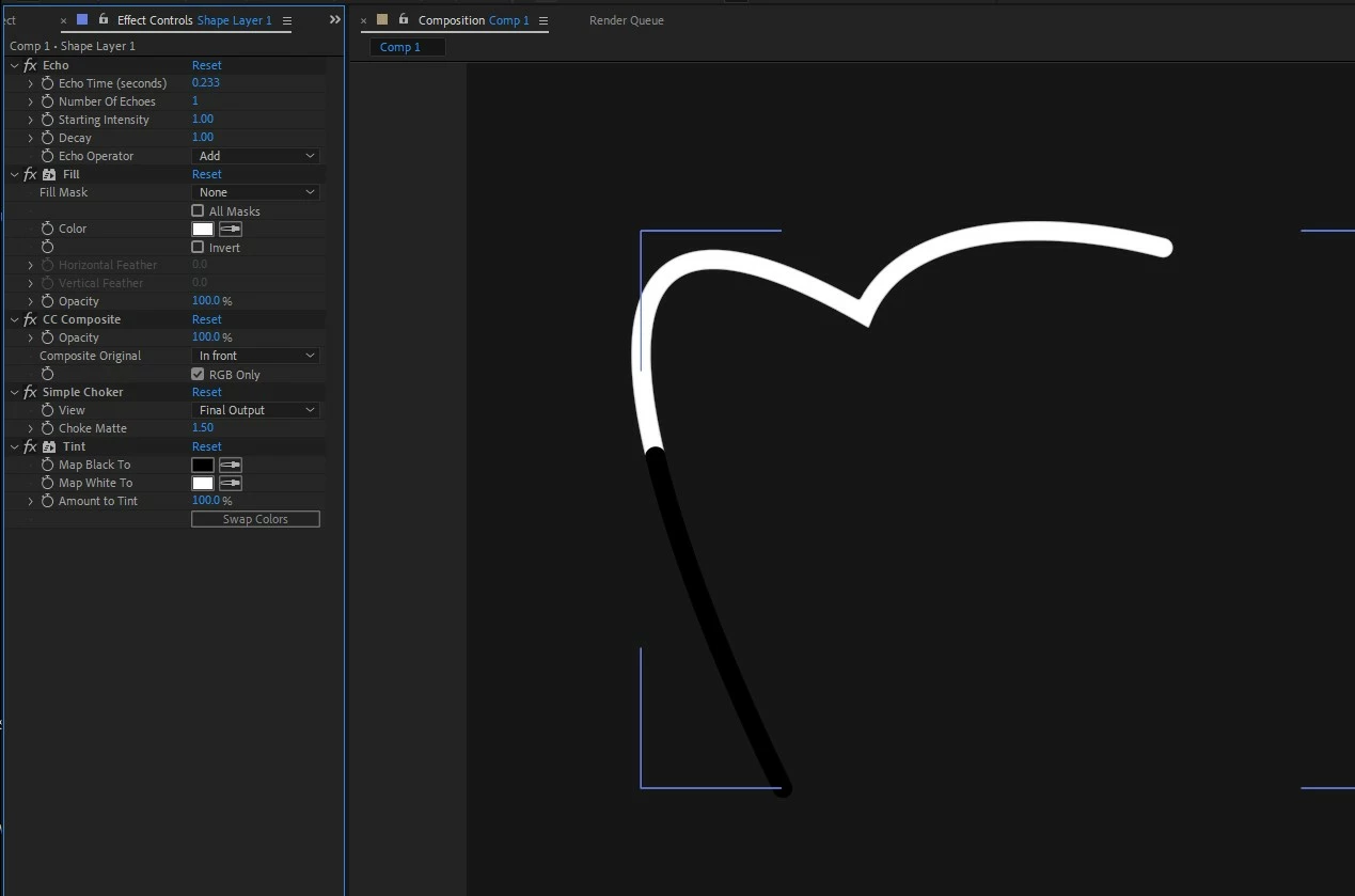

- You can create a procedural effects stack using Echo, you just have to work out the compositing. This is a quickie version that actually uses Echo "in reverse," so the leading (white) version is actually happening before the Trim Path keyframes in this example. The Simple Choker cleans up any rough edges and the Tint gives you color control AFTER the compositing happens. Again, this could be saved as a preset and easily called up in the future. If your shape is otherwise moving, this solution might not be as good, as Echo will also apply itself to layer transforms, etc. unless you precompose this.
