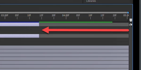

When I drag two bars in the timeline entire bar is moving. Some times only extension takes place. How to decide whether I need extension or moving bar.
See this Demo video. Entire bar moves key frames as well. Edge moves bar only.
You need to understand the basics of After Effects. A move operation moves the keyframes as you move the layer. Trim operations only lengthen or shorten the length of the layer and it does not affect keyframe position in any way. Two different command for tow different operations.
Example 1: you want to maintain an animation in the exactly same place as you have it right now but you want the layer to start earlier. TRIM
Example 2: You want the animation to start earlier in your composition, then MOVE.
