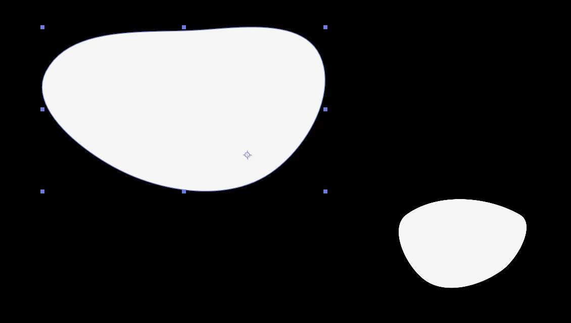

Hey,
about 2-3 months ago, I noticed that the way the path tool works in shape layers and masks changed for the worse. When I draw masks nowadays, AE tries to change the paths between the points to even roundings (as you can see in the picture), and changing the roundness influences both sides of a point instead of giving the option of influencing the roundness of each side of the point individually.
Before this change, when I drew the path, I could also just set the points without any roundness as a standard or hold while setting the point and then decide the roundness. Both aren't possible anymore.
I'm using the latest version (24.6).
This makes my work a lot harder. I hope someone can help me.

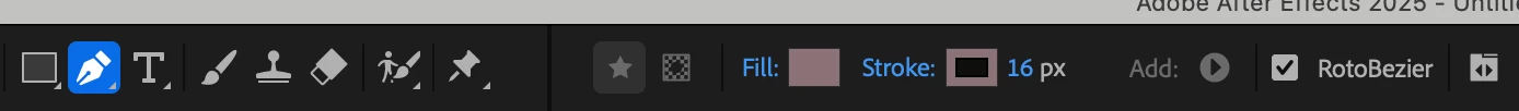

I reached out to the Adobe Suppot directly and they were able to help me. Basically, you just have to click on the checkmark next to the "RotoBezir" label that is visible when you draw a shape. When turned off, you can draw shapes the old way. There was also a very detailed answer regarding the chance I recieved from them:

For those who cannot find the switch, the RotoBezier option is in the toolbar.
Turn the option off, and the default path editing tools will return.
