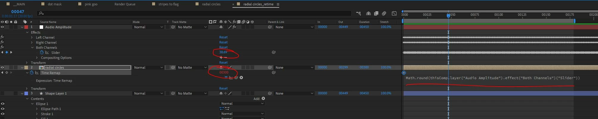

Can anyone tell me why the attached expression is not working to drive the keyframe of my time-remapped layer? It seems like this should be pretty simple but it's not working.

Try this instead:
framesToTime(Math.round(thisComp.layer("Audio Amplitude").effect("Both Channels")("Slider")))

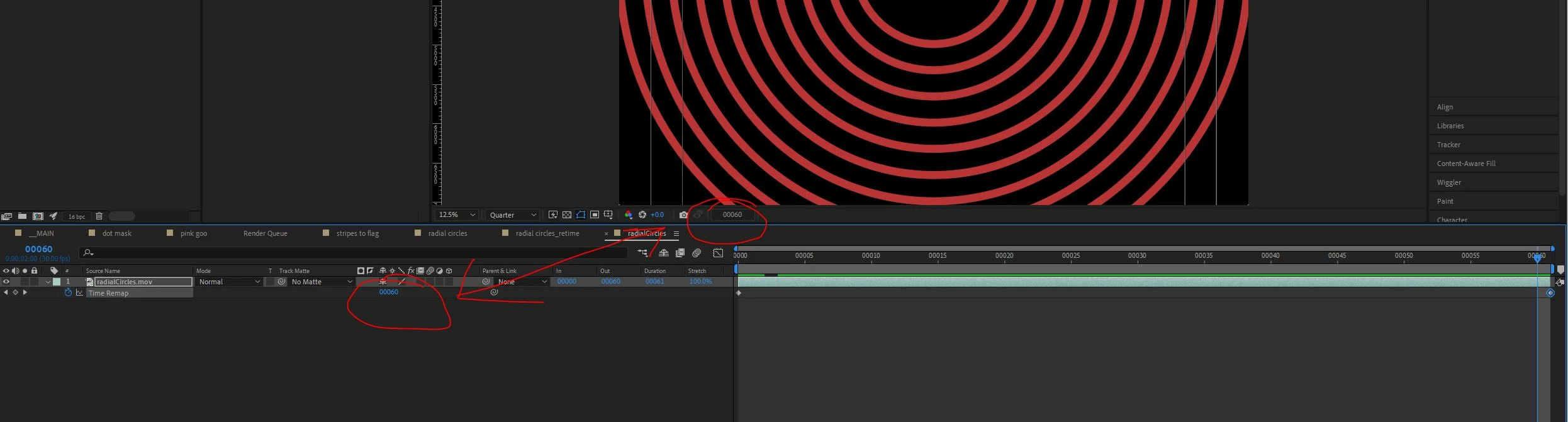

Jun 11, 2024 3:42 PM UTC
Respectfully, that can't be correct. When I drop a clip into a new composition and then time-remap that clip the value for the time-remap matches the keyframes exactly. Always has.

Jun 11, 2024 3:58 PM UTC
If you add a text layer, and link it's source text to the time remap in value, you'll see that the value is actually in seconds. Alternatively, create a simple time remap expression and just enter the number 1 for the expression. You'll see that the value is displayed in frames, but the value is actually 1 second.

Jun 10, 2024 9:13 PM UTC
Time remap expects a value in seconds, were you possibly assuming it was frames?
