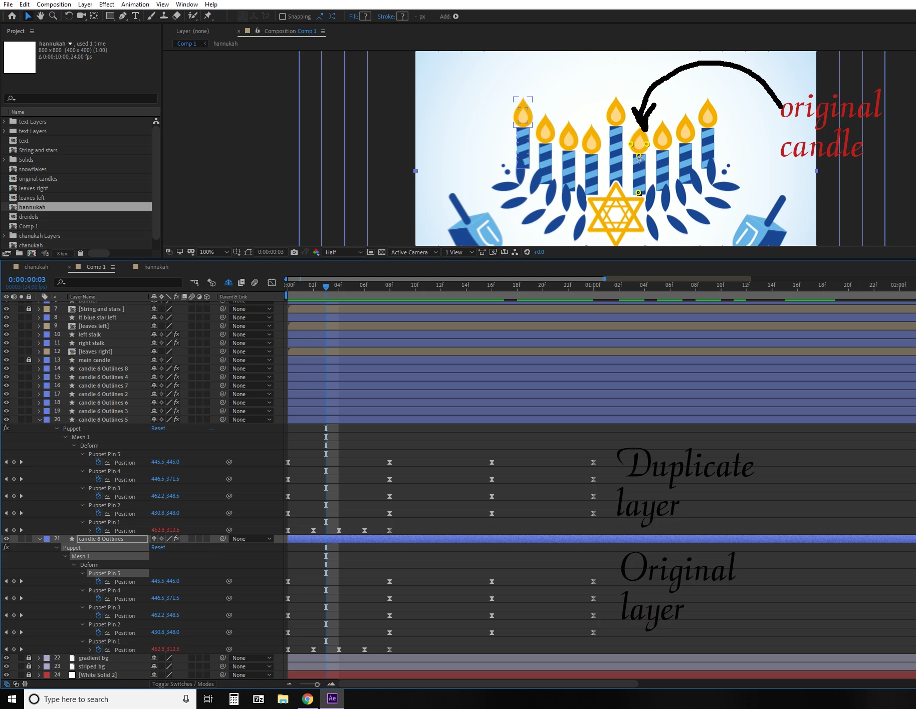

I have a flickering candle with puppet pins.  When I duplicate the layers, the new layers have the KF's but they do not flicker.   I highlighted the pins on the original and copied to the new layers, but that does not work either.   how to copy the pins from original to new layers?   Thank you

I put the pins on the original shape, made the animation.  then duplicated the layers.  the layers are the exact same size .     the pins did not copy
Edit.   I found what I was doing wrong but it created a new problem
When I moved the new layer to the new position,  i did not highlight the pins, so the pins did not move.
new problem :  when I move the pins, the graphic "breaks"

can you share a screenshoot including your work flow with all layer?
zoom4267Author
November 22, 2018
thank you , here is the screen shot,  its cc2019
