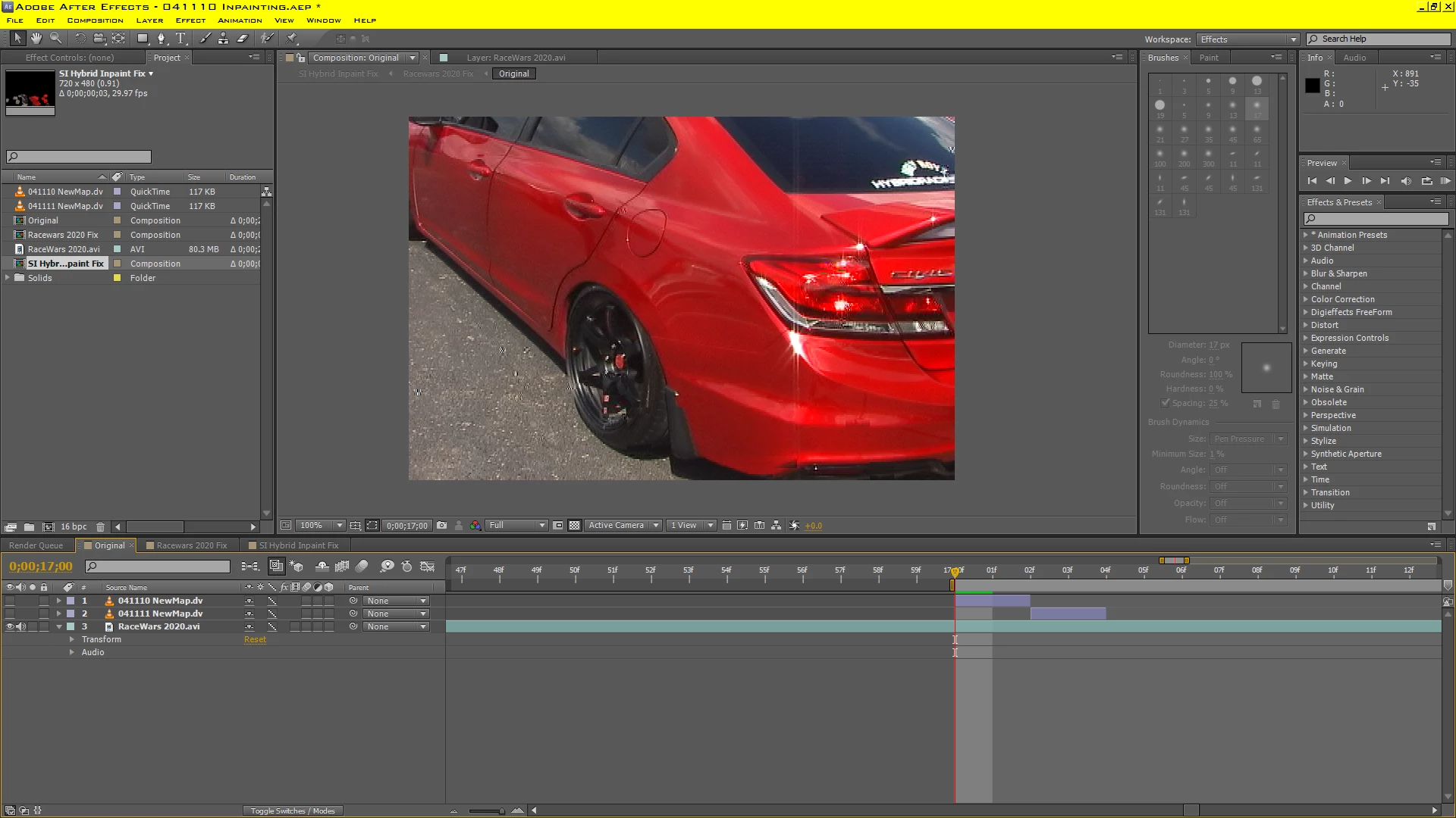

So, here's the original image with the corruption:
It is in the bottom-right corner.

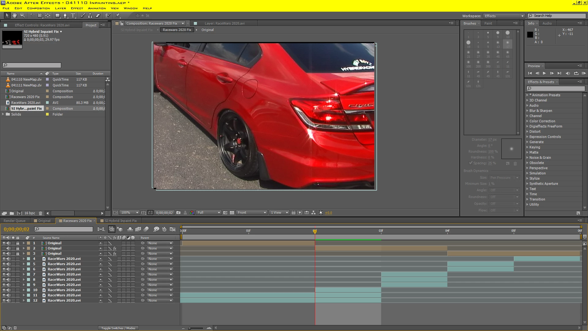

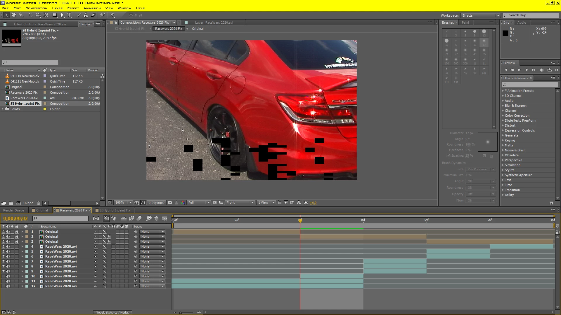

So first I removed the corrupted blocks:
Then I used the preceding and succeeding frames (with masks) to "paint" the missing parts of the image:
Here's what the final product looks like:
Looks good from a distance. But that checkerboarding pattern you see by the wheel of the car? When I put the newly inpainted blocks into the original video file with a hex editor, more of that appears, because the DV overflow scheme is different on the saved file. I need AE to save my file using the original file's overflow scheme.
