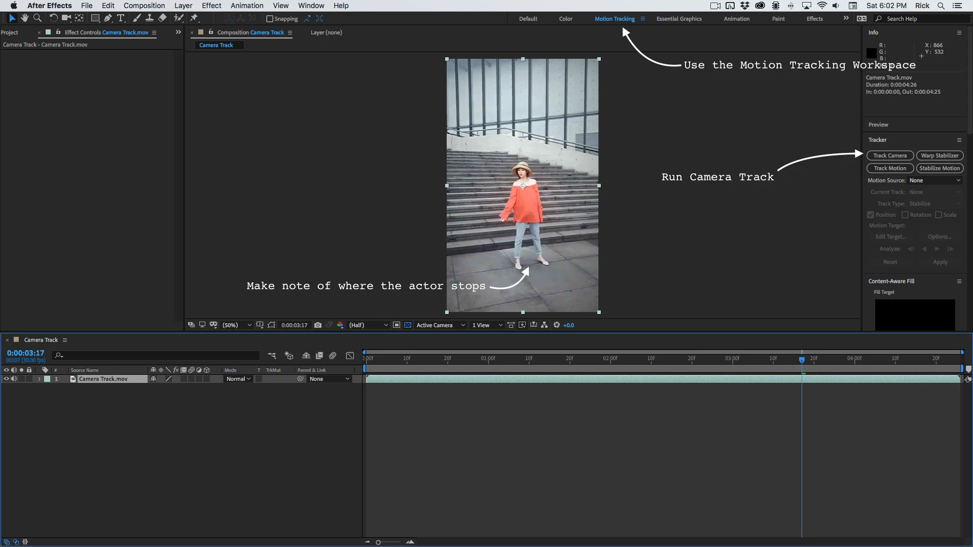

This kind of visual effect starts with Camera Tracking:

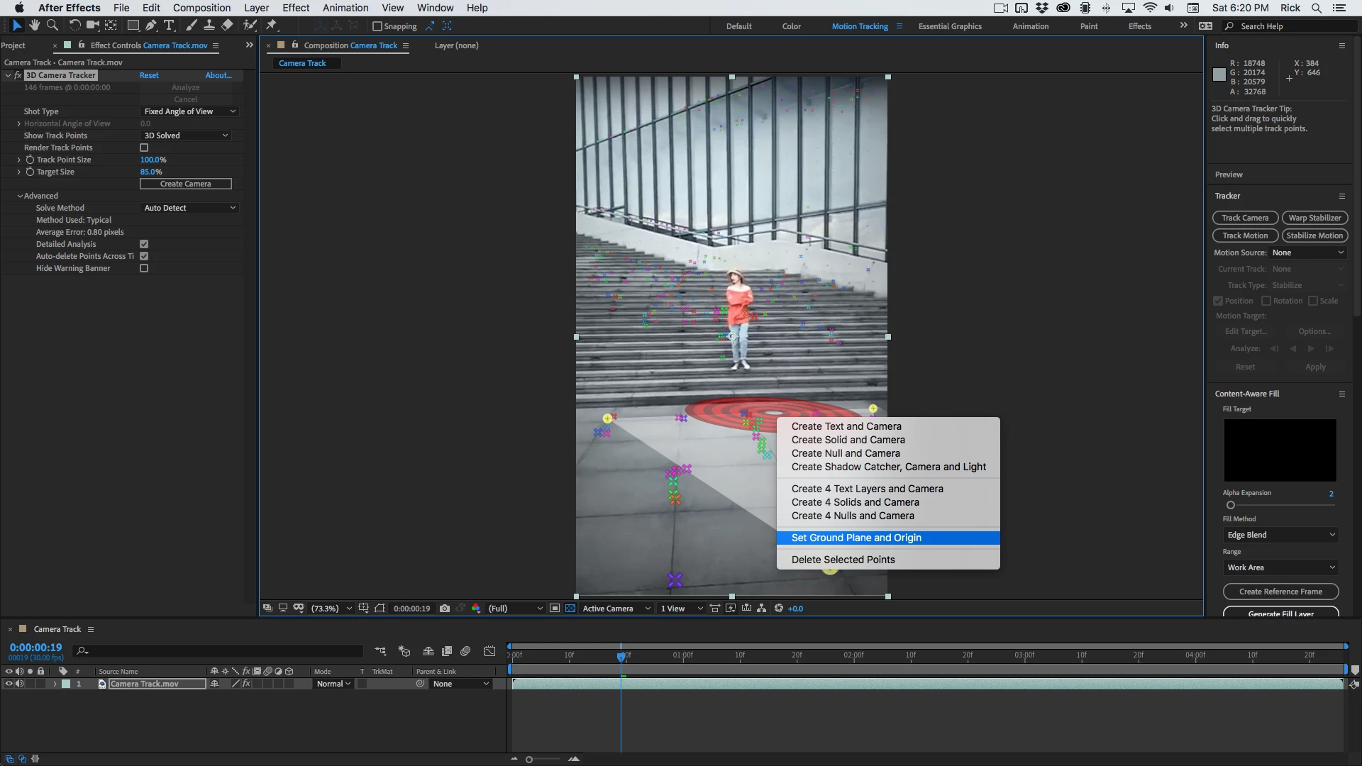

After you have planned your shot and noted the critical positions you run the camera tracker. For this clip I chose the following settings:

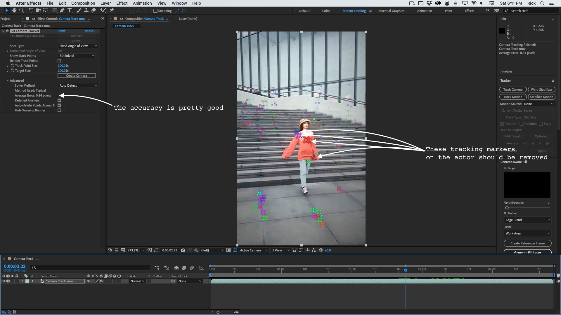

You have to check the accuracy of the track and delete tracking markers on the actor or any other moving object that may decrease the accuracy of the track. When you get good accuracy it's time to move to the next step:

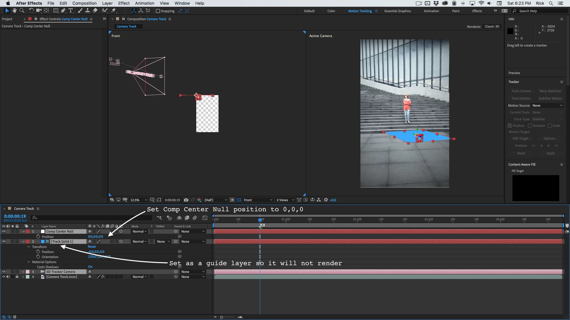

Then you set an origin and ground plane where the actor stops, then add a Camera and A solid using the same markers. It's also a really good idea to add a comp marker at this time. Double-check the track and make sure that the solid is firmly attached to the floor right on the spot where the actor stops.
After you have done that, as you can see the Reference solid is at 0, 0, 0. Life will be a lot easier if you move the camera and all the tracked solids to the comp center. To do that, add a 3D null to the comp and leave move it to 0, 0, 0. Then select the camera and all of the tracked solids and parent them to the 3D null. I named mine Comp Center Null. The comp center null is then moved to the comp center using the Position/Reset tool. I also usually set the blend mode of the reference solid to overlay so I can see through it. Sometimes I add Grid to the solid to make sure that the track is accurate.
