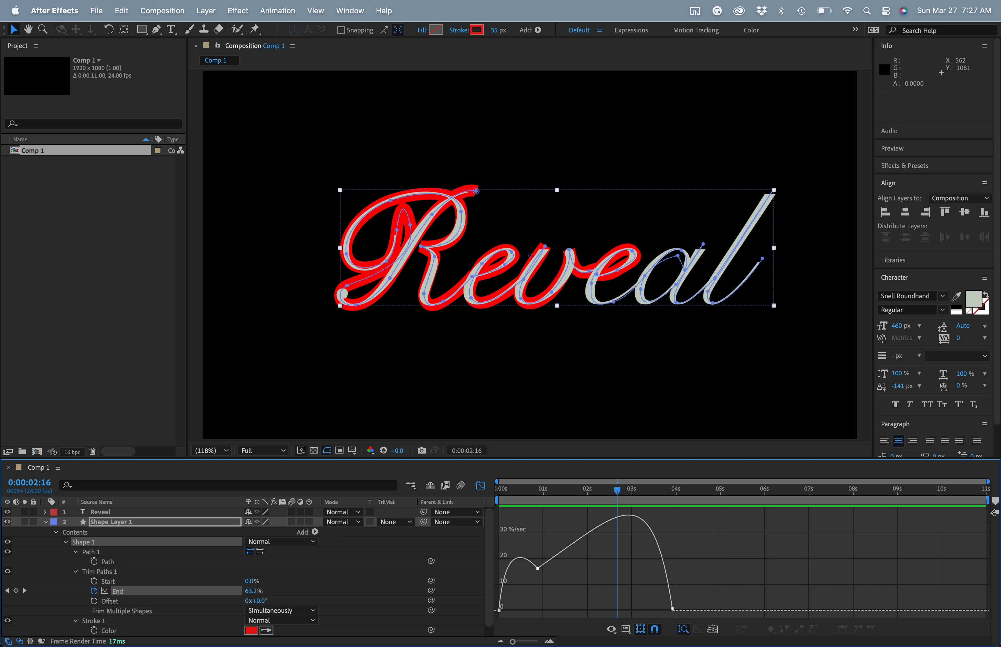

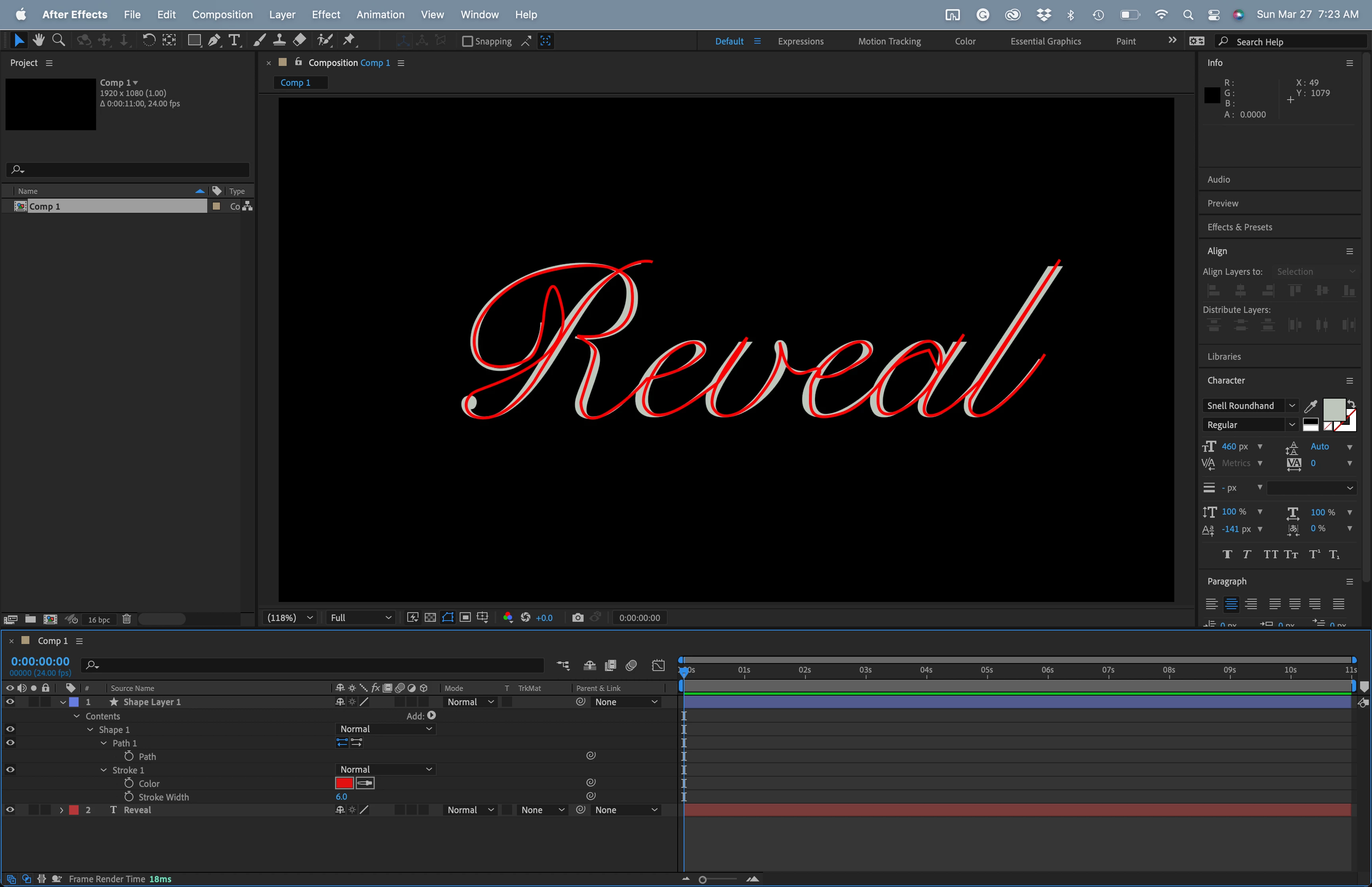

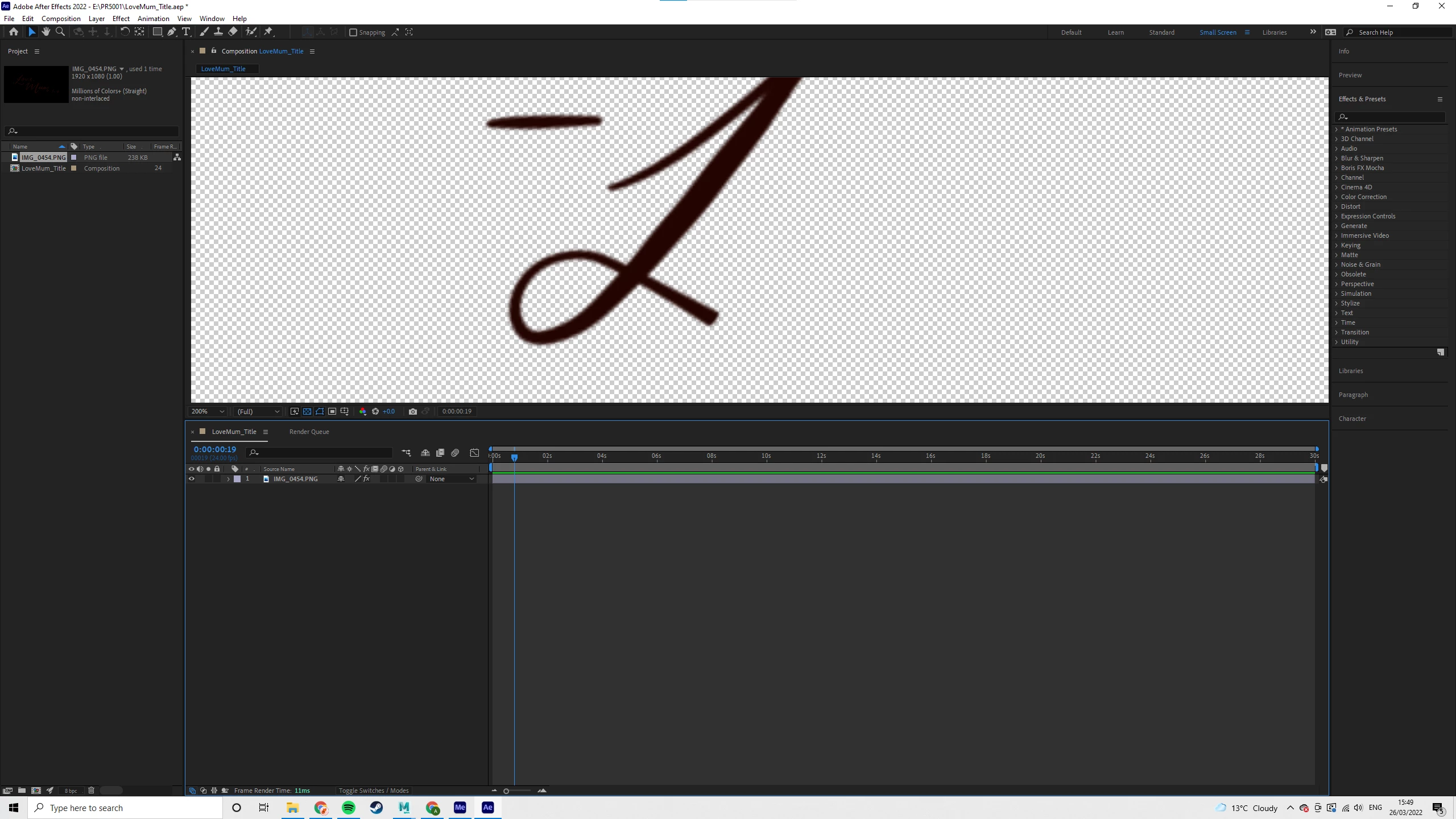

So I've created the "write-on" effect with a mask made by the pen tool with the Stroke effect applied.
However, there are parts of the stroke that I want to be thinner/thicker, so that it doesn't reveal nearby bits of text. Is there a way of editing the mask to add/remove parts of the stroke?
Hopefully that makes sense!
March 27, 2022

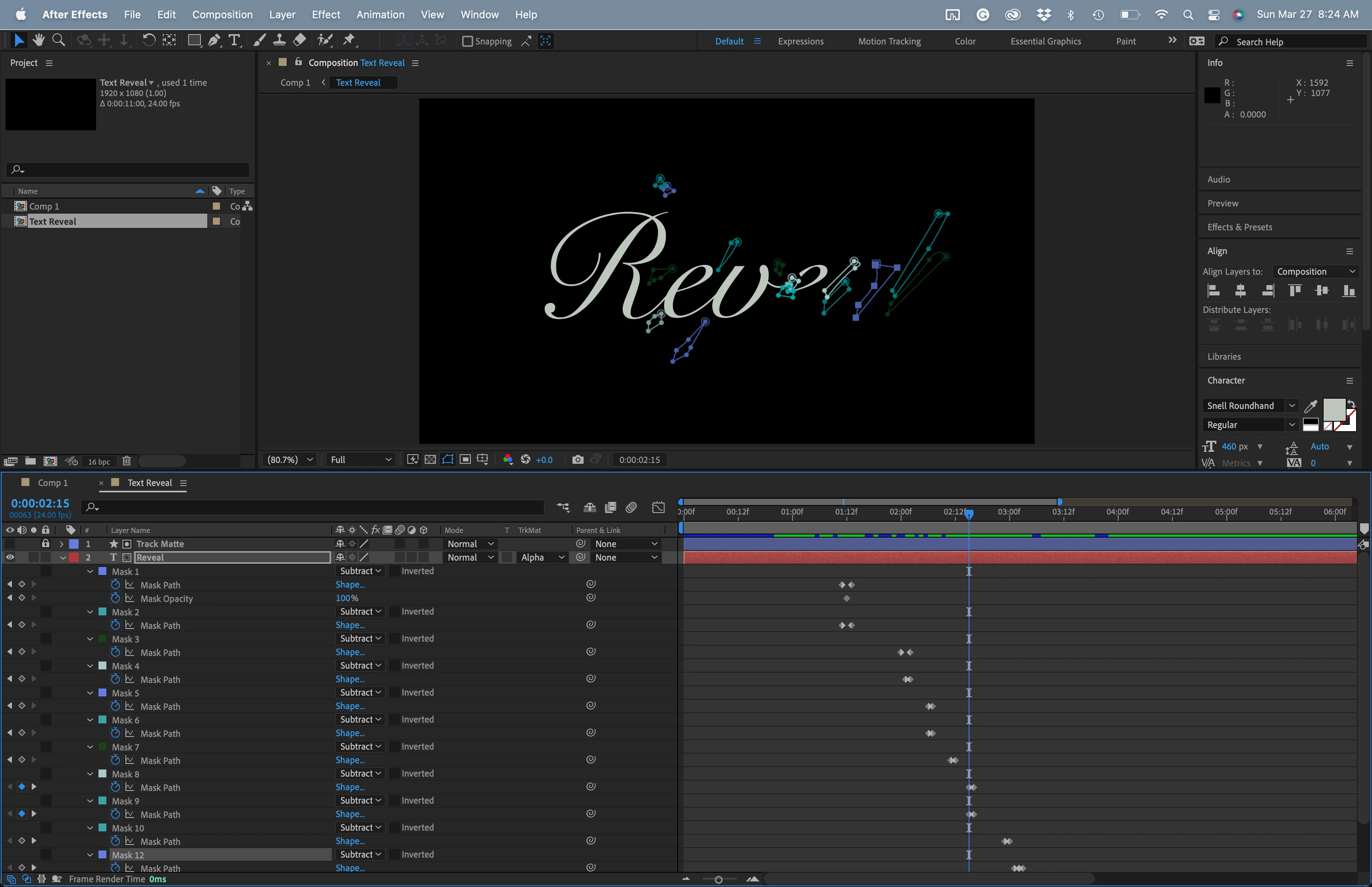

The other suggestions are pretty good. This is the workflow that I follow. I find it fairly easy to do.
  • Set the type
  • Create a path that follows the path that a pen would take to write the word, including the part where the pen leaves the paper. The stroke should be set to just a few pixels to center the path over the text easily.
  • Move the shape layer below the type layer and expand the stroke until it is wide enough to cover the entire text. Add Trim paths and set some keyframes. The Graph Editor helps with the timing.
  • Add masks to each problem intersection on the text layer. Just cover the problem areas and keep the masks tight. If you click on the last point you created and press the 's' key, the mask will change to subtract.
  • Move the track matte layer above the type layer and set it as an Alpha Track matte, then lock the layer. With the track matte layer locked (the shape layer) locked, animate the position and shape of the mask if necessary to reveal the type as needed. In most cases, the keyframes will only be one frame apart.
  • Pre-compose the Track Matte and the text layer and enable time remapping to fine-tune the timing of the reveal.
I have created this kind of animation many many times, and this workflow is the fastest and easiest I have found. This project only took me about 15 minutes. You can download it here

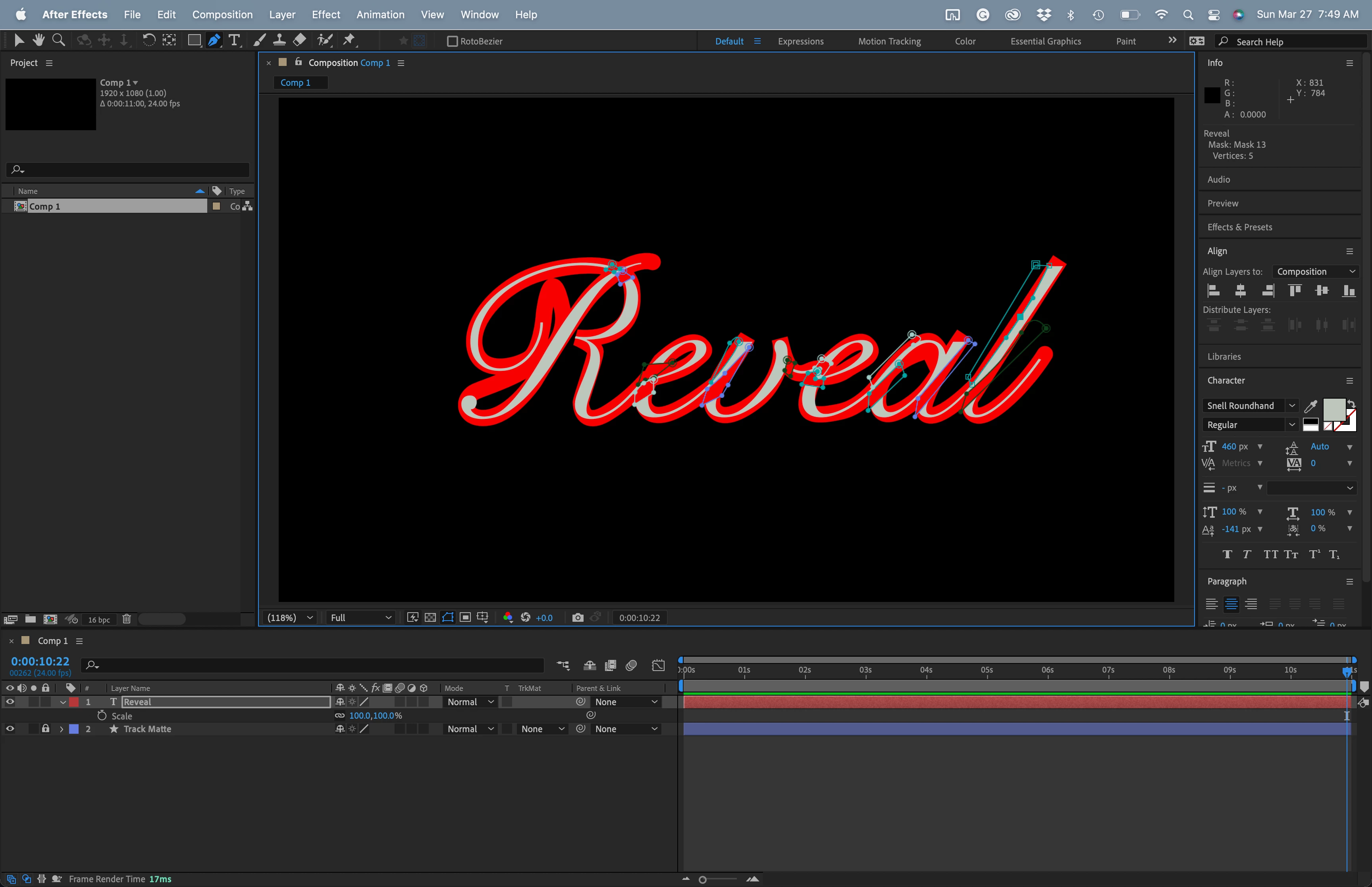

Thanks for the replies @Mohammad.Harb @nishu_kush @Mylenium - I have attached screenshots for you to better understand what I mean.
Obviously, decreasing the stroke size would result in losing the thicker parts of the letter, but currently, the mask is revealing parts of the letter which should come later. What would be the best way of tackling this?
