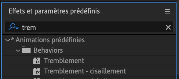

I have a project that uses layers with 'dip' effects. (I'm using French AE version)

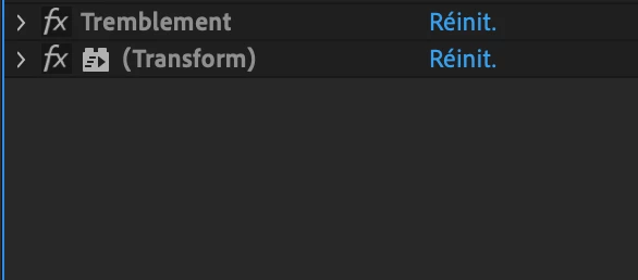

When rendering with aerender, no error is reported in the logs, but the effect is not applied to my elements.
More informations: When i add "Tremblement" effect (tremor in english) an other effect come link to it called (Transform), and this one works well in the final rendering it is well taken into account !

Either the typical issues with the expression language not matching the application language or some specific issue with AERender not setting itself to the correct language or not finding pseudo-effects. Hard to say without more detailed investigation.
