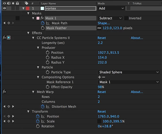

    Effects and transformations are all applied top to bottom. Select a layer with a bunch of effects and animations applied, press the U key twice and observe the modified properties. Start at the top and that's how things are processed.
    Some effects ignore transformations, some ignore masks. It depends on the effect. This stack animates a mask on a white solid that looks like the wing of a bird, generates the particles on the outside of the mask, then twists the particles outside the mask and the hole around the mesh, then the whole layer moves and scales over time producing a rotating vortex surrounding a morphing bird shape that follows a motion path. Change the order of the effects and the illusion of a twisting vortex of particles goes away.
    If you need to force something to happen in a different order or be applied around a mask there are compositing options in the timeline at the bottom of the effect controls for each effect. if that does not give you the rendering order that you need then you pre-compose the layer and apply the effect or transformation or mask that needs to be applied to the nested comp.
