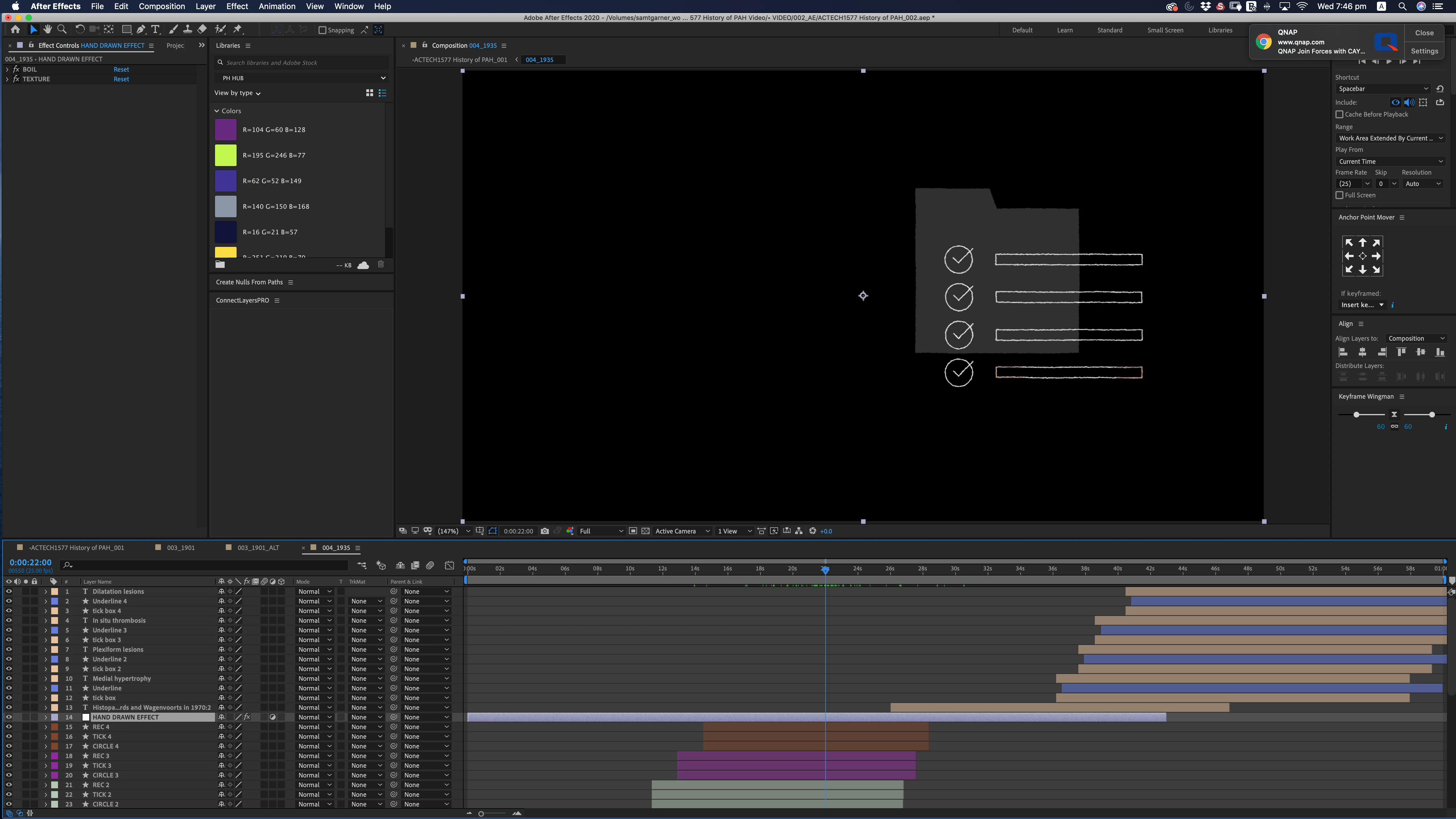

I really hope someone can help me with this. I'm putting together ananimation and I'm applying a hand-drawn effect to the linework. I'm doing this on an adjustment layer above all the layers I want to change. At exactly 22 seconds (I've tried it on a few Comps), the effect stops working and just freezes, Has anyone else had this issue and fixed it?

This is the right answer. "Exactly at 22 seconds" might be different from user to user depending on exactly what your expression is. The real limitation is ± 91 rotations and 8 degrees, or a ± 32768 total degrees. This is due to a limitation of the data type used to store the value of the evolution property (15 bits for absolute value and 1 bit for ± sign).
Now that you know that, work around that in the way that's best for you. You could use this to make the value "wrap" back to 0 once it goes beyond 32768, which will probably work as expected for most cases:
value % 32768

It was how the effect was working. I had put a time expression to a turbulent displace effect on the adjustment layer to create a hand drawn effect effect, I found if I moved that expression to the random seed rather than the evolution it fixed the issue.
