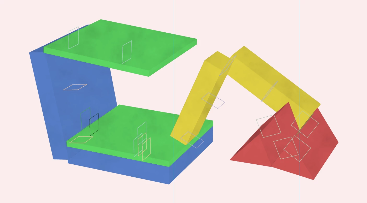

Hi All,
I'm having an issue with Element 3D layers. I've setup multiple layers using Element 3D and everything is working fine except the layers appear to overlap relative to their index in the layer panel and they are ignoring the Z-position. I've tried:
  • Purging Memory
  • Putting each element in an induidual scene instead of using Groups for each.
  • Removing Layer Style (Recommended in one of  the article I found
But nothing seems to work. PFA for reference image.
Thanks.

You should look into working C4D for this (looking at your screenshot)

Hi. Thank you for the Response, I forgot to mention in the Original post that I've also tried doing it all in a single E3D layer as well but no luck with that as well neither did changing the render settings.

You need to consider every iteration (layer) of Element 3D as its own closed 3D world.  Elements from one layer do not interact with elements from other layers, except for After Effects cameras and lights.  There are lots of tricks you can employ to get around this, but by far the easist approach is to work entirely within one Element interation on one layer.
There are 5 independently controllable groups within  the plugin, with virtually unlimited objects within each group.  If 5 groups aren't enough, as in you need to independently animate more than 5 elements, you'll need to use a second Element layer, and then use tricks like split layers, matte layers and the Camera Cutoff function in Element to fake the interaction between objects.

Quite generally simply not how E3D works. You have a wrong understanding here. All elements must be set up within the plug-in anbd on the same layer. At best you can try and work with the unified renderer by enabling it in the advanced render settings, but even that has severe limitations on how it can handle nested comps or items referenced across different layers. It's an inherent issue with how AE works on a general level. I'm afraid you need to come up with a completely different strategy and massively restructure your project or use other plug-ins or a 3D program.
