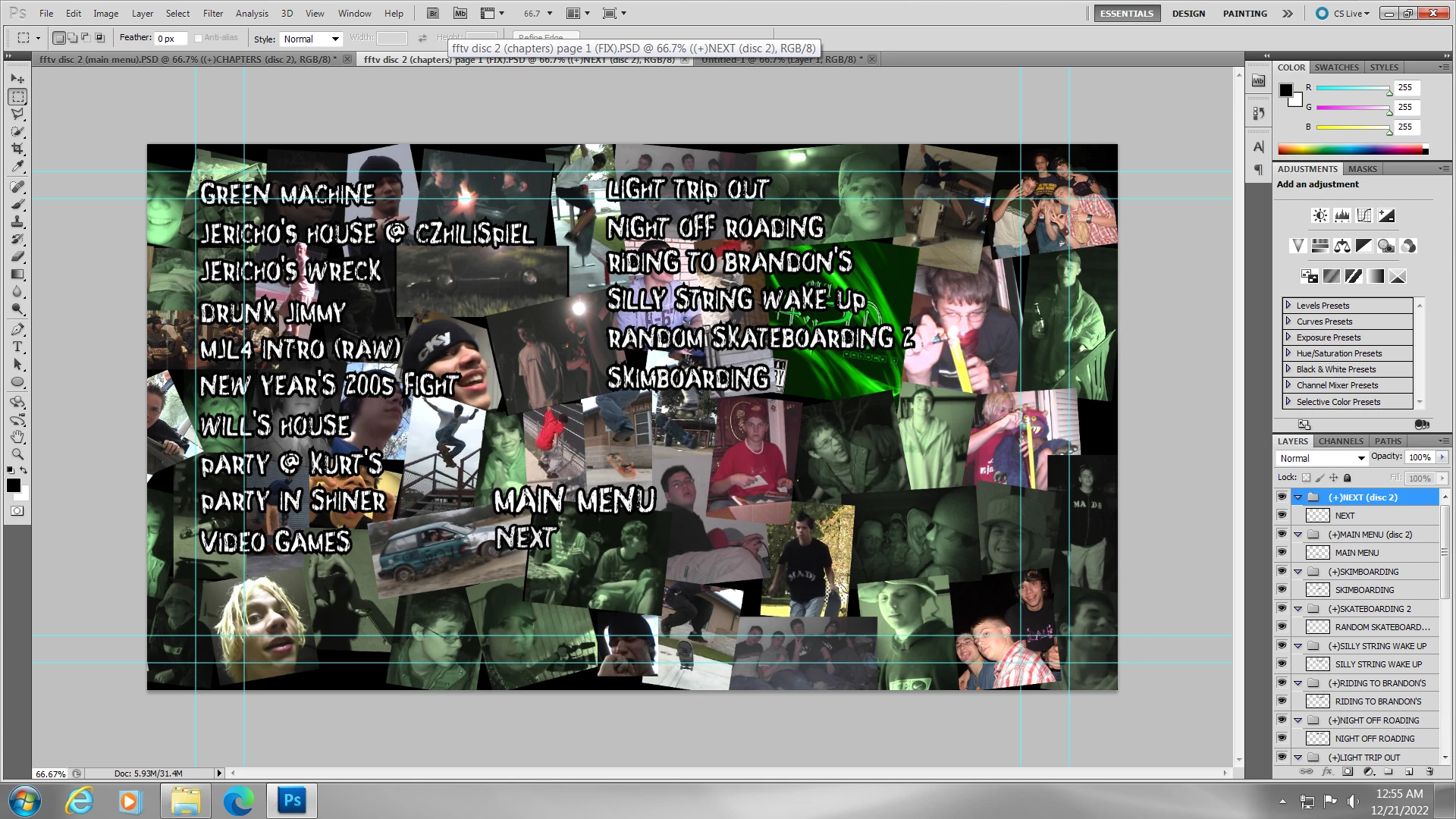

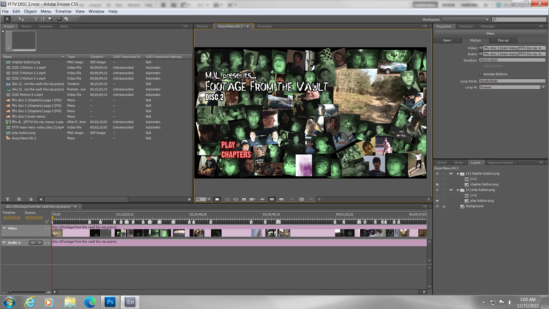

Picture 1 is just the main menu in Photoshop with its layers. What's supposed to happen when you click "Chapters" is the whole image (including the text) shifts to the left and brings in the first page of chapters (which is Picture 2).

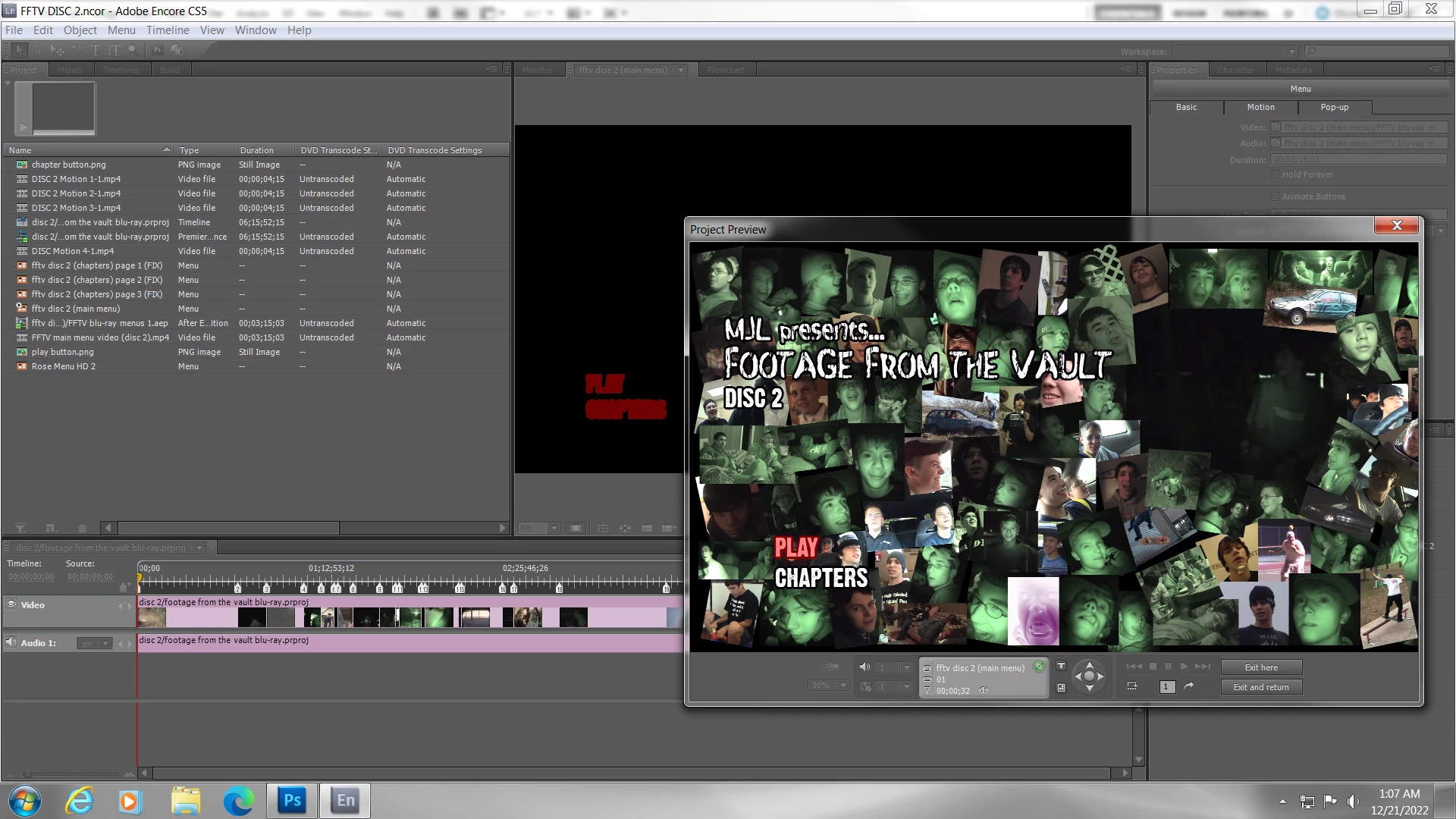

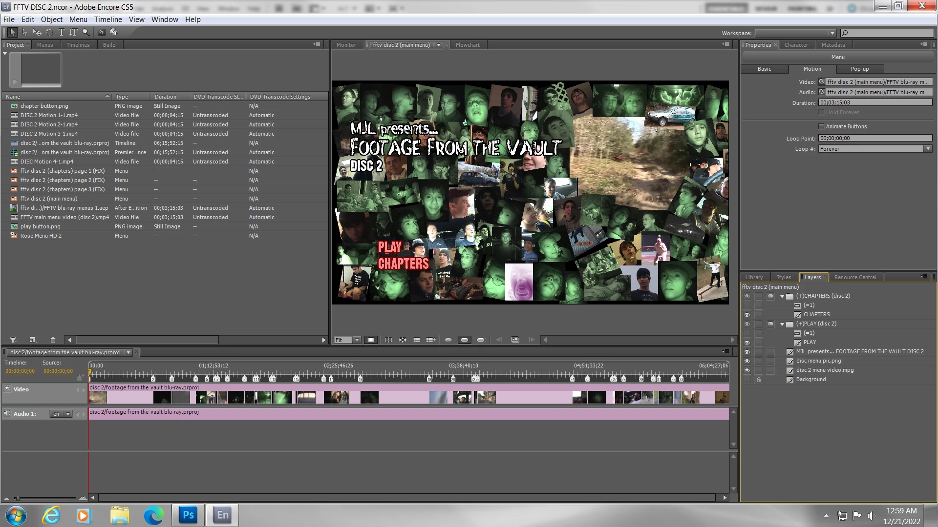

Picture 3 is the main menu from Photoshop with the button subpictures highlighted. As you can see in the top right that I have the motion video and audio selected. Now when I hide all the layers of the menu as it said in one of the YouTube tutorials that I watched, I get what's in Picture 4. And as you can see, the motion video and audio is still linked, but it doesn't pop up in the menu window with the buttons. Just a black screen. And that's how it's been burning to the BD-Rs that I have. However as you can see in Picture 7 when I preview the project, the linked motion video and audio appear in the previewed project, and it works fine. It's just not burning to the BD-Rs like that. Just the black screen with the highlighted subpictures of the buttons. And transition video from main motion menu to the first page of chapters works too.

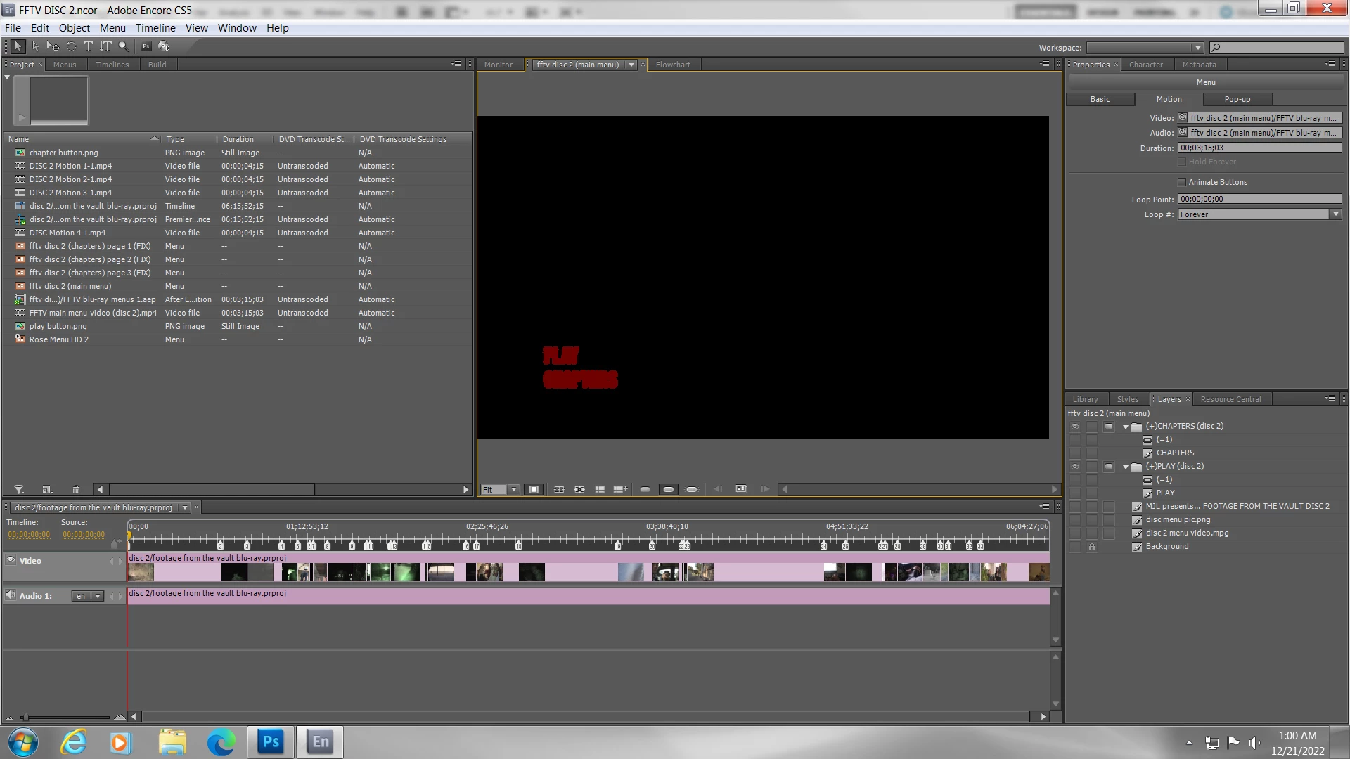

In Picture 5, I used a menu in the Encore Library (Rose Menu HD 2) and as you can see when I linked the motion video and audio, it pops up in the menu window as it's supposed to. I just deleted all the assets and buttons of the Rose Menu and made PNG files of the buttons "Play" and "Chapters", converted them into buttons and place them over the same text in the video. In Picture 6, you'll see that I selected the Chapters button and have the transition video linked. The video is the entire collage of pictures shifts from left to right and brings in the first page of chapters (i.e. Picture 1 & 2). This is where the transition doesn't work properly in the preview window. When I click "Chapters", it just starts the main menu motion video over and plays with no audio for the 4 seconds that the transition video is supposed to play, and then just jumps to the first page of chapters (i.e Picture 2).
