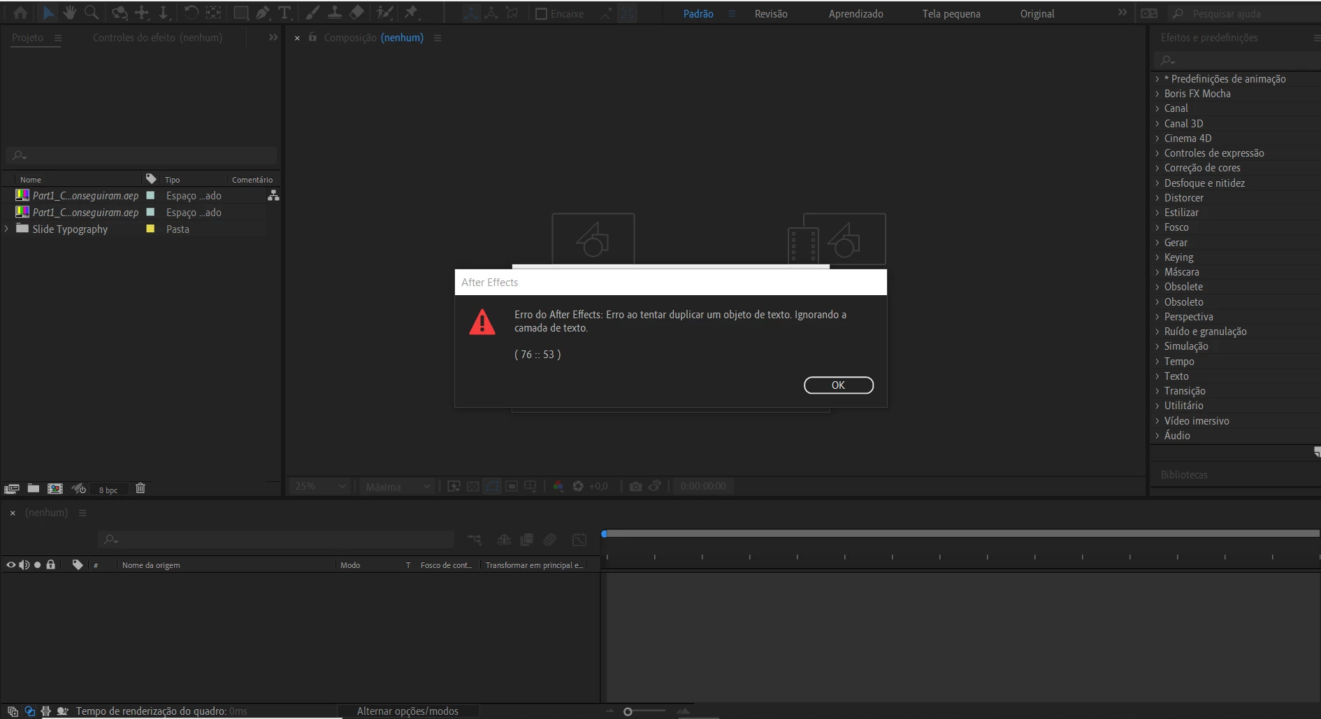

A specific project failed to open out of nowhere and display this error message. Has anyone experienced this and have any tips on how to resolve it?
Msg Error: "Error trying to duplicate a text object. Skipping the text layer."
Um projeto específico deixou de abrir do nada e apresentar essa mensagem de erro. Alguém já passou por isso e tem alguma dica de como resolver?
Msg Erro: " Erro ao tentar duplicar um objeto de texto. Ignorando a camda de texto."

Without any specific info about the project we can't tell you much. If it appears out of nowhere, it could well be that the project is genuinely damaged. Other than that the standard steps apply: Open the project with capslock enabled to prevent rtendering/ evaluation, check your language and font settings in AE and on your system. Perhaps it's just a fluke because you changed something or picked a font that doesn't support Unicode fully. Anything beyond that will require more info.
