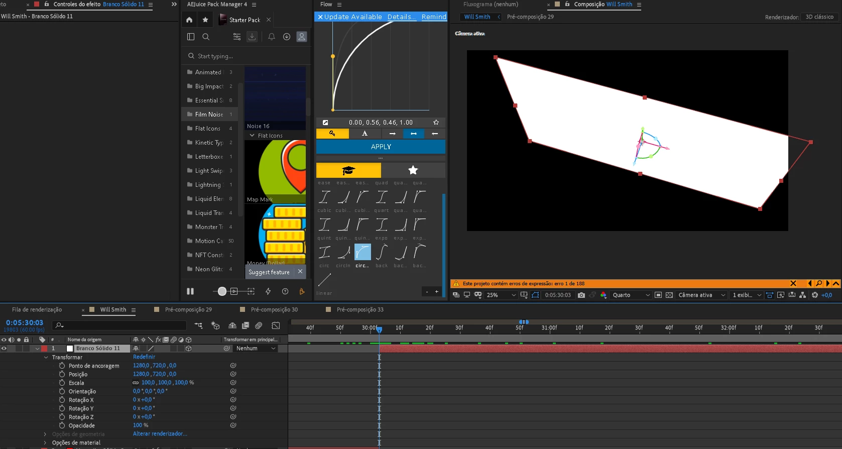

erro com 3d
I accidentally ended up enabling some function, where every layer with 3D enabled is as if there was a camera already ready, does anyone know how to solve it? As you can see in the image below, the solid layer only has 3D enabled, there is no camera, and I didn't even change the settings, but it was kind of sideways.

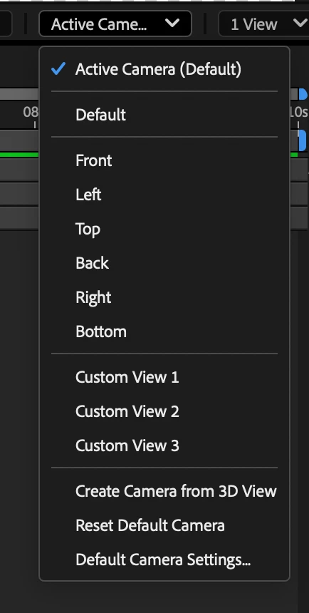

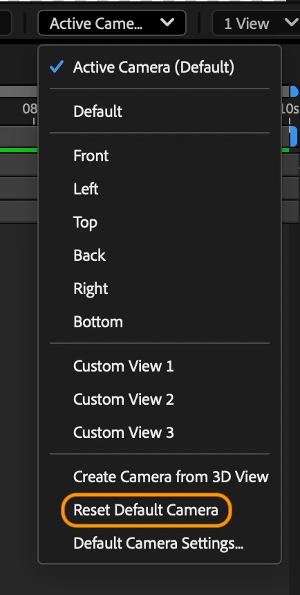

Hi @Otávio19136435r6xs,
AE has a default Active Camera that you can orbit or pan with. To reset this, click on the dropdown menu at the bottom of the Comp Window that says "Active Camera" You can then select "Reset Default Camera" and it should fix your issue.
Cheers,
Dacia
- Dacia Saenz, AE & PR Engineering Teams

Apr 30, 2024 7:43 PM UTC
Cheers,
Dacia

Apr 30, 2024 7:22 PM UTC
Cheers,
