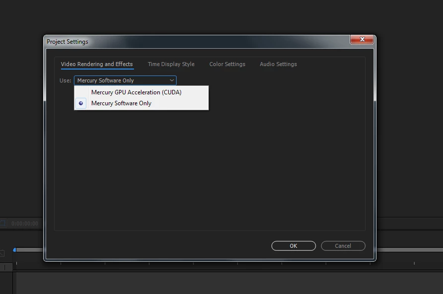

im already using "mercury software only" and this godammit message keep showing (

did you change this also to CPU?
July 12, 2019
Yes, everything is worth

So what i can understand from your picture, did you try to run as cpu only and you still have the same issue?
July 12, 2019
Yes, I tried as with the included GPU, and with the same problem, and with the CPU. All the same.
