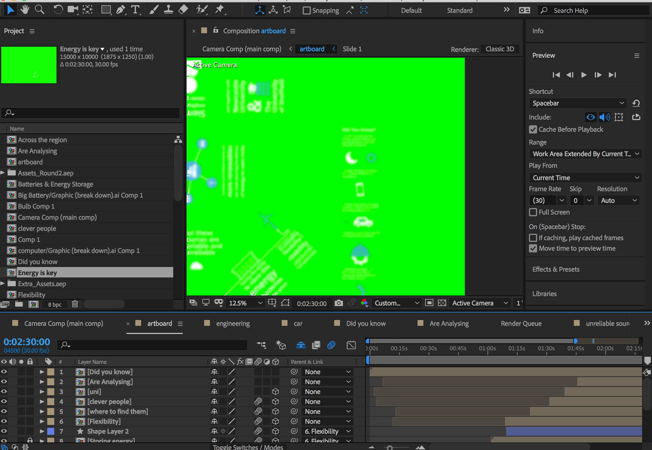

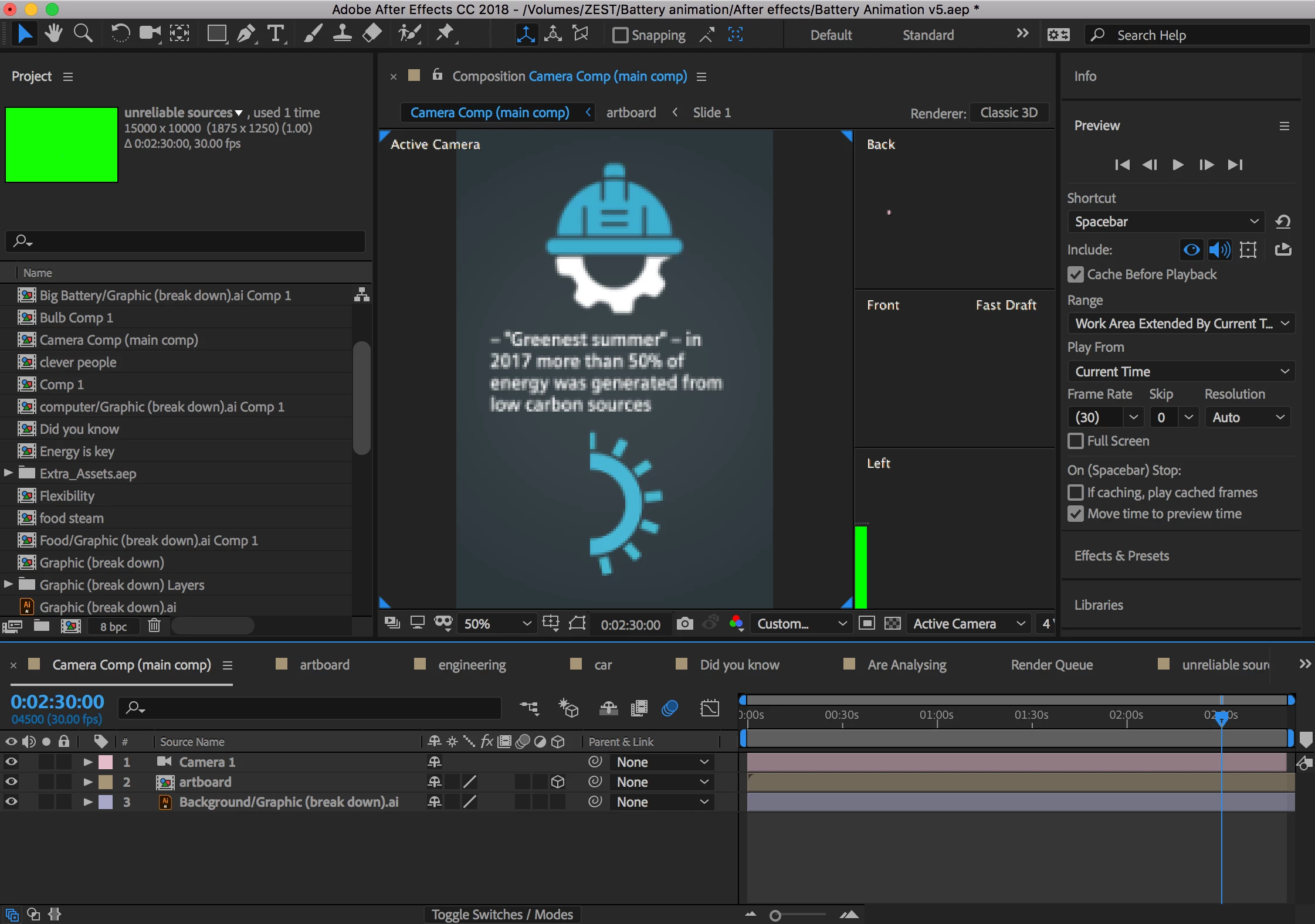

I am working on an urgent project which is an infographic style animation created in Aftereffects. This basically has most of the elements on a large board and then a camera layer that moves from one area to another. The various mini animations are created in their own compositions and the added to the composition called artboad (I'll attached a couple of screen grabs)
It seemed to fall down at a certain point - so I removed a composition (by trial and error) and that seems to do the trick, but now it is failing at another point.

The 'rendering at offset..' error message tells you the exact frame in the master comp that it can't build, but it doesn't say which layer or subcomp is causing the problem. Clearly in your case it's something inside "artboard" but beyond that you'll have to go digging. Clear all your caches, then if the AE monitor can display the frame and ram-preview through it reliably the source footage is likely to be OK and it's erring towards a throughput problem. As Kyle says, sometimes the best option is to sneak past the error by rendering out intensive subcomps to a more easily readable format such as TIFF or ProRes - but since your 'artboard' is so gargantuan that's not a realistic option. 15000x10000 pixels is.... yeah...

I got the video rendered in the end pretty much as you described. For some reason there was a comp it didn’t like on the art board. I copied the comp, renamed it and deleted the old one. That seemed to do the trick. Strange.
The artboard is indeed pretty big. We are zooming out to reveal the whole board and then zooming in to specific areas, a bit like Prezi. Happy to take ideas if there is a better way of doing it. The actual video rendered out is set at 1080 x 1920 (portrait).
